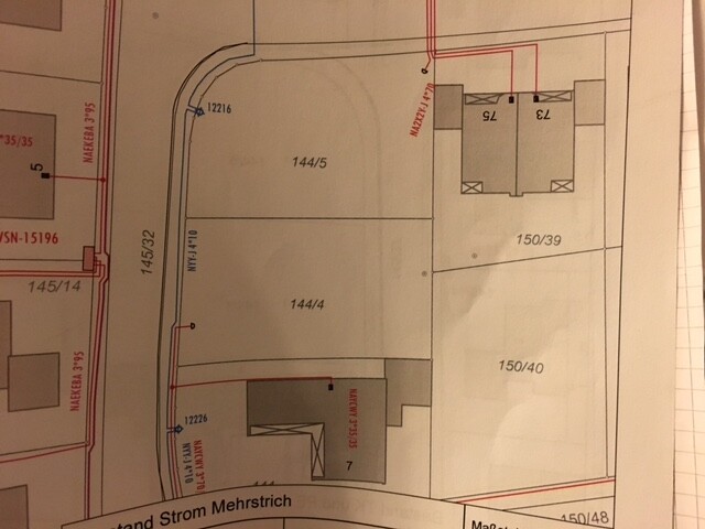

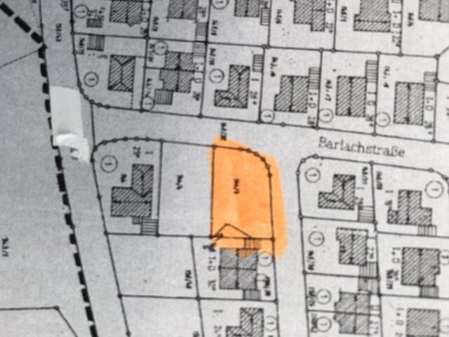

Attached is the location of the plot. North is at the top. Access is planned from this side as well. The middle plot will remain free, as mentioned. At the bottom is my parents’ house. The area is flat, with no slope.
Edit: Somehow I have the problem that the images rotate... In Image 1, the top is actually west and the right side is north. Sorry!
