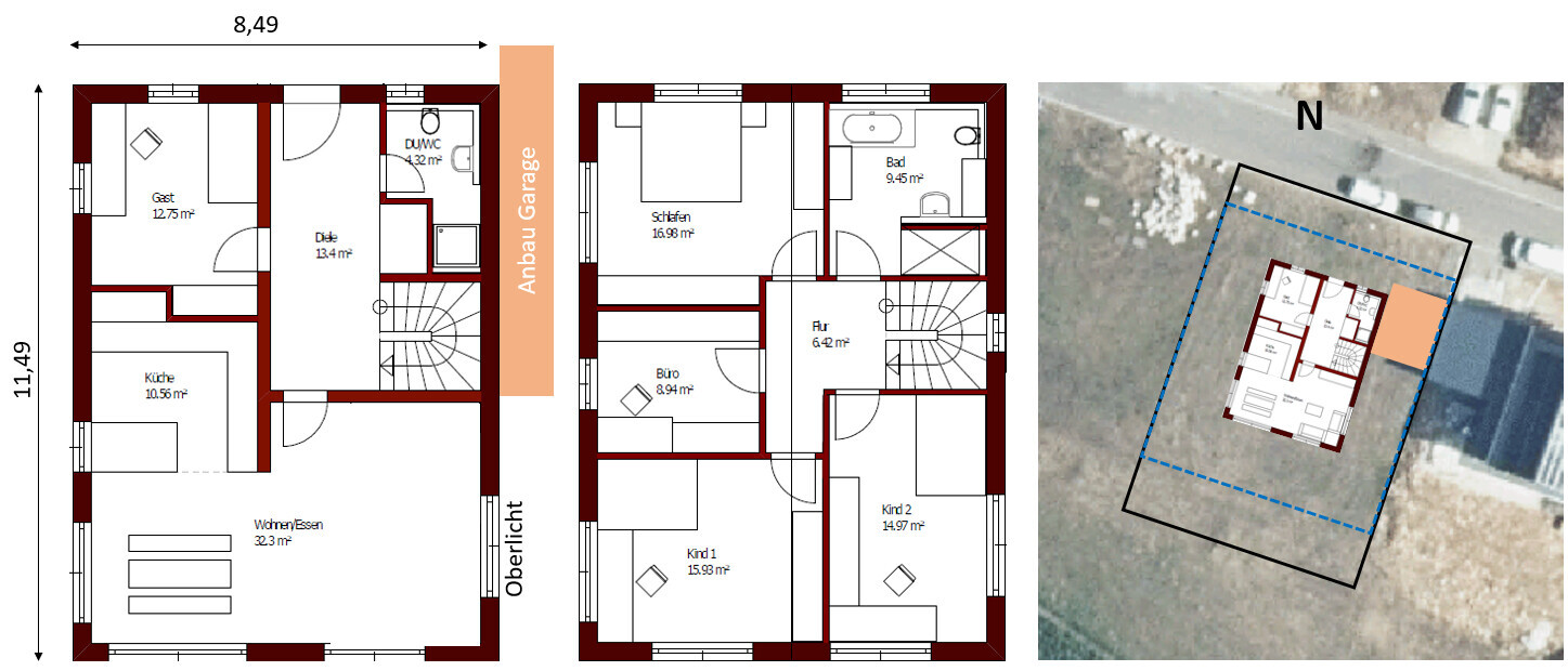

ᐅ Single-family home floor plan, 1.5 stories, 2 children's bedrooms, 2 offices – is the space usage optimal?
Created on: 4 Dec 2023 22:22
E
EFhaeusle
Plot size: 650 sqm (7000 sq ft)
Slope: East-West: 1.20 m (4 ft); North-South: 1.5 m (5 ft)
Floor area ratio: 0.4
Building envelope, building line and boundary, up to 3.5 m (11.5 ft) from the street
Edge development: East: double garage (approx. 5 m (16.5 ft) from the street)
Number of floors: 1.5, knee wall height: 2.20 m (7.2 ft)
Roof type: gable roof, 30°
Orientation: ridge line: north-south
Maximum heights / limits
Eaves height: 5.80 m (19 ft)
Basement: yes
Number of people, age: 4 middle-aged adults, 2 children
Office: family use or home office?: 1 home office, 1 multipurpose / hobby / reading room
Open kitchen, kitchen island: open L-shaped kitchen, i.e. no direct view to the living room
Garage, carport: double garage (east boundary)
Planner: designer from a construction company
What do you particularly like? Why? Room layout, extra office on the upper floor, kitchen recess, option for west-facing terrace
What do you dislike? Why? North-facing office window (due to symmetry), limited space in the living room, space/recess for cloakroom, staircase not in living area, children’s rooms and living areas with south-facing windows
Estimated cost according to architect / planner: ~450,000 € incl. basement, excluding garage and exterior landscaping
Preferred heating technology: air-water heat pump with underfloor heating
Basement: yes
What are BZH and mbH? Reference height? And mbH probably something like average_b_height 😉

EFhaeusle7 Dec 2023 22:22ypg schrieb:
Reference height? And mbH probably something like average_b_height 😉BZH: Reference height and mbH: with limited heightE

Dimensions of the plot are also nice.We are still waiting for the surveyor. The plot is approximately 22m (72 feet) east-west and 30m (98 feet) north-south.EFhaeusle schrieb:
BZH: Reference height and mbH: with limited height... and I’m no wiser than before: is a reference height (usually given in meters above sea level) specified for each plot?; "limited heights" usually refer to townhouses and detached houses where specified (the maximum is exactly what might be indicated).https://www.instagram.com/11antgmxde/

EFhaeusle8 Dec 2023 09:5811ant schrieb:
... and I’m still as smart as before: is a reference elevation (usually in meters above sea level) provided for each plot?; "limited heights" are regular for townhouses and detached houses, if specified (the maximum height is exactly what is provided, if applicable).Yes, the reference elevation is given for each plot. In this case, at 663.25m (2176 ft) above sea level (+/- 0.25m (1 ft)).
