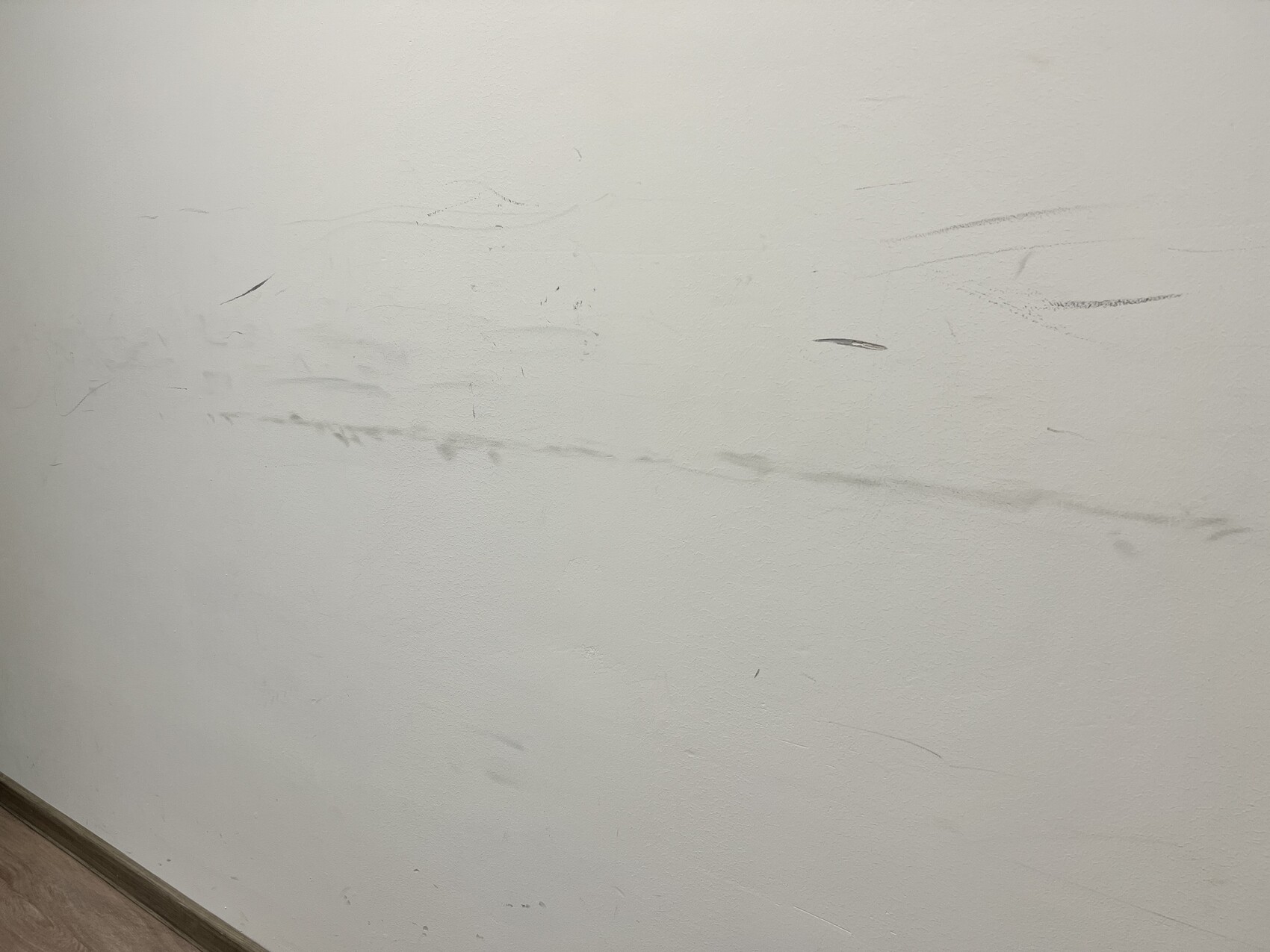

There’s no point in glorifying something that can’t be implemented. If the space is there, you can do it. But here, either a narrow, bare mudroom about one meter wide (3 feet) or making the office open to the hallway—neither adds comfort to the house or its occupants.
Regarding the one-meter width: shopping baskets, bags... you don’t hold things carefully close to your body, they extend your effective reach. This is what it looks like then:
White wall with visible scratches and scuffs; baseboard at the bottom edge.
