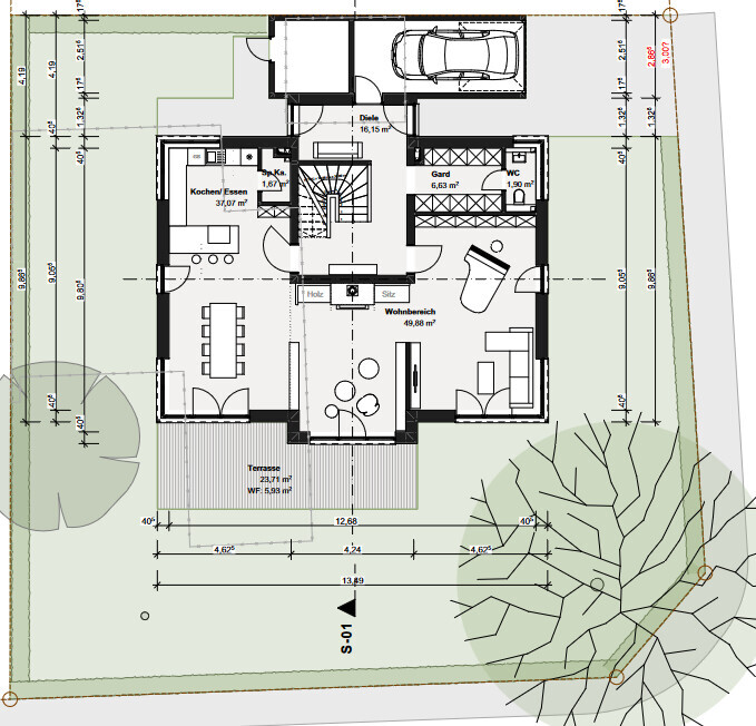

Hello House Building Forum,
After several months and iterations, we have a design for our single-family home and are quite satisfied. Now we are very eager to receive your constructive feedback! Thank you in advance.

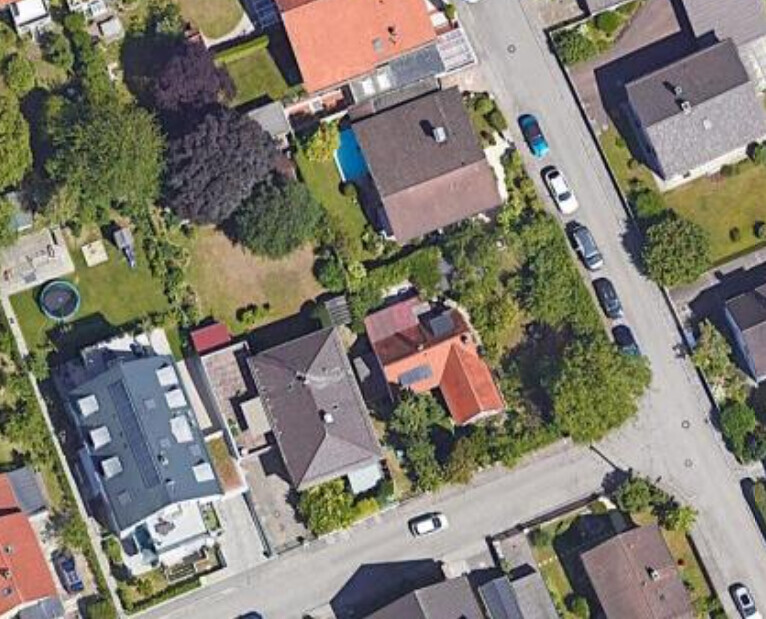

- Especially ideas for the exterior: We want to build a “beautiful house” from the outside, not just a functional one.
- How best to calculate sun position/shadow cast from neighboring houses?
- Do you see any major no-gos including reasons and suggestions?

I just noticed that there is nothing planned for sun or possibly wind protection on your terrace. Maybe your trees are already tall enough. If not, I would definitely consider adding that during construction. Portable sunshades can be really annoying, and no one wants to sit in direct sunlight. You might also need drilling, wiring, or foundations for that. You won’t want to deal with that later, especially given the costs involved. We have a recess and an awning — great for wind and sun.Good points — we haven’t really thought through the outdoor situation properly yet, apart from a rough idea of a sail attached to the house wall. I’ve noted down the detailing of roofing, lighting, and motion sensors for our next architect meeting. Wind is less of an issue in our case due to the tree cover and the neighboring building. As mentioned, we dropped the idea of a framed outdoor kitchen because of cost, but the necessary connections will be planned.

Solid plan. Just a few minor points, which are not mandatory:
- The kitchen door blocks or at least significantly narrows the walking path if the cabinets stay as planned. This bottleneck could become annoying over time.
- Many cabinets are custom-drawn by the architect with very different depths. Are these all custom-built? If not, finding matching standard furniture brands could be quite complicated. For example, the room divider in the living room needs a real back panel, which can look odd. I would check all these depths carefully to see if the furniture you want would fit.
- I would also soundproof or reinforce the wall between the bedroom and the children’s room. The route to the bed is uncomfortably long. I’d probably move the door forward (to the children’s room side). Also, it shouldn’t be a sliding door.
- Is the hobby room in the basement really planned as a guest bedroom? Has that been thought through? What kind of window will be installed there?
Otherwise, congratulations — I think it will be very nice. 🙂Kitchen door: Good point, added to the list.
Cabinets: We are aware of that too. We’d like to temporarily use some existing furniture and possibly have some custom-made later, so that point is definitely valid.
Walls on the upper floor will still be revised. From my perspective, all upper floor walls should be soundproofed — we are a household with musicians! 🙂
The basement has not been fully thought out yet. Ideally, we want those angled light wells that really brighten the basement in the guest and hobby rooms. We might even combine those two rooms and install a wall bed. That way, the bathroom is closer to the guest bed, the whole space gets daylight, and without guests, it’s a larger hobby room.
...also, I find the centrally positioned door to the open-plan room rather awkward and dull. Double doors can either loosen up a room or look traditional. Here I see the latter and would prefer a 1/3 to 2/3 door arrangement in the hallway that allows room for a sideboard or picture wall. Also, for the 9sqm (100sq ft) office, you should stick with one door — whichever best fits your lifestyle.
In the guest WC, I would swap the washbasin and toilet.Thank you! The double door was actually added last; previously, there was a continuous wall there. I’ll upload an earlier draft as well. The hallway-to-closet-door situation still doesn’t feel right to me. Maybe we will have to enlarge the entrance area again, even though we had decided against it before.
Overall, I’m impressed with how deeply you are engaging with our floor plans. Many thanks for that — it’s enjoyable! And more suggestions are very welcome! 🙂

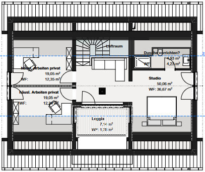

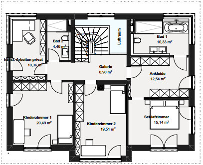

P.S.: I would like to renew my invitation for @fabreit to share not only the final but also the initial design.I’m finally getting around to responding to your invitations. Below is a draft version from March. At that stage, we still had an additional floor, so the house was larger (almost encroaching on the garden), and we still included the bay window on the north side, which made the hallway area somewhat more spacious.
The main points of criticism included:
- We can’t afford this house
- The garden will be too small
- We don’t need that much space
- There is no optional retreat area on the ground floor
- The pantry in this form is useless
hanghaus202319 Jun 2023 13:29The natural lighting in the entrance area was significantly better in the previous design (door and window on the ground floor and an open space above with large windows on the upper floor). Therefore, my suggestion includes an additional window in the cloakroom and a transom window in the carport. This doesn’t fully compensate, but it’s better than nothing.
Alternatively, at least a frosted glass door in the bathroom?
hanghaus202319 Jun 2023 13:37Is there a specific reason why the house is no longer being built parallel to the north/west property boundaries?
hanghaus2023 schrieb:
Is there a specific reason why the house is no longer being built parallel to the north / west property lines?A few pros and cons, for example garden size on the southeast side and an "evening sun terrace" in the northwest corner, but it’s still flexible. Both options exist in the neighborhood, see below. What would you recommend?
As shown in the satellite image, the planned south-facing terrace will get little sun in the evening. What tools would you use to create an accurate simulation of sun positions throughout the year? The house’s position on the lot could strongly depend on this.
