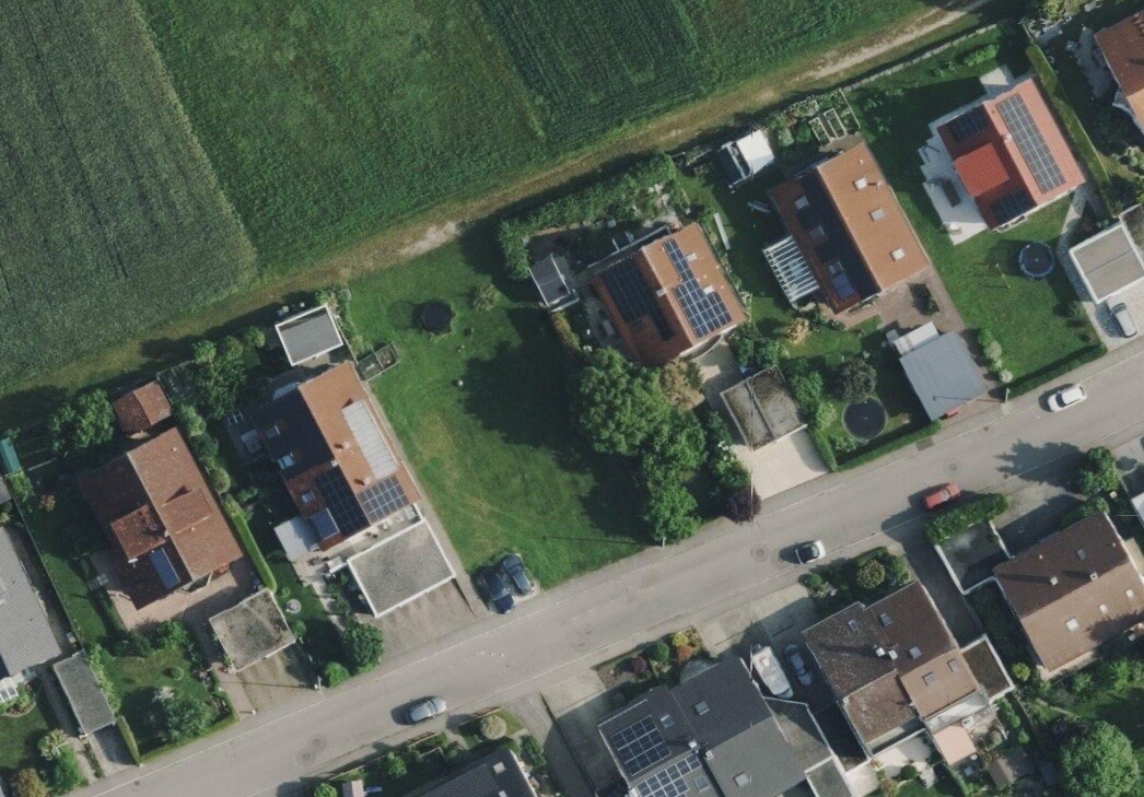

hanghaus2023 schrieb:
When I analyze the contour lines, I get about a 1.6m (5.2 ft) difference in elevation. That shouldn’t be a problem with a basement.
Which plot is it exactly?
How high have the neighbors built? Did they also use the entire building plot? Please show a section with an aerial view.It is number 21.
On the left is a semi-detached house that fully utilizes the building plot (garage shifted). On the right, the detached house does not use the entire building plot.
