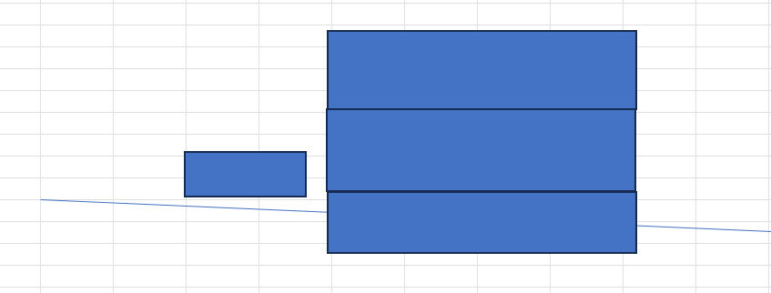

When I analyze the contour lines, I find a height difference of about 1.6 meters (5.25 feet). That shouldn’t be any worse with a basement.
Which plot of land is it?
How high have the neighbors built? Did they also make full use of the building envelope / building boundary? Please show a section with an aerial view.
hanghaus2023
16 Nov 2025 13:14
I have illustrated this in a cross-section.
Blue bar chart with stacked bars on the right and a small bar on the left
This is the maximum allowed by the building permit / planning permission.
