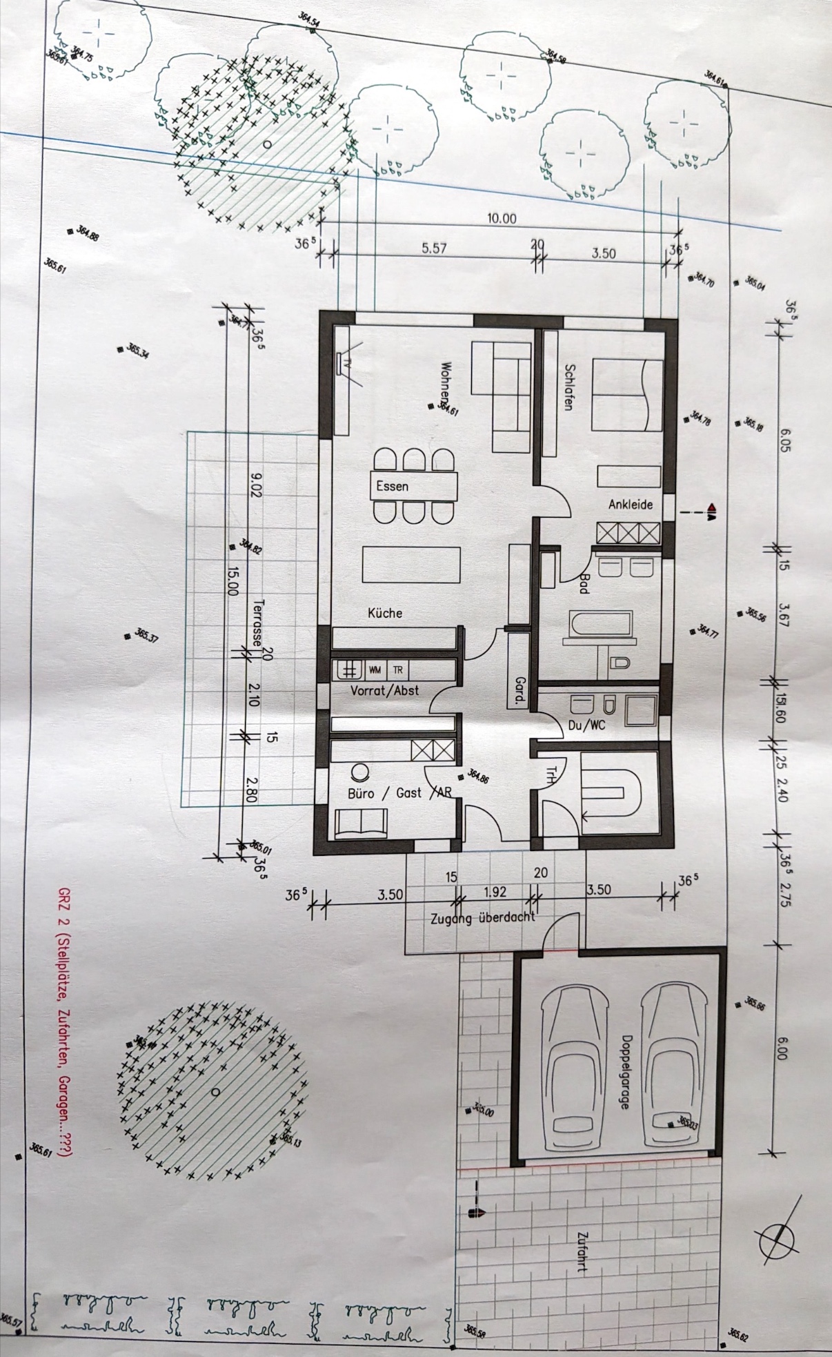

As our planned construction project is gradually taking shape, I would like to share a first draft for discussion.
The plot is already secured, and we want to make full use of the space to maximize potential living area. Retirement is foreseeable for both of us, but after 28 years, we still want to build once more.
Our eldest daughter has made us grandparents twice over, and we often enjoy having the grandchildren stay during the day so their mother can go to work. Our younger daughter will be studying for about four more years and is planned to have her own space in the basement, which could later be converted into a guest room, office, etc. The plan includes a separate entrance via a generous lightwell, but with access to the ground floor (maximum of two living units).
The attic is not intended to be finished right away but will be designed for potential future development. Whether this will ever be implemented remains uncertain.
The ground floor should offer approximately 125 sqm (1,345 sq ft) within a 10x15m (33x49 ft) building envelope. The open kitchen/dining/living area should accommodate many guests, as we frequently host large family gatherings and groups of friends. The bathroom should be en suite, and the guest toilet should include a shower. A multipurpose room is planned as a utility/laundry room with direct access to the garden, serving as a mudroom with an integrated sink and/or washing machine. In emergencies, this room can also serve as a guest bedroom. This will be less necessary once the basement is available.
The ground floor is optimized for a couple without children but should also work well for families without needing to use the attic. The attic is designed to function as a fully independent living unit, which we consider important for maintaining property value.
Families with young children could use the utility room as a children's bedroom, while older children could occupy two bedrooms with a bathroom in the basement.
Our main request is constructive feedback on the draft. We like the ground floor layout so far but are open to improvements.
We haven’t spent much time on the attic plan yet; we find the concept acceptable for now. We do like the idea of accessing the attic via an external staircase, ensuring completely separate entrances for the attic and ground floor. If more information is needed, I am happy to provide it.

Clear floor plan of a house with kitchen, dining room, living room, bedroom, bathroom.
Floor plan of a house with several rooms, bathroom, kitchen, hallway and hobby room, clear room layout.

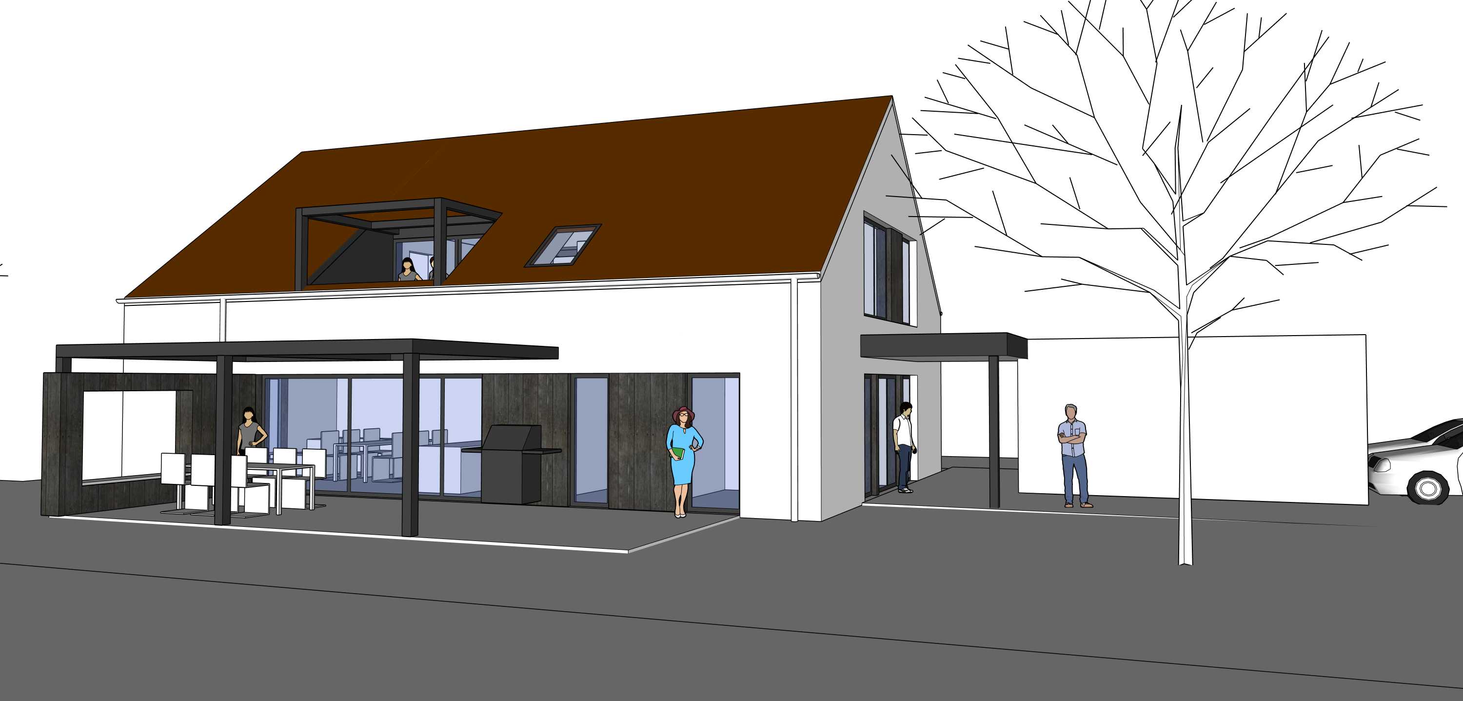

3D floor plan of living and dining area with kitchen, bedrooms, bathroom and terrace

@Nida35a It’s about time you finally organize the sauna festival you’ve promised so often in the forum. I would bring the pretzel sticks for it.
I still really like this basic concept of a house for two people, and the individual details can of course be adapted for everyone.

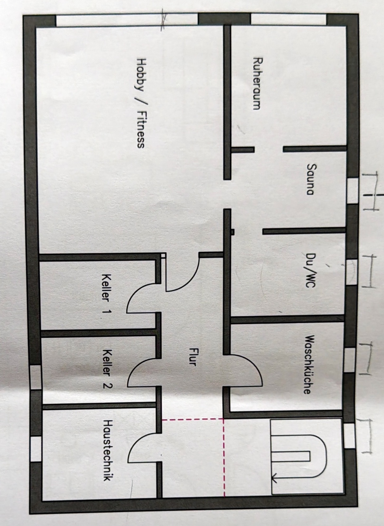

Why don’t we have a basement?
The heat pump doesn’t require storage for wood or oil.
The washing machine is located on the upper floor near the bedrooms. My husband didn’t want laundry running back and forth all the time. We also don’t need miles of clotheslines.
I no longer keep cider barrels. I don’t store trailers full of potatoes or stockpile preserved vegetables and fruits for months.
I want the sauna in a stylish bathroom with a window view.
We don’t need a party room. Celebrations take place in the garden or the living areas.
The attic provides plenty of storage space. The slot car track, Gravitrax, and air track mat also fit there.
With a basement, we wouldn’t have a level access to the garden. Our ground floor is fully wheelchair accessible.
And the basement would have been expensive. The slope should stay where it is. Just the costs for retaining walls and soil classes 5 to 6 wouldn’t make it cheaper.
Regarding the living spaces: We’ve had an apartment in a basement and one in an attic. I prefer looking up at the sky rather than down at feet. Living is comfortable in both.
By the way, there are timber frame builders who include a living basement made of masonry in their designs.

Anyone who hasn’t built in recent years is likely to underestimate how expensive basements have become. Partially basements hardly pay off anymore.
What makes basements so expensive?
On one hand, the actual construction costs: for usable basements, you can roughly estimate 1000€/m² (about 93$/ft²). (Partial basements are even more expensive because the real costs for usable basements don’t scale linearly.) When finished, the costs can exceed 3000€/m² (about 280$/ft²).
Then there are the earthworks. Labor costs for excavation. Potentially, if groundwater is an issue, significantly increased construction costs. And where do you put all the excavated soil?
Last year, we requested several offers. Simply disposing of the soil would have cost over €30,000 (about $33,000) for a basement at our place (with topsoil layer soil). That’s not including the excavation labor costs. And at this point, no basement walls have been installed nor any special measures due to groundwater or rain.
In the end, total basement costs (including earthworks, disposal, and related expenses) for a smaller house exceeded €150,000 (about $165,000) for a usable basement — and this assumes favorable conditions such as "no groundwater, no water issues." If finished as a living basement, it would have been about three-quarters as expensive as the whole house including slab and earthworks currently is.
I suspect this is why there is such broad rejection of basements here.

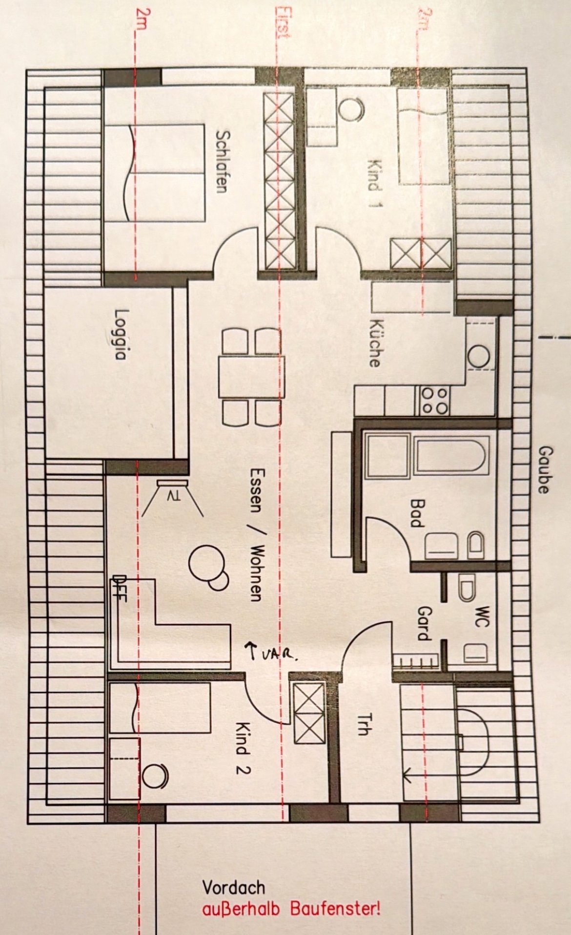

after a longer break to think things over, we have resumed the project and made some initial decisions.
The plan now is to build a house with two separate units.
The ground floor is still intended for a couple in their late 50s, while an apartment for their adult daughter is planned on the upper floor.
The design is mostly complete, but there is still one decision to make regarding the upper floor, and I’m interested in the forum’s opinion.
We are uncertain whether to keep the loggia as it is or convert it into a balcony (the local development plan / building permit is a bit unclear).
An alternative would be to extend the porch into a balcony with access through Child 2’s room.
Child 2 could be fully included in the living room (with the option to install a partition wall later if needed).
