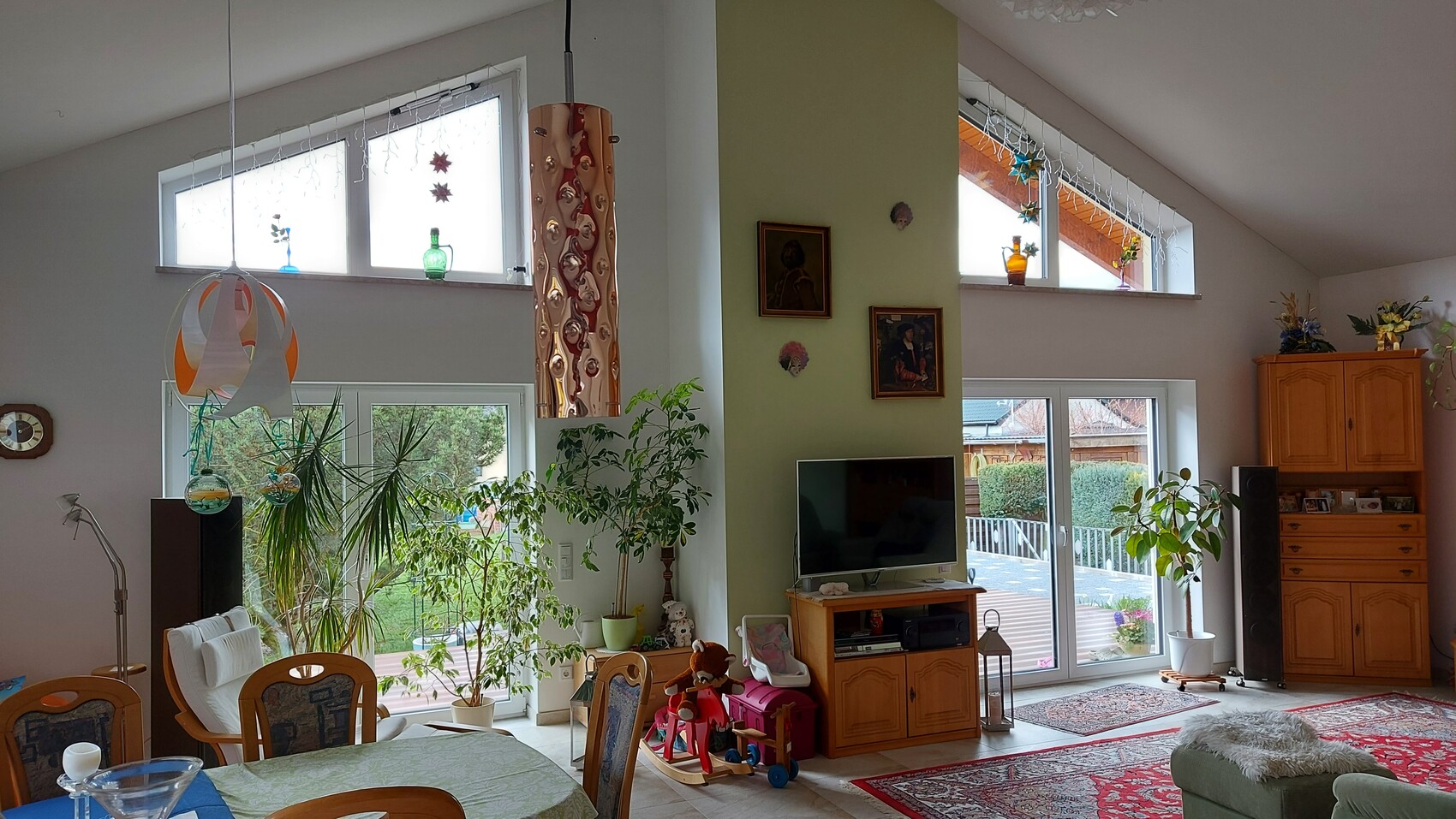

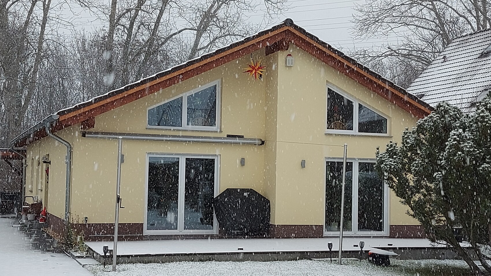

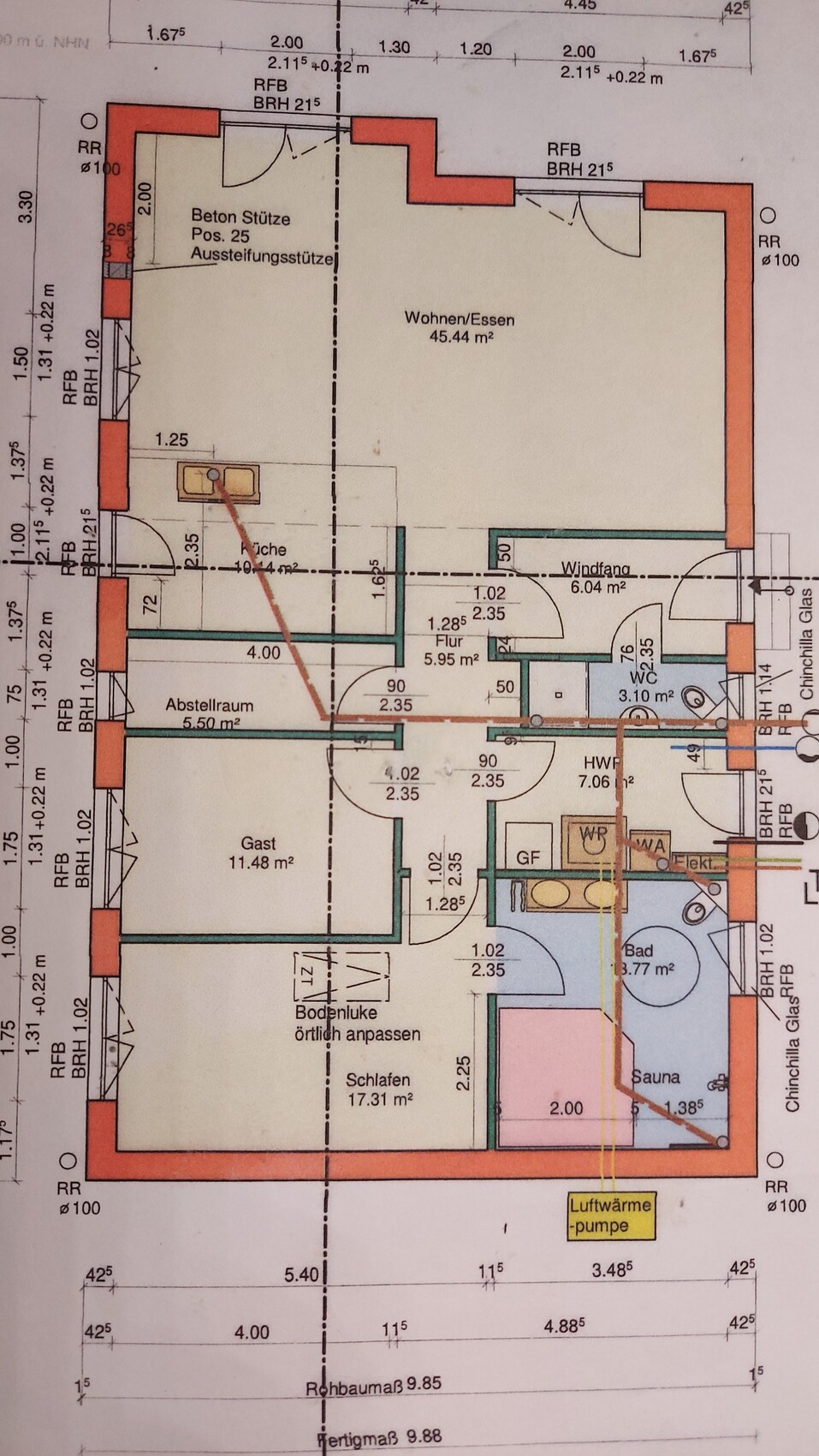

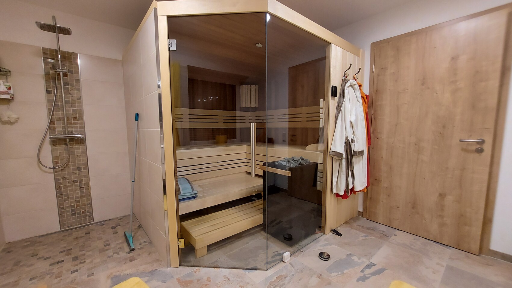

I’m sharing our house design: no basement, an open space, 3 rooms, with enough room for gatherings of up to 20 people.
