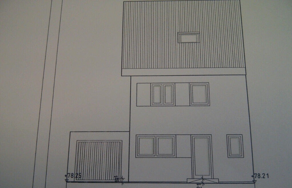

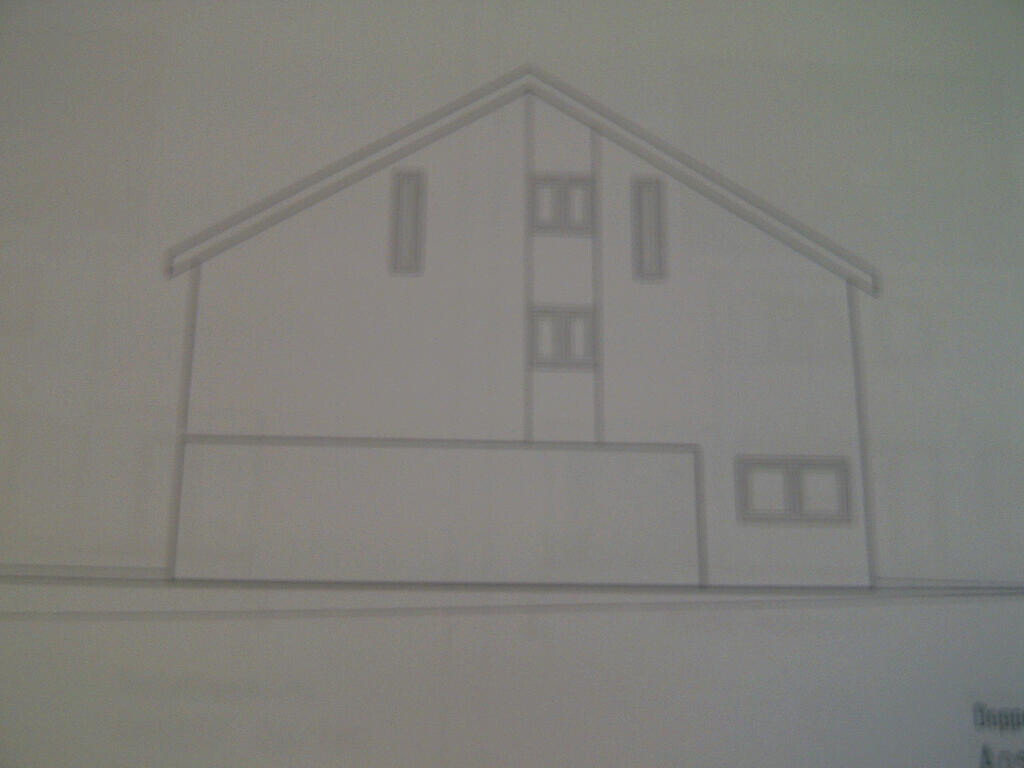

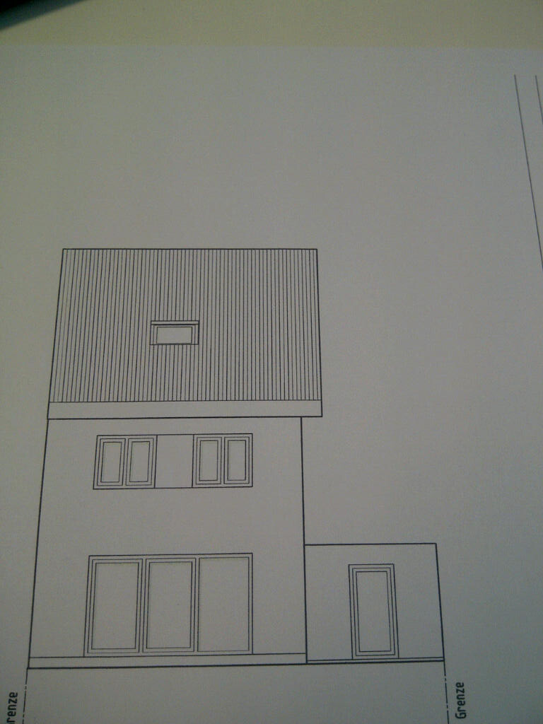

Here are the views
Simple architectural house view with roof, windows, and garage area as a drawing
Front view of a two-story house with garage and entrance
Exterior view of a modern two-story house with large windows and an extension.

Hello OliverZ,
Overall, I like the floor plan quite a bit.
I would just suggest considering the following points:
- Dining area:
With a width of only 2.48 m (8 feet), it is quite narrow. If the table is occupied on both sides, it will be difficult to pass by. I would skip the partition wall and integrate the hallway into the living and dining area. This will give you much more space, not only visually. Then consider rotating the staircase so that instead of leading down to the basement, it leads up to the bedrooms within the living area.
- Cloakroom / WC:
I would swap these two rooms – I find a window in the WC much more important.
- Bedroom:
I agree with Jaydee’s opinion here. The master bedroom with dressing area and bathroom is definitely better suited under the roof. It offers much more privacy for you and your children. Just imagine when the kids are older and come home at night—they’d have to pass by your room first. If they want to shower, for example, your rest might be disturbed...

23 May 2014 13:14
Dirk, I think the idea of swapping the floors is good, I just don’t know how we can fit everything upstairs.
