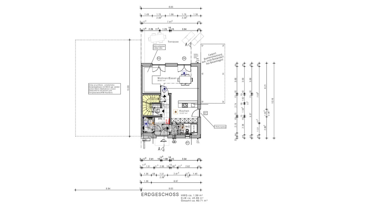

we have a plot of land adjoining a neighboring house, where we plan to build a semi-detached house.
I am currently focusing on the bathrooms and would appreciate any feedback. I have explained the specific questions further below. In the attached floor plans, the latest changes are shown in red, which is why there is a gap in the upper floor where the old bathtub used to be.

Space requirements on ground floor: dining/living/kitchen, utility room, guest bathroom, cloakroom

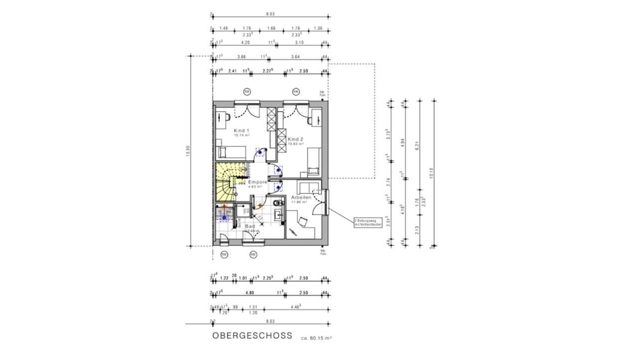

Upper floor (1st floor): 2 children’s bedrooms, office 1, bathroom plus laundry room

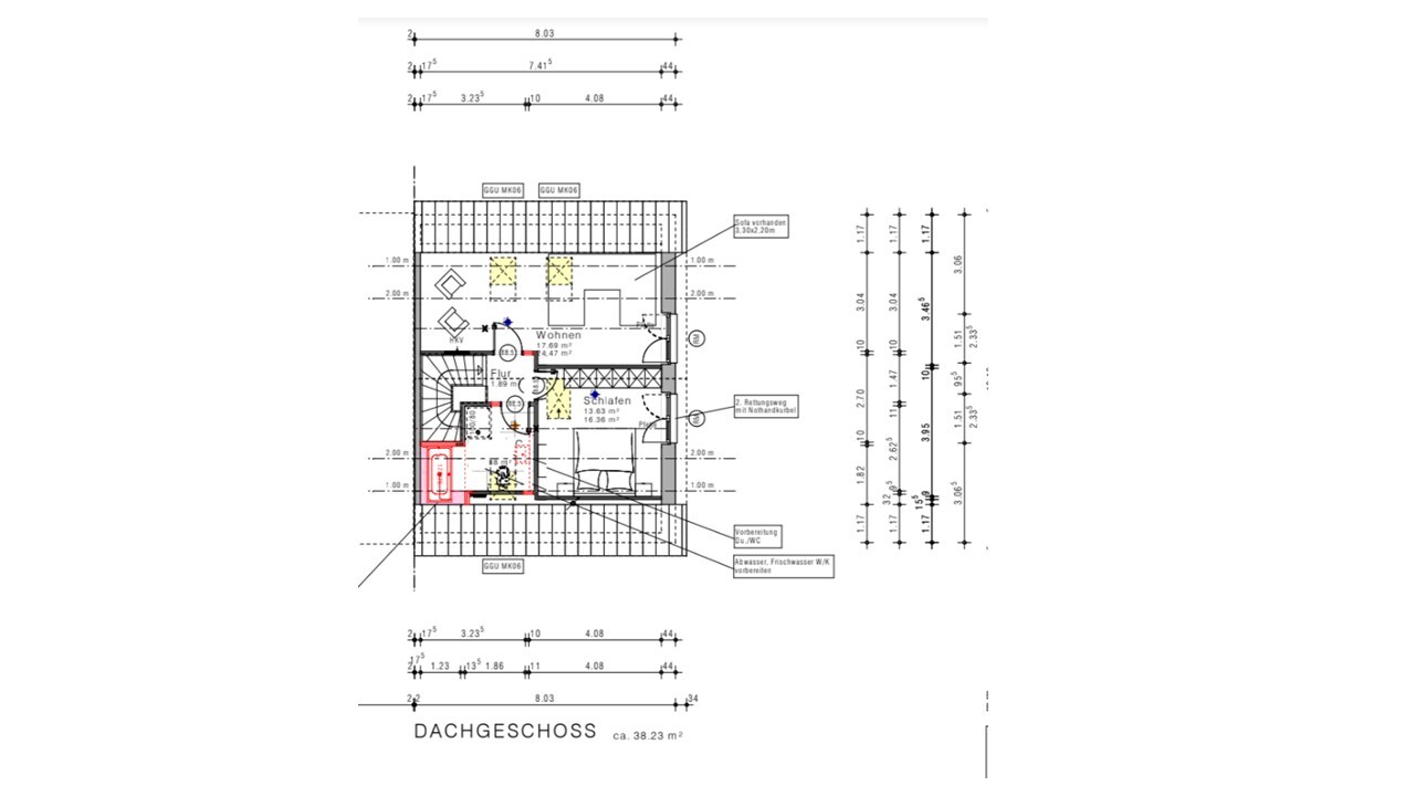

Attic floor: master bedroom, bathroom, office 2/guest room/second living area

Implementation of the ground floor, equally sized children’s rooms, the attic floor is also okay. -> Comments still welcome.
What don’t you like? Why?
The bathrooms on the upper and attic floors are still a work in progress.

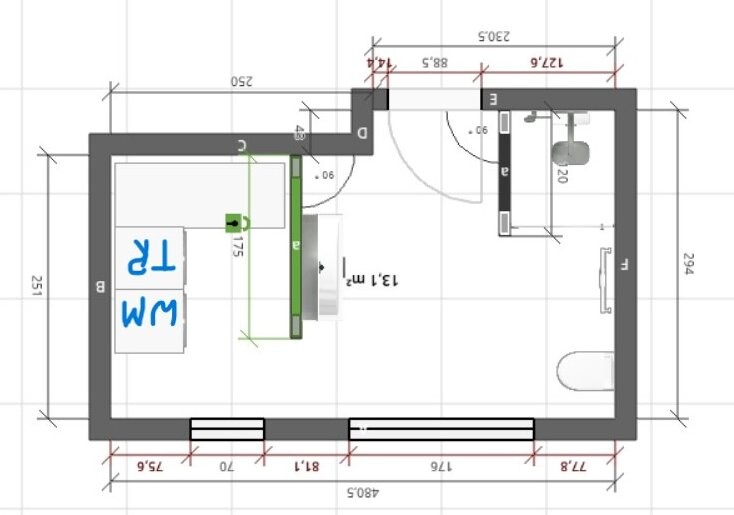

Laundry should be done on the upper floor, so a laundry area with privacy connected to the main bathroom is desired. Washer/dryer should be elevated, so preferably not placed under a window.
Several drafts have been made with passages at top and bottom of the plan. Current idea: move the bathtub to the attic floor, and use the gained space to widen the laundry room to 1.6m (5.2 ft) to allow some storage.
A separate DIY sketch from me is attached (without technical elements/pipes etc.).
In the attic floor the bathtub is planned under the sloped ceiling. Does this work from a spatial design perspective? Any other ideas for arranging the sanitary fixtures? Would you build the shower as drywall with a glass door or fully as a glass enclosure (more light but more cleaning)?

Floor plan of a small room: door top, two windows bottom, bed left, desk right.
Ground floor plan of a house with kitchen, living room and terrace
Upper floor plan of a house with rooms, stairs and bathroom
Attic floor plan of a house with living room, bedroom and stairwell
