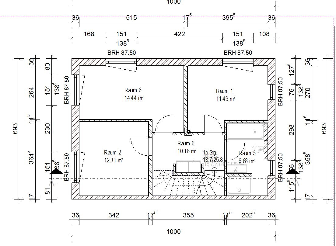

If I’m not mistaken, it would work if you move the staircase one meter to the right (from the plan view) and position the bottom of the stairs to the upper right, with the basement access to the left.
This way, the staircase would end up on the upper floor.
Consequently, the ground floor would have a larger living room but a smaller storage room.
On the first floor, both children's bedrooms would be on the left side (with the wall directly adjacent to the stairs), and the bathroom would need to extend slightly upwards. The upper right area could serve as a storage room or a workspace niche.
The remaining space between the stairs and the exterior wall would be open for flexible use (work area or sofa bed).
In the attic, it would be best to place the shower bathroom to the left next to the stairs, but I’m unsure about the pipework there.
This would need to be clarified in detail, as well as the arrangements for the other floors.

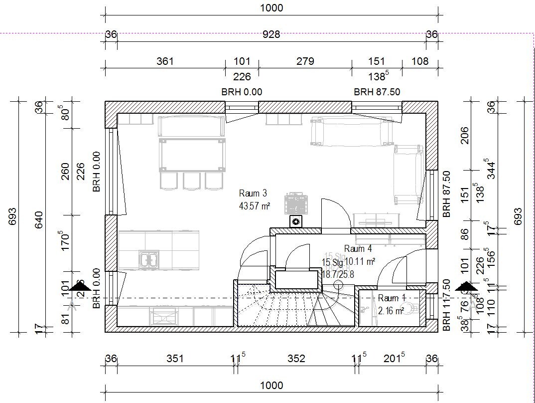

I couldn’t resist… now without a bay window, so no special permit required.
- Staircase with two quarter-turns
- Narrower hallway… I imagine an open coat rack where everything currently in use is stored, otherwise space in the basement for year-round jackets, shoes, hats, etc.
- Instead of a large storage room, a niche in the stairwell, either with a fitted cabinet or a slim drywall partition with a door, for vacuum cleaner, mop, toilet paper supply, etc.
- Dining/kitchen area now facing the garden/terrace, living area in a quieter zone, which also allows space for a fireplace that can be enjoyed from both the dining and living areas.
- Upstairs… the rooms may need slight rearrangement. Children’s rooms preferably to the left side of the plan, as this area likely has a southwest orientation.

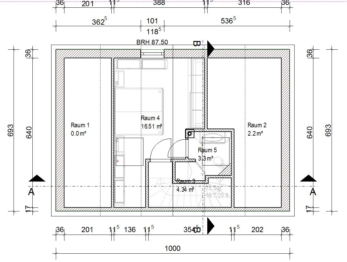

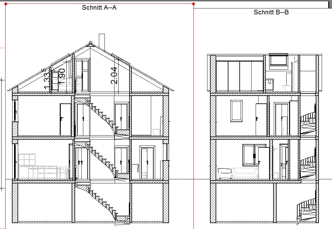

- In the attic, the master area includes a 250 cm (8 ft 2 in) wardrobe at 2 m (6 ft 6 in) height, otherwise dressers. Shower about 80 x 100 cm (31 x 39 inches) with a double-leaf shower door that can also open inward (to avoid drips, etc.). The toilet uses the height of the skylight, as does the standing space in front of the sink. A small platform in front of the door allows the door to be opened comfortably.
- In the attic, walls at knee wall height are about 130 cm (51 inches) high, because as can be seen quite well in the section, this gives a chance to get out of bed at a reasonably comfortable height. In the original plan, the 2 m (6 ft 6 in) line ran almost at the foot end of the bed:
