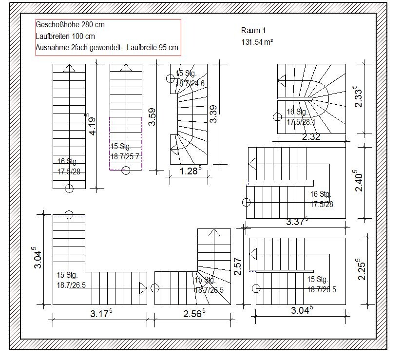

Somehow, I am not satisfied with the floor plan at all. I actually wanted the staircase access to be in the hallway, but now I see that this takes up a lot of space and the kitchen (which, by the way, lacks a window) seems relatively large. I would prefer to move the stairway a bit to the right and reduce the storage room. But this leads to our big problem: we would like to have a shower room in the attic. That is already hardly possible, and if the stairway moves even further right, there would barely be any space left... oh man, does anyone here have a solution?

Thanks first of all for the stair photos. It’s always helpful to visualize them. I believe that a 2/4 staircase will be very difficult due to space constraints.
