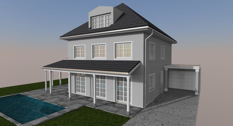

JuliaMünchen schrieb:
We are still in the middle of building, and I’m not quite sure yet if I want to fully share our house here when it’s finished. It’s mainly because our little house is like my baby, and on the other hand, this forum can be quite harsh when it comes to taste. One comment from a builder saying, “What’s with this style mix of a coffee mill house and an American house?” really annoyed me. Go ahead and share, it looks quite nice. Personally, I find that much better than being presented with a white, completely style-less box as “Bauhaus.”
We have changed the shape of the dormer. I would consider that in the photo more of a cross-gable roof dormer rather than a simple dormer.
