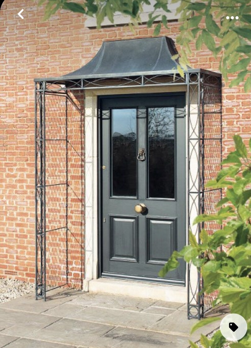

In this area, roof overhangs are uncommon, especially on the gable ends. Traditionally, the roof tiles meet the masonry flush at the gable and are plastered over. Because of that, new houses with roof overhangs here immediately stand out and are reminiscent of southern Germany... sort of like a Tuscan villa with Mediterranean roof tiles in northern Germany.
Oh, the canopy over the front door! That was quite a headache. I hoped the pediment would offer some protection. A proper portico with columns and a triangular roof was prohibited by the heritage preservation office because porticos are only found on princely buildings in this town. Also, a door pediment was never covered, as adding a roof afterward would ruin the appearance. As I wrote elsewhere: the house is a collection of compromises because design took priority over functionality, and we accepted adopting historically impractical features.
Myrna_Loy24 Sep 2021 16:53G
Georgian201924 Sep 2021 17:14Myrna_Loy schrieb:
But there are quite a few good roof coverings in the UK. Sorry, but that’s exactly what I wanted to avoid. The decorative door molding would no longer be visible. Historically and architecturally, stucco portals or tympana cannot be covered. The only option would have been to design the tympanum deeper, essentially as a small canopy. However, the plasterer could only offer a maximum depth matching ours. Beyond that, it would have become unaffordable.
