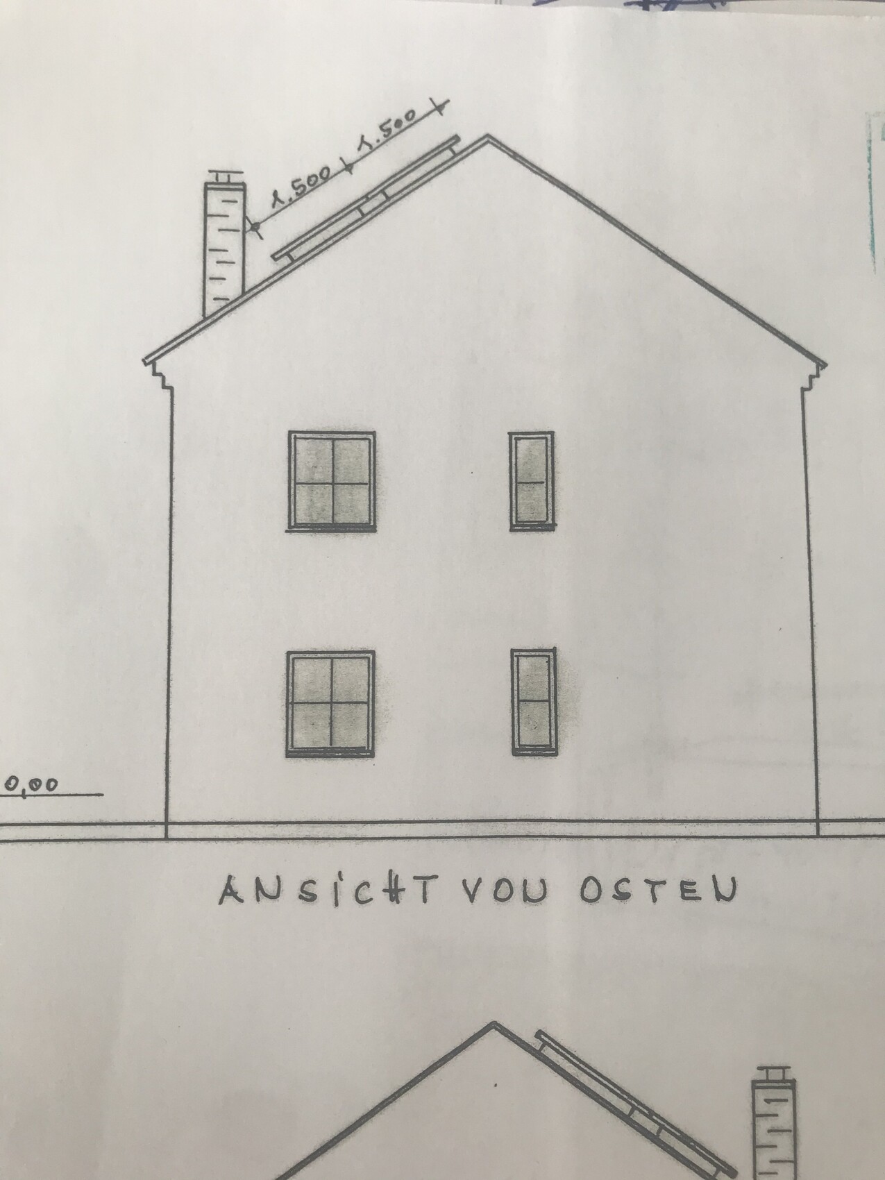

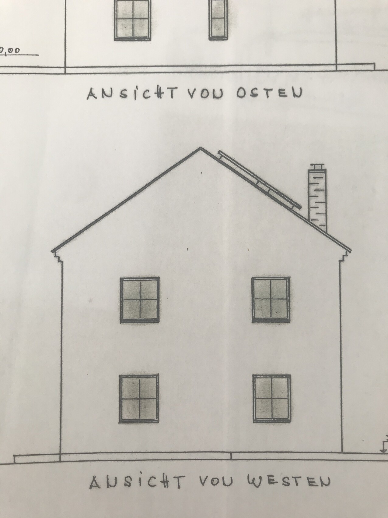

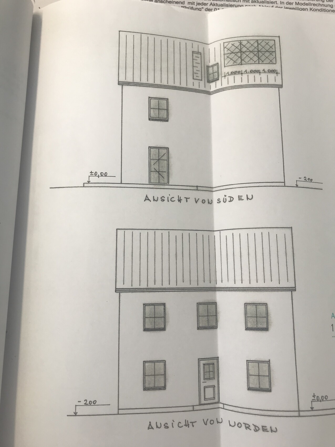

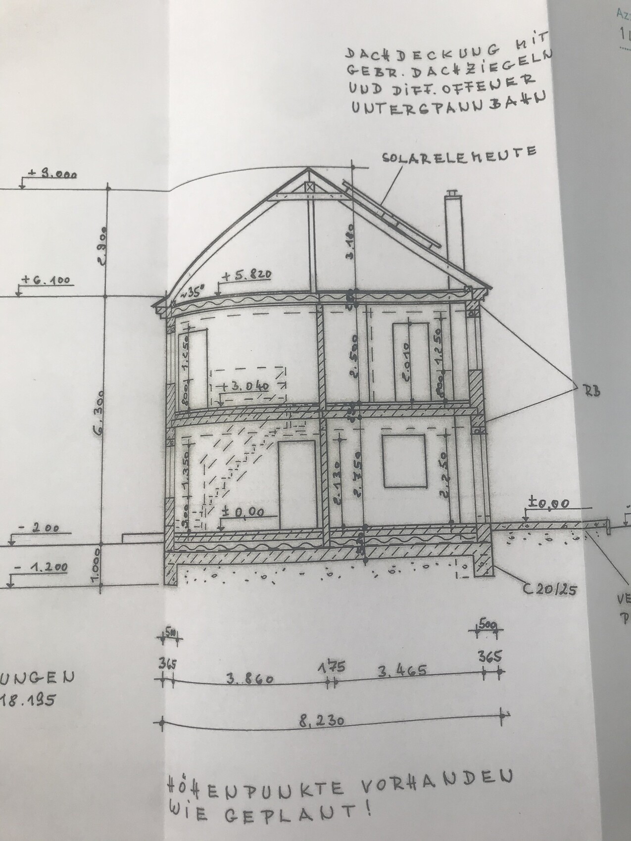

What do you think of the floor plan? Any questions?
I’ve attached some pictures to give you a rough idea.
