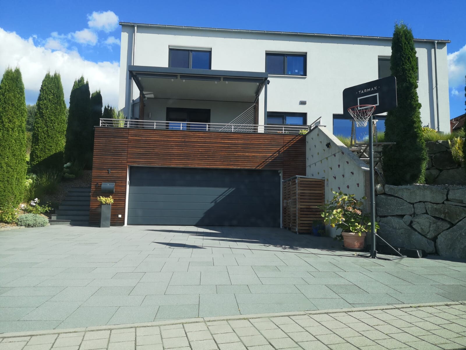

Philip St31 Aug 2025 18:33And we still like the idea of sleeping on the lower floor and living on the upper floor, but it’s not a strict requirement. We already like the sensible room sizes in our design. Where savings can be made, some space should of course be reduced, at least down to 170m² (1,828 sq ft). It’s also good that a separate apartment could later be created in the basement for a child, keeping the house flexible to live in. Having the kitchen closer to the stairs is convenient, as the pantry can then be reached quickly.
Is it possible to simply lower our house as it is, so that you can step out from the upper living floor onto the north terrace? And then have the garage built crosswise at the front. I will resend, among other things, the picture with the blue garage, which really convinced us. The house directly behind it, so that garage and house are connected. Perhaps this can be integrated into the already great sketch above.
It would be important for us to eliminate the steep driveway and also have parking spaces for two cars in front of the house.

We happened to be out and saw the following. Could this be an option, with some kind of access from the garage to the house above? Philip St schrieb:
Is it possible to simply lower our house as it is so that you can exit from the upper floor where you live onto the north-facing terrace? These are questions you should ask your planner or architect.
Philip St31 Aug 2025 20:29Okay. We now have many ideas in mind and have a much clearer vision. Thank you!

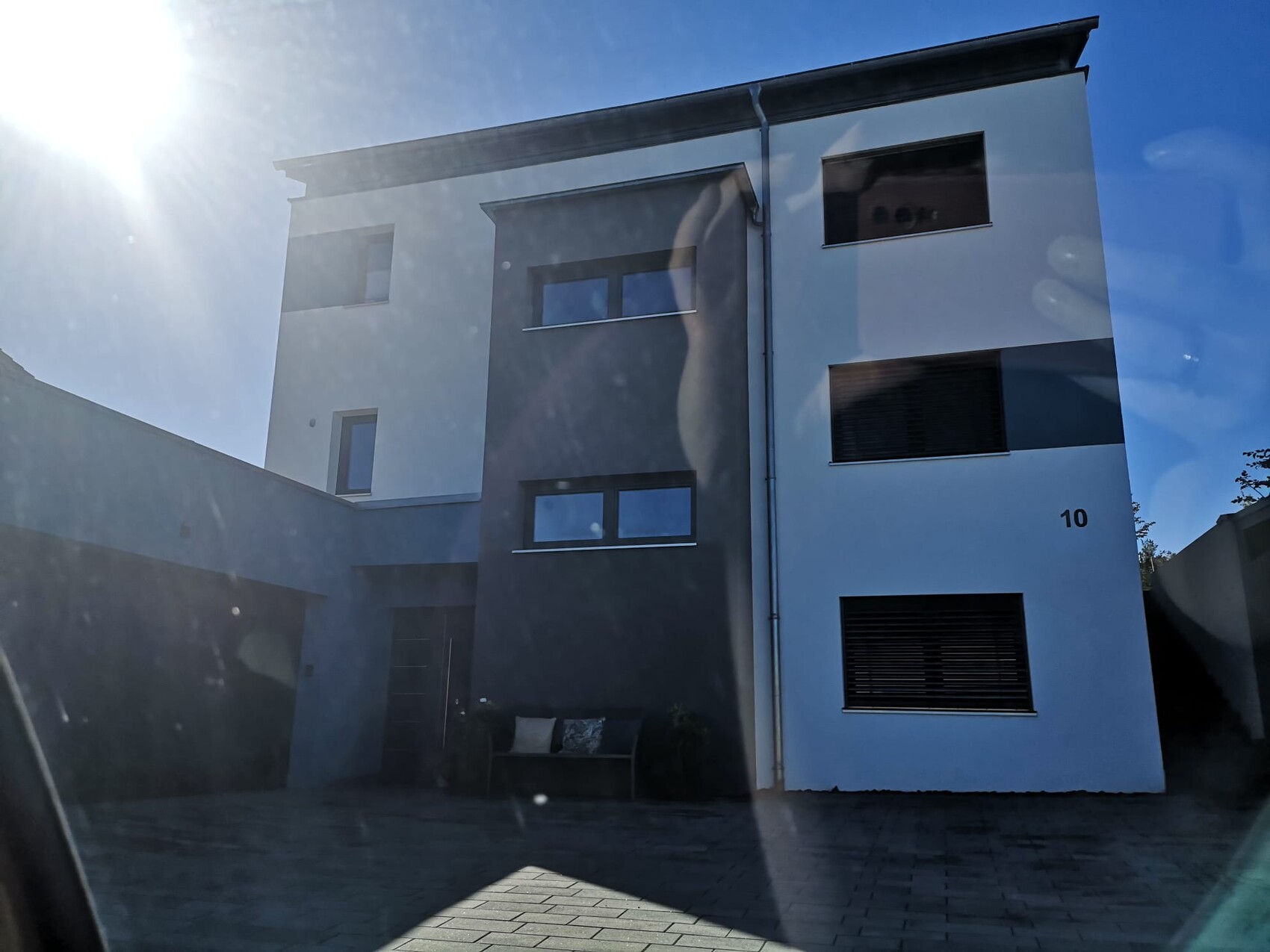

The photos you have shared here all show three-story houses. You are planning a two-story house.
While it is not prohibited to photograph, use, and publish images of other people’s houses, please make sure to pixelate license plates on cars next time. Viola and Jörg probably won’t find that amusing.
