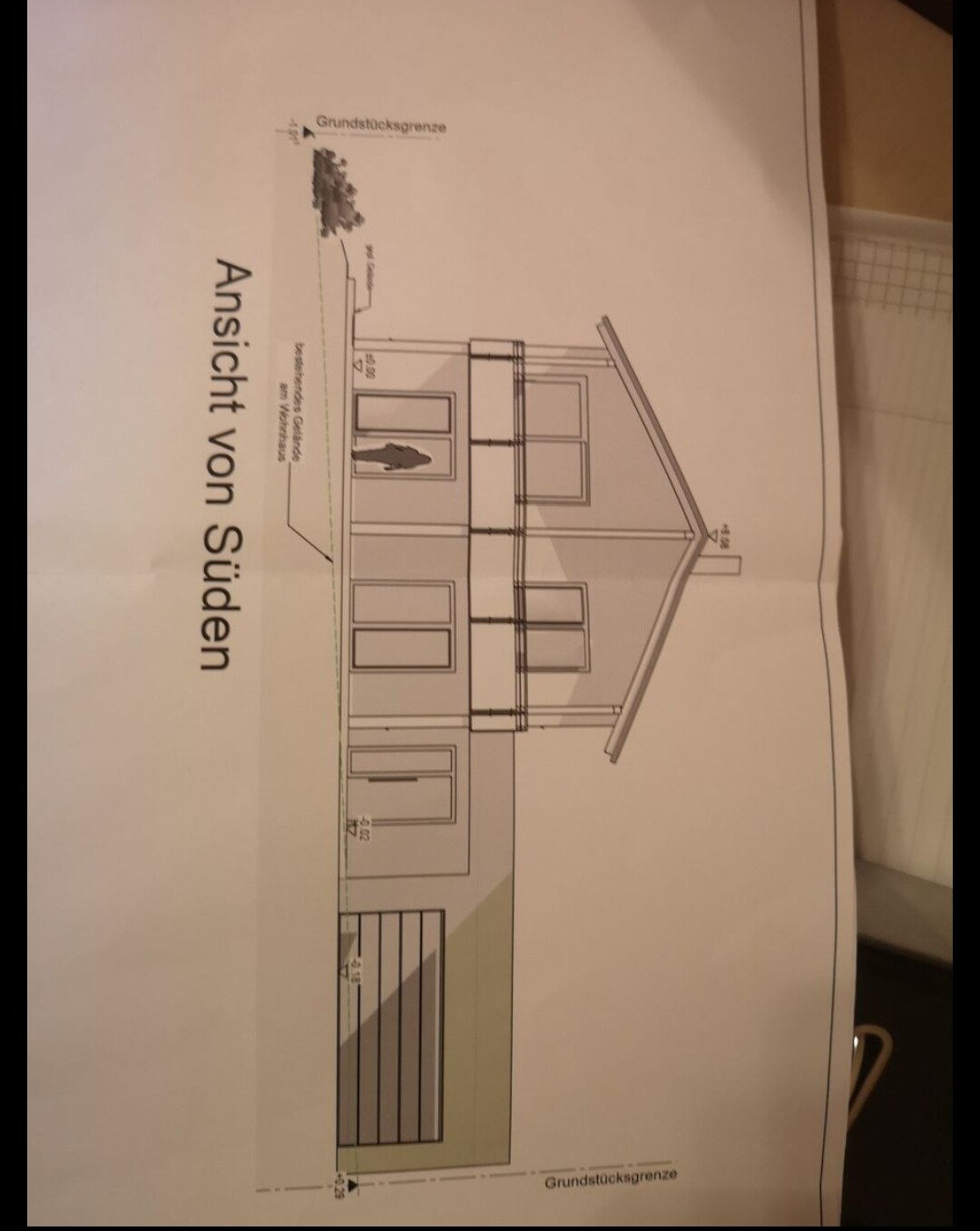

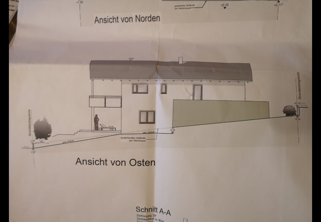

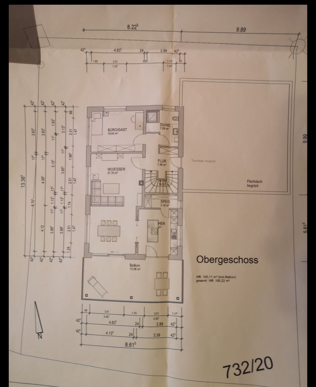

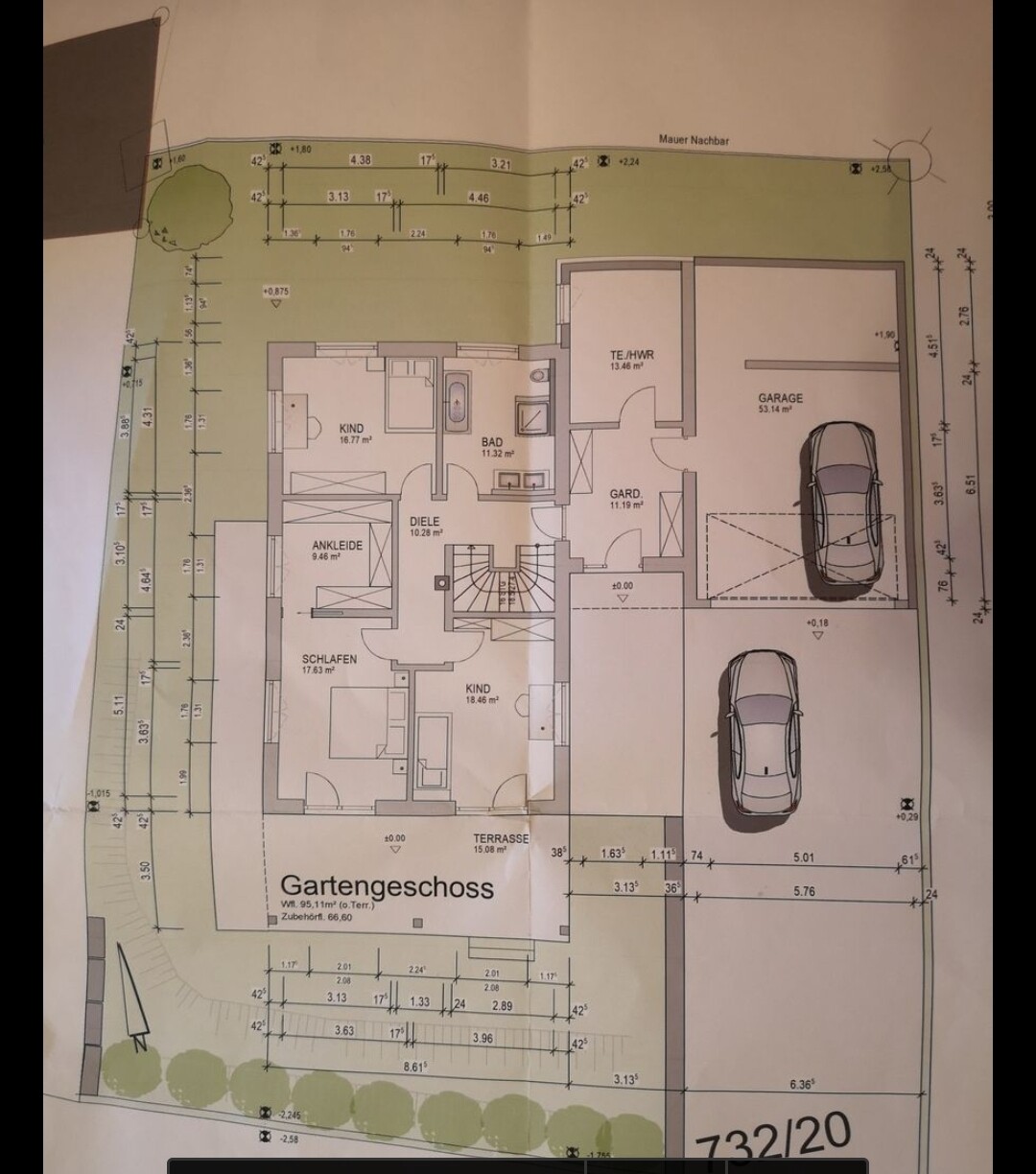

we had a local construction company prepare a design for our future building project, which we have already revised several times. We would be very grateful for tips or alternative design ideas for the current plan.
We would like an exposed roof truss and would prefer to do without the otherwise very small attic space.
We accepted the steep driveway in order to achieve a better view.
The terrace at the back is currently only accessible through the garden.
Construction is planned for about 8 months from now for various reasons. Two adults, two children (who will then be 13 and 11 years old).
Slightly sloped plot, 670sqm (7,215 sqft).
No development plan / zoning restrictions

We are not fully satisfied with the current design, as I explained in the post.
Steep driveway, path from garage to kitchen, after the stairs you face a wall upstairs and don’t have a direct view out of the windows, roof terrace is isolated, no quick garden access from the upper floor to the north terrace

Attached are images and the site plan.

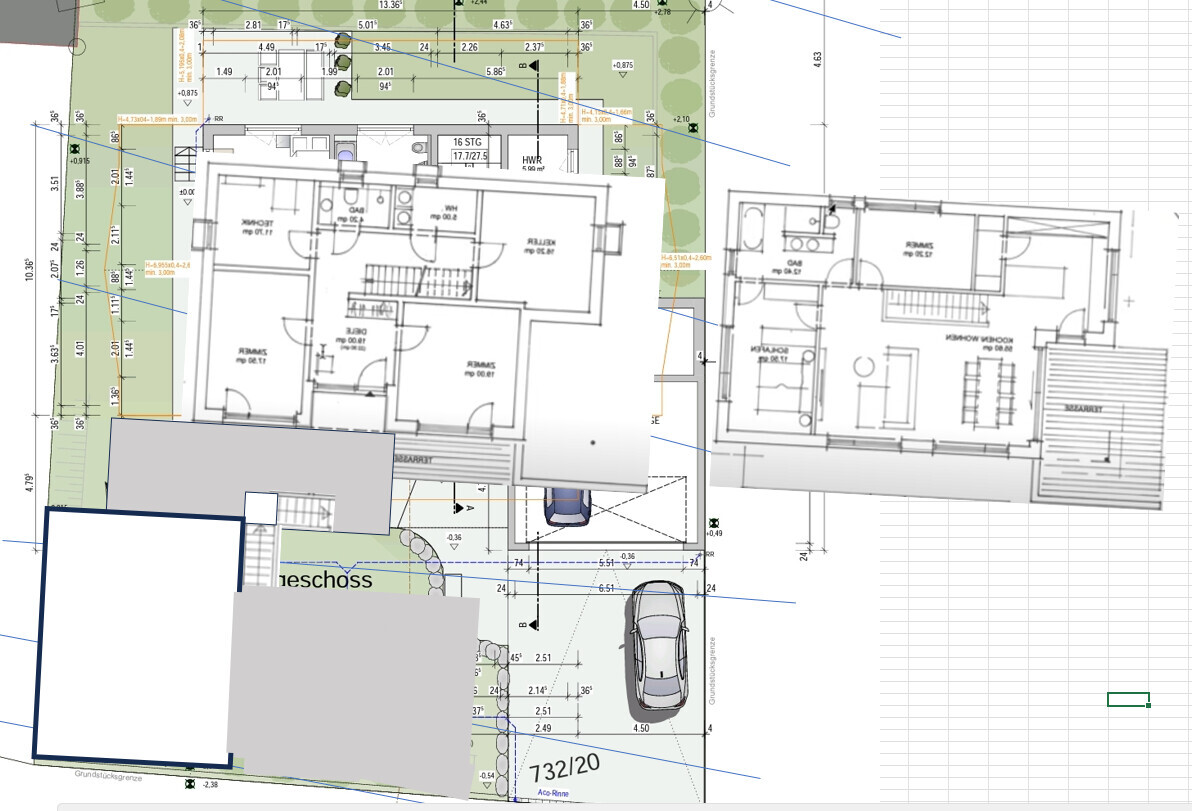

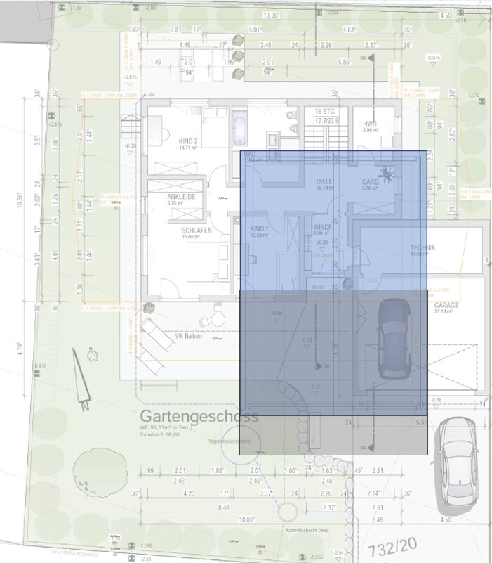

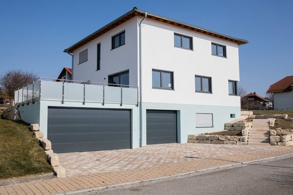

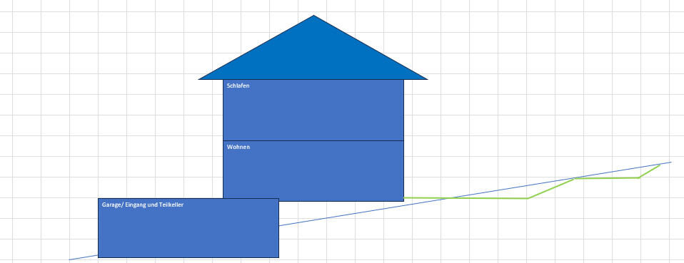

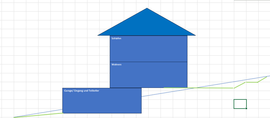

Philip St31 Aug 2025 07:23Does any of these images match your vision and fit better with our project? Would it perhaps be smarter to partially integrate the garage on the ground floor, including technical rooms, storage, and a utility room, and then build two floors above? The total living area should not exceed 200m² (2,150 sq ft). Or should some rooms be left unfinished?
Philip St schrieb:
Would it possibly be wiser to partially integrate the garage on the ground floor, including technical rooms, storage, and a utility room, and then build two floors above? The total area should not exceed 200m² (2,153 sq ft). Or leave certain rooms unfinished? No, it is definitely not wiser to integrate a large open-plan garage into the house and have rooms left unfinished. That also costs money. Three floors cost money. You have to like the tower-like construction, which also has other disadvantages.

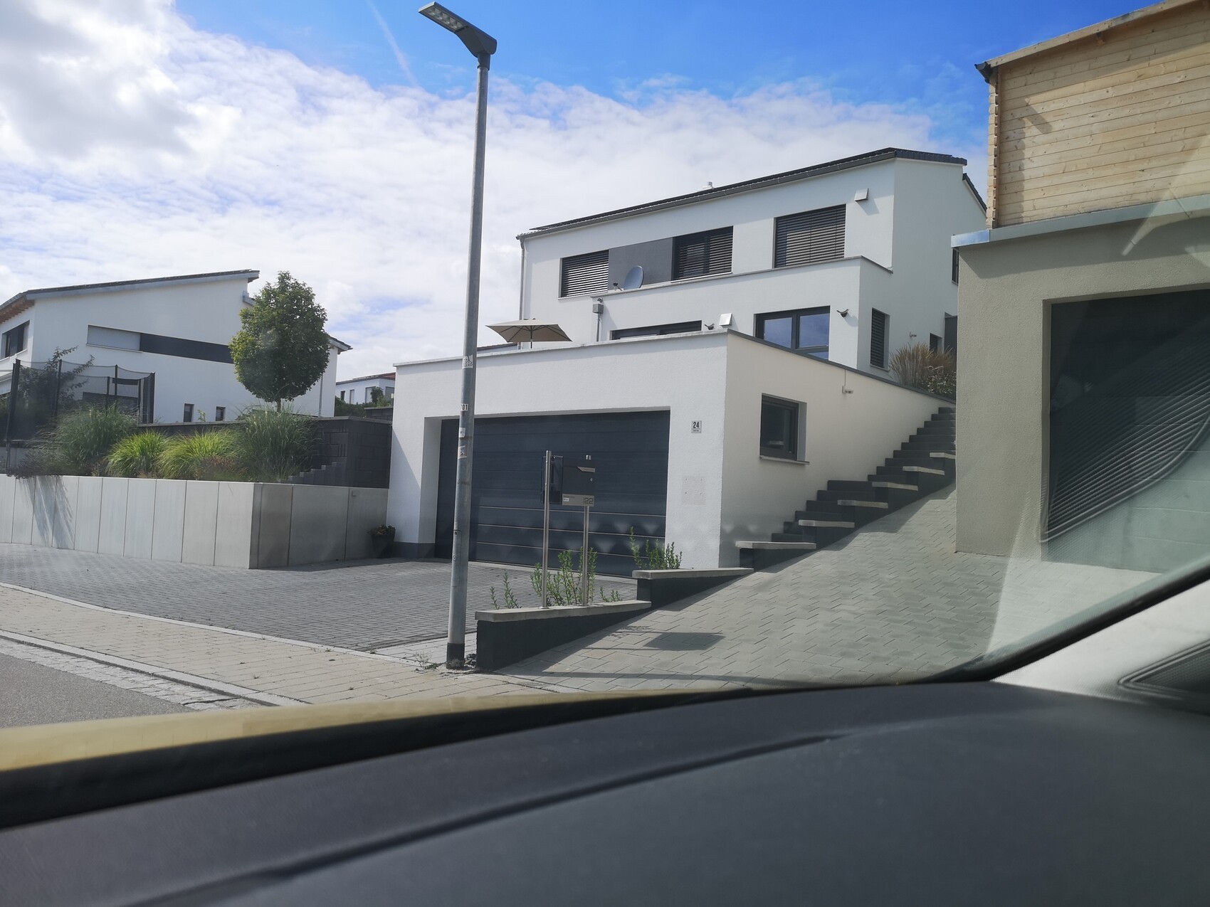

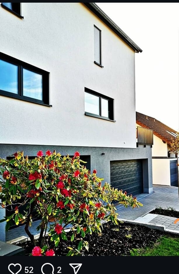

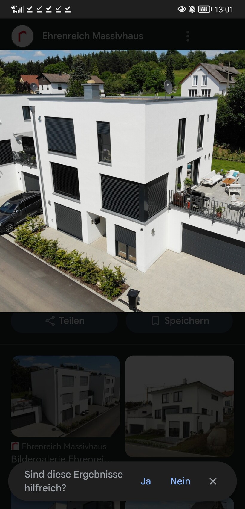

Philip St31 Aug 2025 18:15Thanks again for the revision. Some very practical solutions that will help us. However, we would prefer not to have to go up and down many stairs to reach the house.
A quick note about the stones. It should look good, but the neighbors had some issues with granite in their full, deep basement.

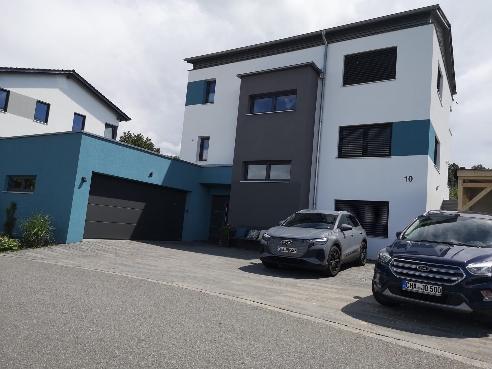

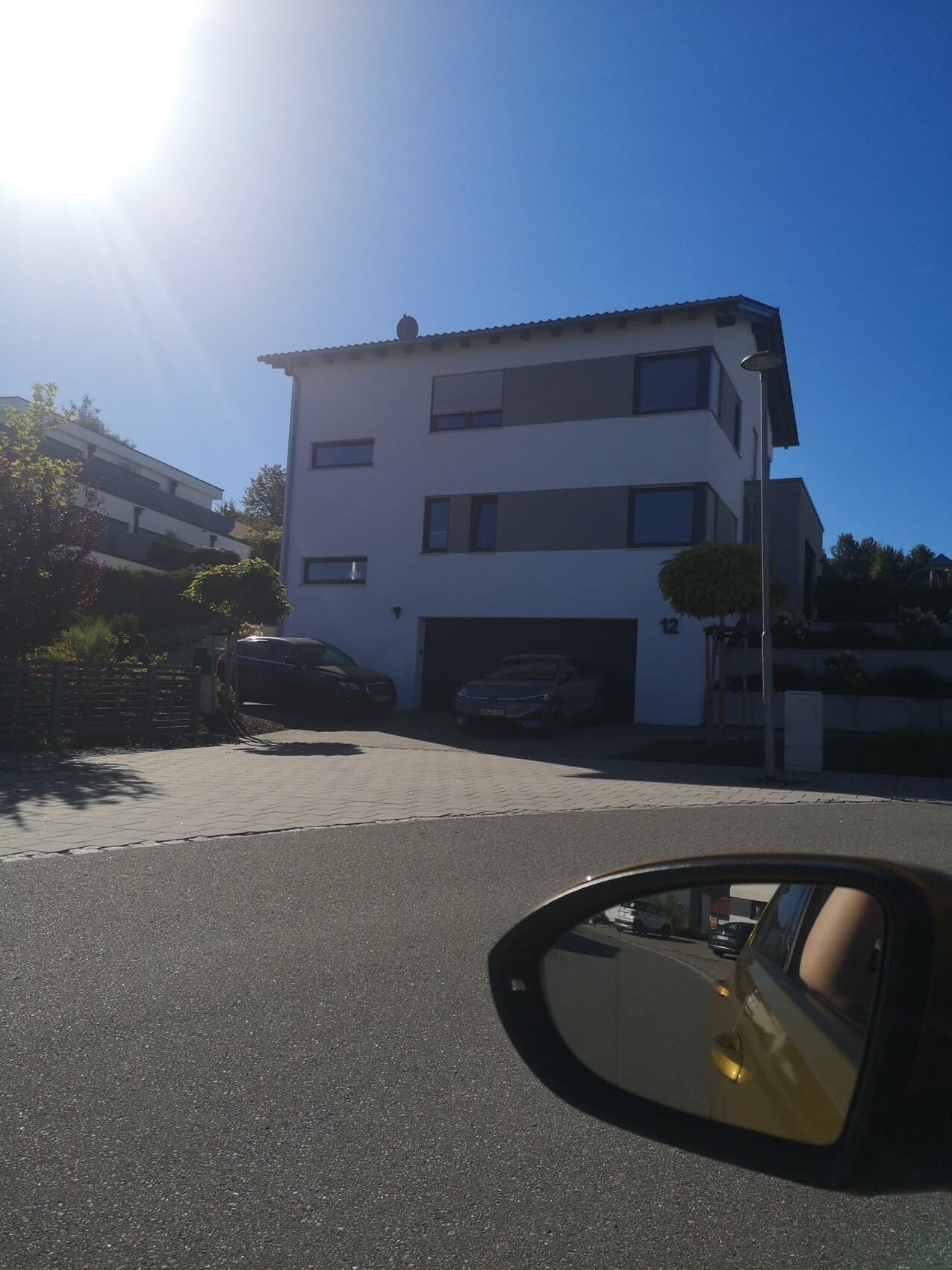

By chance, we were just out and saw the following. Could this be an option, with some kind of access from the garage to the house above?
