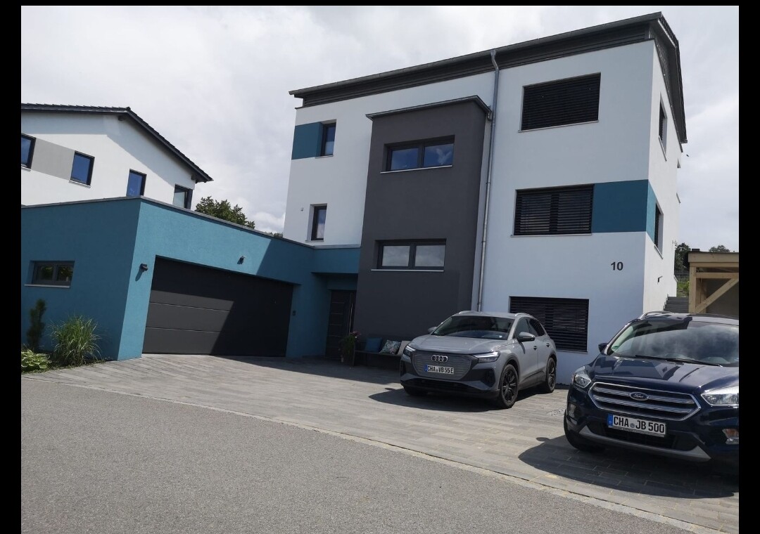

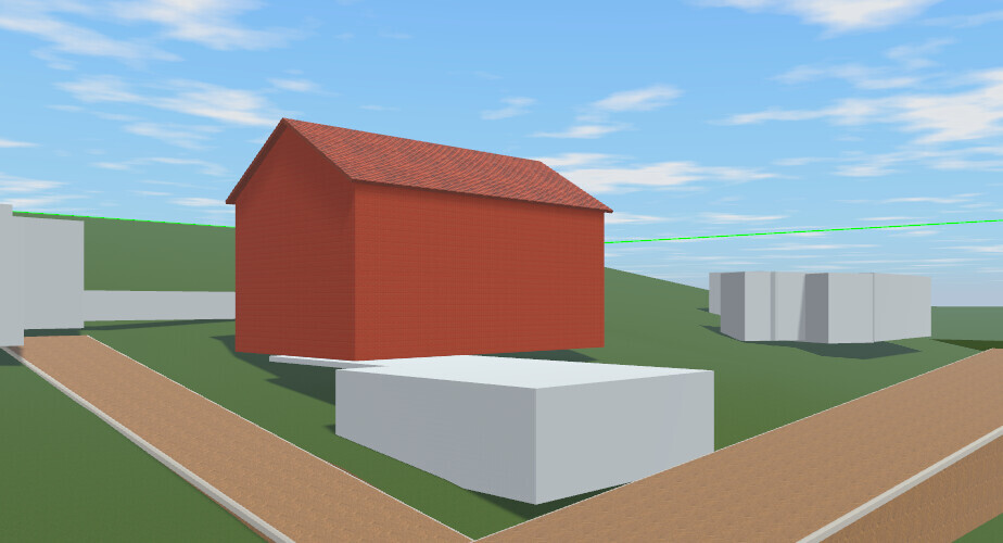

Philip St30 Aug 2025 18:4311ant schrieb:
"Better halves" are not always necessarily wiser. Over a dozen years with half a kilometer (0.3 miles) of walking between the garage and the house (no envy, it’s not the same property), I can count on one hand how many times I’ve gotten wet on that path.
I roughly sketched how I would position the buildings. Next to the garage, I left space for trash bins and otherwise relocated the garage with the same footprint. I extended the house by one meter (3 feet) in floor area and kept it in the same position by aligning the lower-left corner for easier comparison. If widened by one and a half meters (5 feet), the floor area would remain the same while saving a full meter (3 feet) of length, which would result in a 20 cm (8 inches) height difference between the uphill and downhill eaves at a 20% slope: Thank you very much for your effort. May I ask how it would be practical to design a forecourt to allow ground-level parking spaces?
Would the path to the house then require steps, or is the house positioned low enough already?
Philip St30 Aug 2025 19:21This house would have the garage positioned across the width, but then three floors, with the middle one at the back level with the garden. Can I implement this with two floors instead, since there also needs to be space for technical equipment inside the house? Sleeping on the ground floor would be difficult, as the entire rear would be a windowless basement.
There would also be access to the house.
Image 3 could work well. In my opinion, adjustments are necessary to reduce costs. I will take a closer look at it.
Then you have two floors up to the living area. As already mentioned, my suggestion would be to have the living area on the ground floor.
Save costs with a smaller house. You can plan well with 150m2 (1,615 sq ft). 50m2 (538 sq ft) × 3,000 euros equals 150,000 euros, which you need for the double garage and slope.
Are there already any details about the building ground? Have you asked the neighbors if there is rock there? Why did the previous owner back out?
Philip St schrieb:
Thank you very much for your effort. May I ask how it would make sense to create a forecourt to provide level parking spaces? Then the path to the house would have steps, or is the house located low enough already? If you keep the driveway where it is in your current planning stage, you’ll end up with a “forecourt as far as the eye can see” (possibly exceeding the allowable paved surface area). I didn’t want to address the question of “how many cars can park in front of the garage door” but only to show you where the garage could be accessed without needing to overcome a height difference. I placed the house only for easier comparison at the same “left front” corner as before. In this sense, the front door threshold remains exactly as originally planned. I would probably shift the driveway about its full width to the left as shown in the plan and pave only the area leading to the garage. I would follow the terrain for the path to the house using a compacted gravel surface (gravel bound surface) with stepping stones scattered within it. My sketch is only intended to inspire your imagination; it is neither a proposal from me nor a “go ahead and do it this way” stamp on this starting point in the form of the mentioned house corner. The ground floor layout was used as a placeholder and scaled proportionally, in this case keeping the same area but one meter wider. You could make the house roughly three meters wider overall (or accordingly shift it within the buildable area). I am not suggesting any specific alternative here, as that would go far beyond an informal consultation. As a prompt, this should suffice: 1a. separate the garage from the house; 1b. place the garage downhill >> purpose: driveway without gradients; 2. adjust the shape/proportions of the house aiming for a narrower gable >> purpose: primarily to reduce the height difference between the front and back of the house; optionally 3. shift the house within the building plot >> this also creates more garden space alongside the house, whether on the west or east side, your choice. If I recall correctly from @haydee, the house does not only “start” behind the garage. If you want more planning input from me: new projects currently being discussed can only be handled starting next year, so in about four months. But judging from the rough measurements of your planner(s), you don’t strictly need my consultation, so this brief nudge should suffice.
haydee schrieb:
@11ant your memory. No, our house is next to the garage. That’s how it happened.Exactly, that’s what I said: it doesn’t only start behind it. I remember seeing it from the street, to the left of the garage. Whether and how far it is set back along the front building line, I don’t recall in detail. In any case, the house is not set so far back that its front only aligns with the end of the garage (in the original poster’s case even with a gap). In my sketch, the garage is positioned so close to the street that the front edge of the house is noticeably set back and therefore clearly higher.https://www.instagram.com/11antgmxde/
