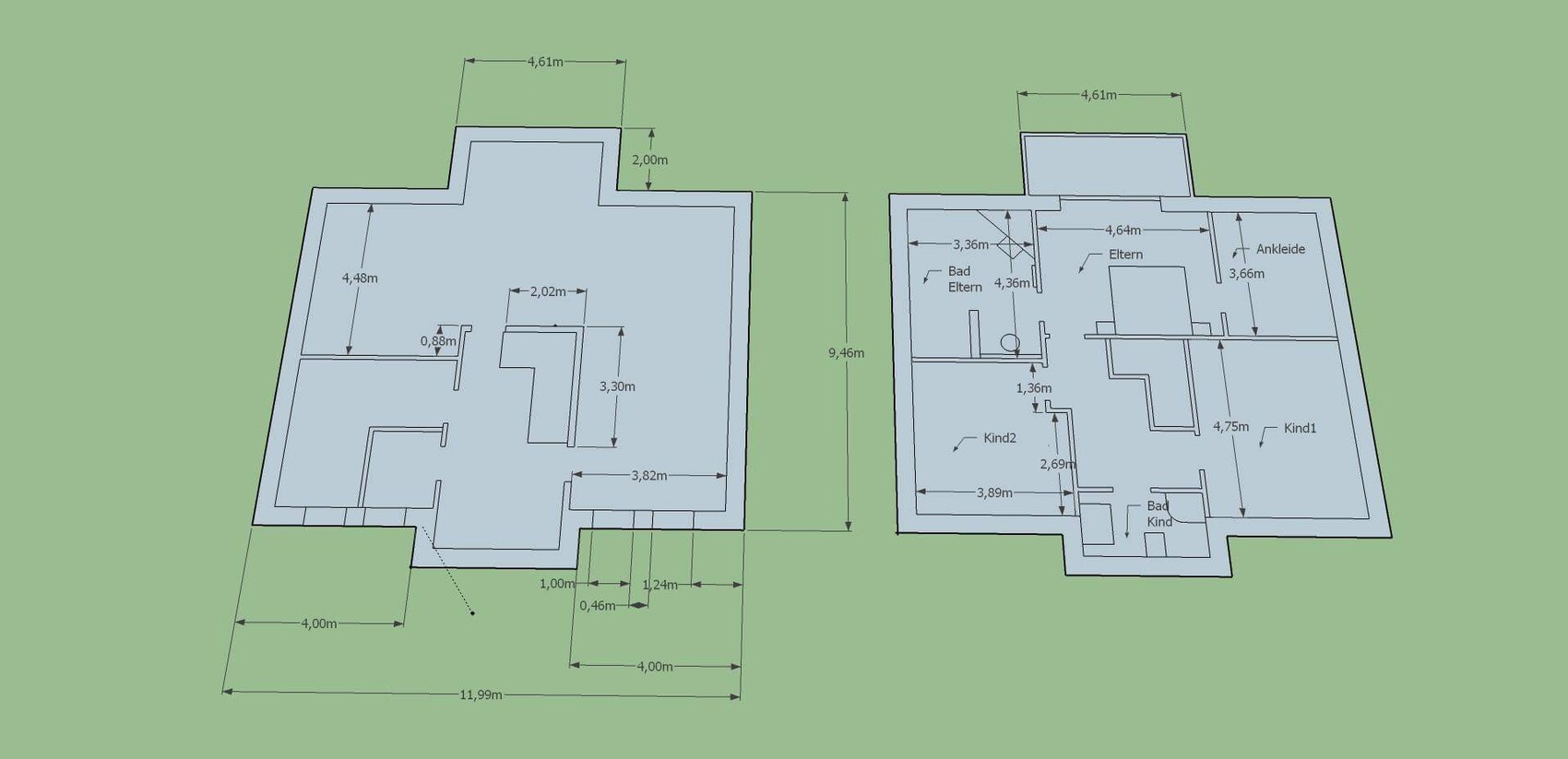

We have a meeting with the architect coming up soon. We were advised not to show up empty-handed, so we created a floor plan based on our amateur ideas.
What do you think? Is it practical as it is?

I would appreciate any suggestions or recommendations for improvement, so we can provide the architect with enough material to turn it into a buildable design.

j.bautsch6 Oct 2016 08:19Well, the thing is, when you go to an architect with a fixed plan, you subconsciously put blinders on them. If they only receive a few square meter (square feet) figures on paper and a rough room layout, they can think much more freely 😉

Regarding your design: to me, it looks more like an urban villa than a country house (again, those unfortunate dormers!). And yes, you parents are treating yourselves to the luxury suite (but: where is north? That would still be important). You can do it, but keep in mind: your children are in their rooms during the day, while you are there only at night for sleeping. I also find the layout with the bedroom placed between the walk-in closet and the bathroom less than ideal.

P.S. As I see it now, nobody can make sense of the drawing above.
