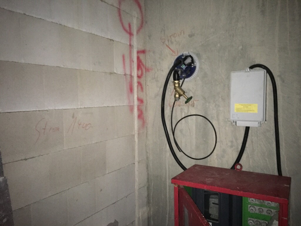

R.Hotzenplotz19 Jun 2018 18:03I have the impression that many people involved in our construction are currently building their first house.
Anecdote from today.
The site manager contacted the electrician, asking why the distribution box / house connection box was installed where the heating system is supposed to be.
The electrician replied, saying it’s not his responsibility and that the site manager should contact the utility company that installed the connection. He said he hadn’t installed anything.
What is the usual procedure in a case like this?
