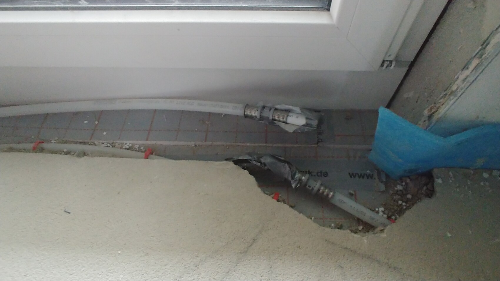

The area with the connected underfloor heating pipe now looks like this.
Shell construction area indoors with visible water pipes, tiled floor, and construction dust

Regarding the blue stripes: they were all removed/cut by the flooring installer before the vinyl was laid on top.
Alex85
23 Sep 2018 18:49
The edge insulation strip should be as high as the floor covering and is therefore trimmed only after the floor is installed.
Is the water really coming from above? Do you already have a damp-proof course and base render applied on the outside?
Then I probably have a problem in the photos shown, where the drywall installer cut it off?

I don’t see where else it could be coming from. It’s exactly where the flat roof is still in the shell construction phase. As far as I know, the base waterproofing is at ground level. The whole house is already built on our site. However, the base coat plaster on the upper floor on the side where the water came in is not yet applied, since the new patio doors were only recently installed there. Still, it’s strange that none of the previous rainfalls caused this issue at that location.
blackm8823 Sep 2018 19:38
Water in so many places in the house is not a good thing.
And the spot with the underfloor heating doesn’t make sense to me. What is that supposed to be?

And the part about the underfloor heating doesn’t make sense to me—I’m not sure what it’s supposed to be.
I have noticed that two loose ends are lying on the floor and are no longer connected to each other.
