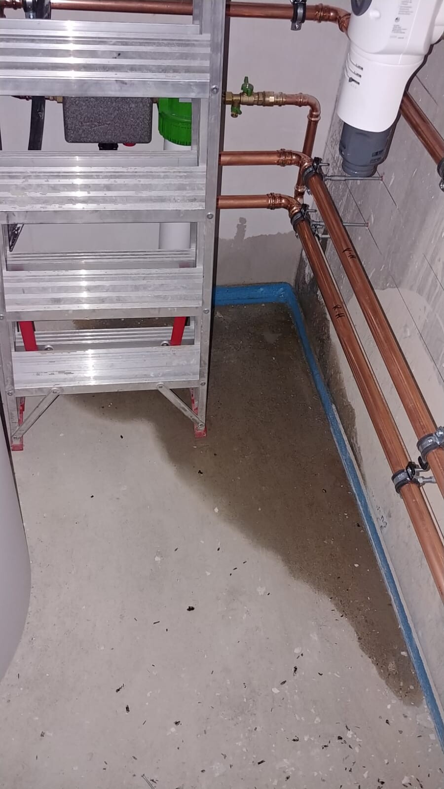

After the roofer was here, I thought today, during the first rain since then, I’d check the basement—and then I see this disaster!
Basement room with copper pipes, heating and plumbing installation next to metal ladder
Water is dripping from the newly installed copper pipes. But it only happens in direct connection with the rain. Could the water be finding its way through the multi-utility conduit into the copper pipes? I can’t reach anyone today who can help with this. Simply terrible!!!!
