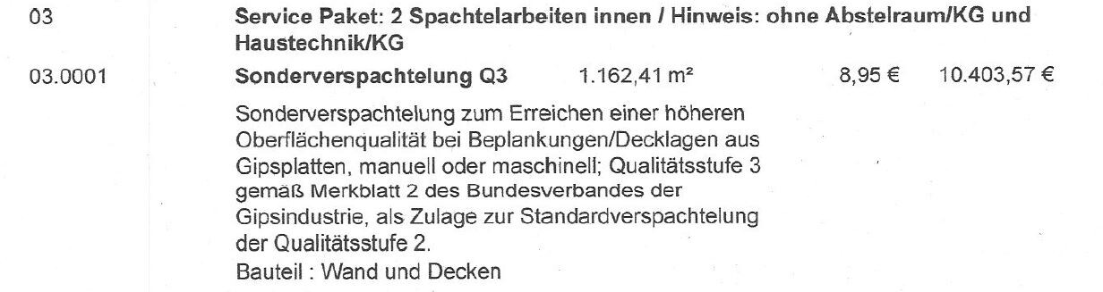

By the way, this is what it says in the painter’s contract.
Scan eines deutschen Textdokuments mit Hinweisen zu einem Servicepaket für Spachtelarbeiten und Preisen.
And it states that this does not include plastering work but rather filling work. I have no idea. I can’t resolve this on my own and will consult the expert again for clarification.
