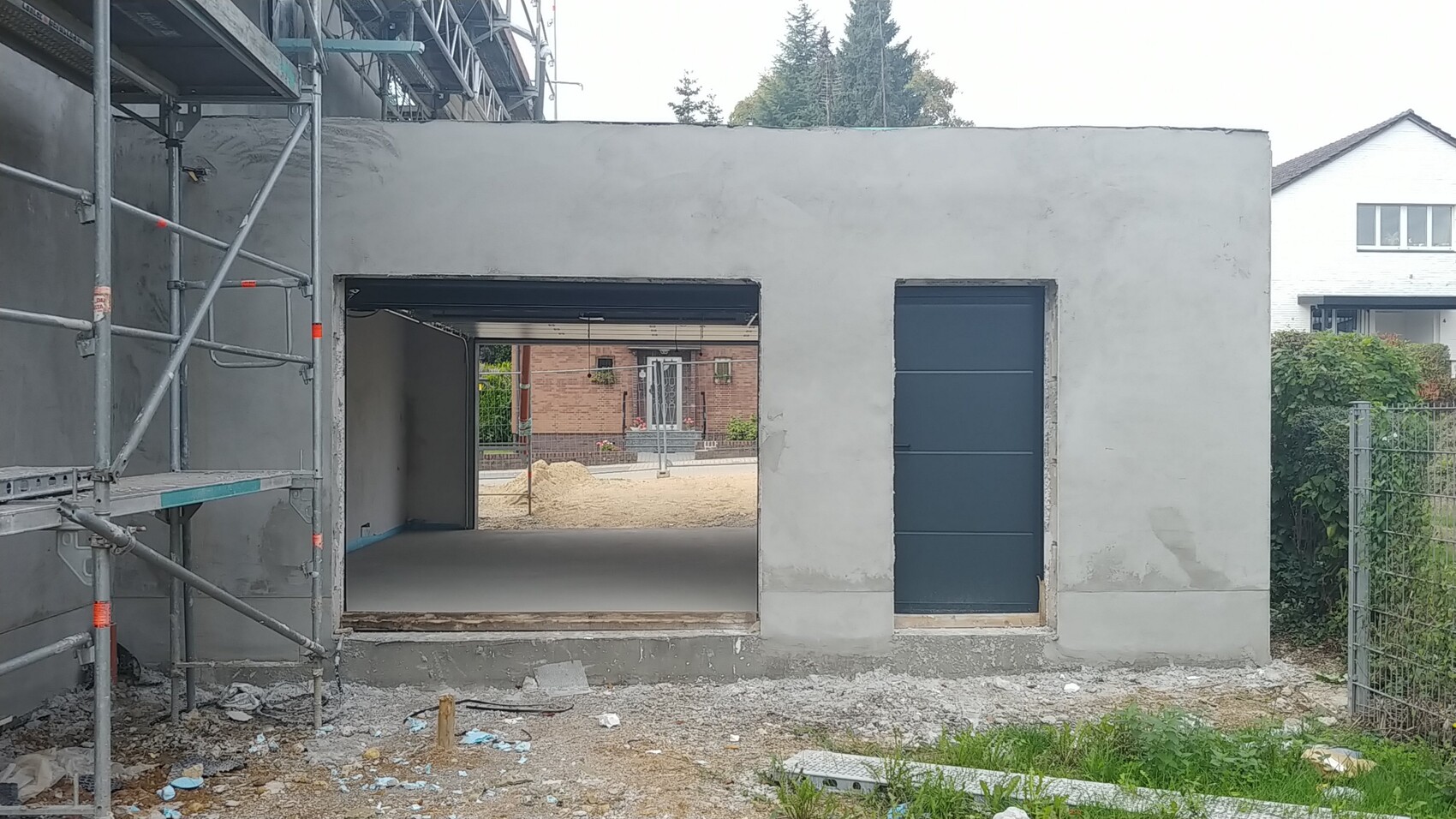

Could it be that the rear gate is set lower because it was aligned flush with the door?I would say the gate was not adjusted to the door, but rather the other way around.
The door is shown in the plans without any dimensions, whereas both gates are listed with a height of 2.135m (7 feet) there. So I rather think the door is a downstream issue.
By the way, the door is the only one in the whole house built at a height of 2 meters (6 feet 7 inches). Even the criticized patio doors were taller. So it just doesn’t add up at all.

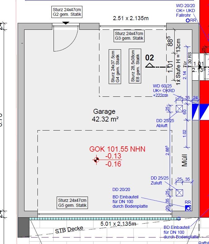

There is a building permit / planning permission and an execution plan, which are technically identical. Both documents show the two garage doors as well as the door. The door has no specified measurements in either document. The garage doors are each marked with a height of 2.135 m (7 feet) in both documents.
Furthermore, the contract states that the two garage doors are to be installed exactly as specified in the building permit / planning permission – Garage Door A in Design X, Garage Door B in Design Y. Nothing more, and nothing less.

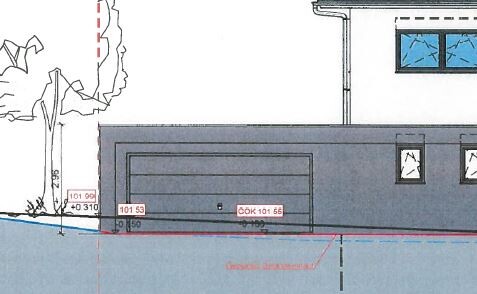

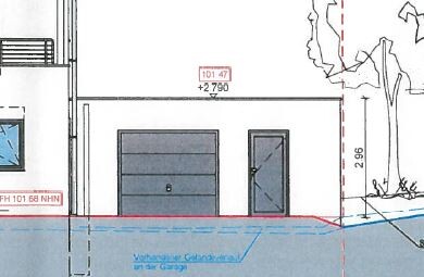

This is the construction drawing (similar to the building permit application—but not exactly; in the permit application, the upper gate was also indicated to have the same width as the lower gate…):
And the building visualizations.
And here’s a photo from the back:
The building height is indicated there. I measured it myself to establish a scale and measured the garage on the drawing. It definitely shows more than 2 meters (6.6 feet) at the back, not less!
