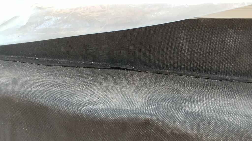

The site manager recently reported that he has repaired the partial defects in the window sealing mentioned in the last report. I checked this randomly at the ground floor terrace door. The expert was not present again, but I have the feeling that it is still not okay.

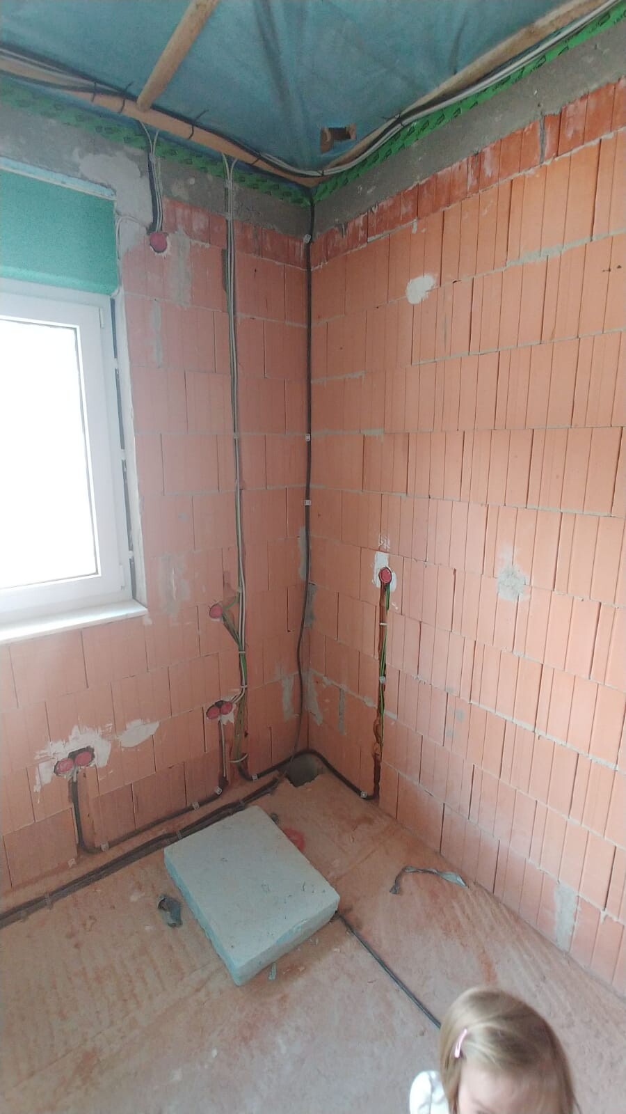

Bookstar schrieb:
Why weren’t the empty conduits for electrical wiring run all the way to the outlets? Obviously, these were used here as protective conduits where the cables bend between the floor and the wall (since the wall was not channeled). This is not a defect, more a matter of preference to handle it this way.
