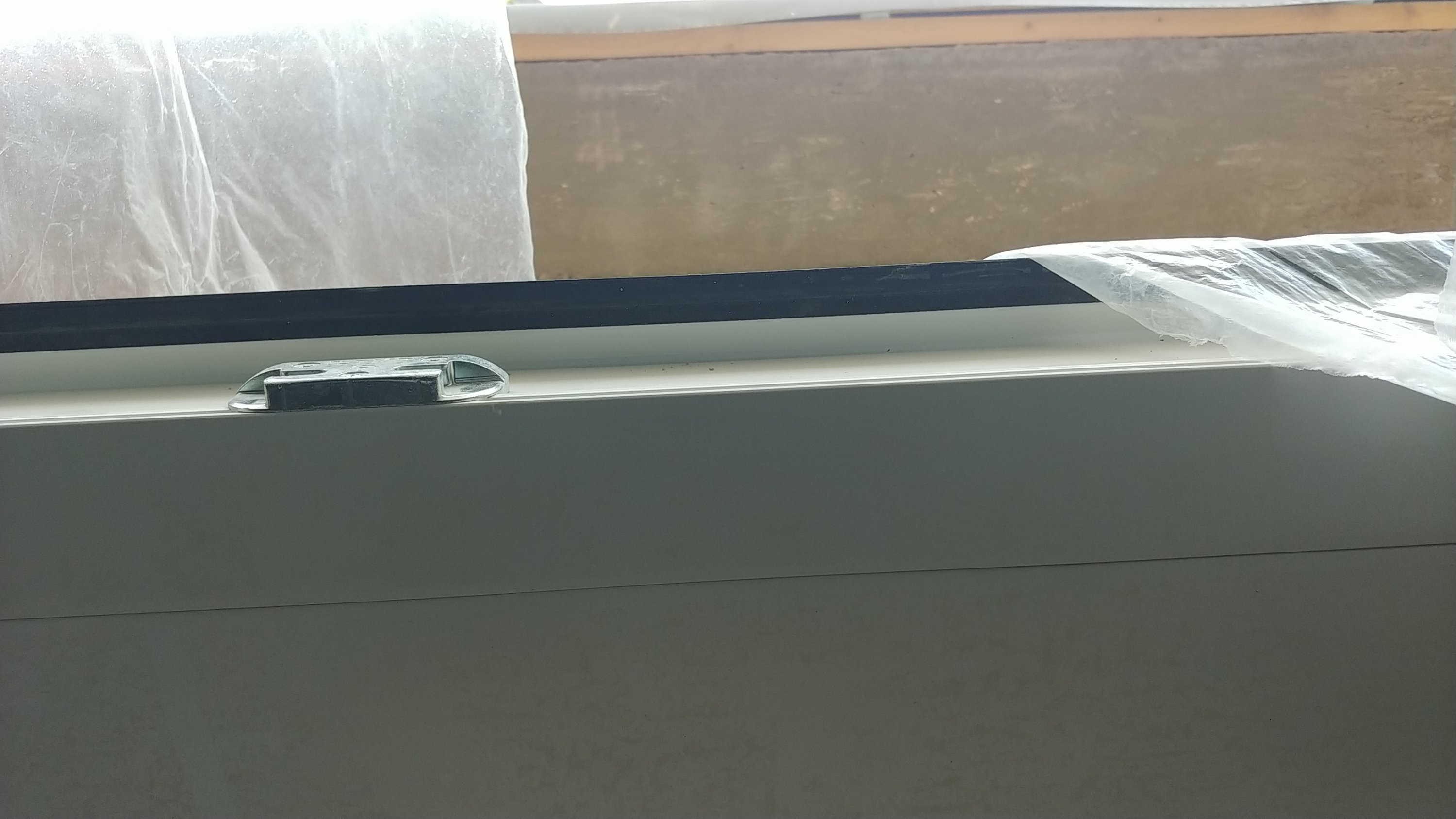

R.Hotzenplotz
24 Jul 2018 07:35
It is, as mentioned, clear that the threshold is meant from the inside to the outside.
However, it is also interesting to clarify exactly what the door threshold is.
Is it the upper edge of the black section or the upper edge of the white section below the metal fitting?
11ant24 Jul 2018 14:55
R.Hotzenplotz schrieb:
Upper end of the black area or upper end of the white area beneath the metal bracket?
I can't view the picture; it's the upper end of the seal beneath the "external window sill." And this was measured from the top edge of the terrace floor covering (at the highest point).
R
R.Hotzenplotz
24 Jul 2018 16:09
I cannot view the image
