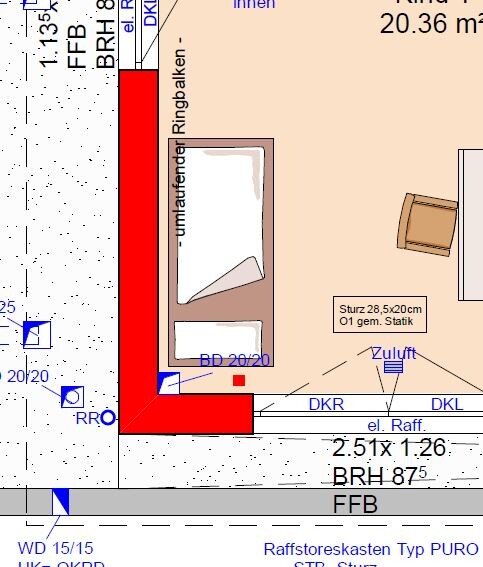

R.Hotzenplotz6 Jul 2018 15:04So now there are only two options left, and I have to make a decision.
Either the installed pipe is boxed in, and the bed is accordingly moved. However, I think this only makes sense if the wall is boxed in either to the left or below on the plan, all the way to the window. Otherwise, it’s just a bad solution because the bed would partly have a gap next to it. From a technical point of view regarding pipe ventilation, this would be the cleanest solution.
I honestly don’t see any scenario where the bed can be properly placed together with the pipe. Changing the room layout would require extensive electrical work, as switches, sockets, etc., are coordinated accordingly.
The other alternative is the pipe vent in the guest bathroom, which would disappear behind an access panel tile. Technically, however, this would be a less elegant solution than venting the pipe through the roof.
I don’t know what to do. I’ve been going around in circles with this all day.
Does anyone have a creative idea on how to solve the pipe issue in the children’s room? Drywall with a niche, or something like that? Technically, I would feel more comfortable with that, but at the moment the tendency is still towards the pipe vent in the WC, since I don’t see a scenario where drywall construction could solve the children’s room situation with bed placement in relation to the lower window sill cleanly.

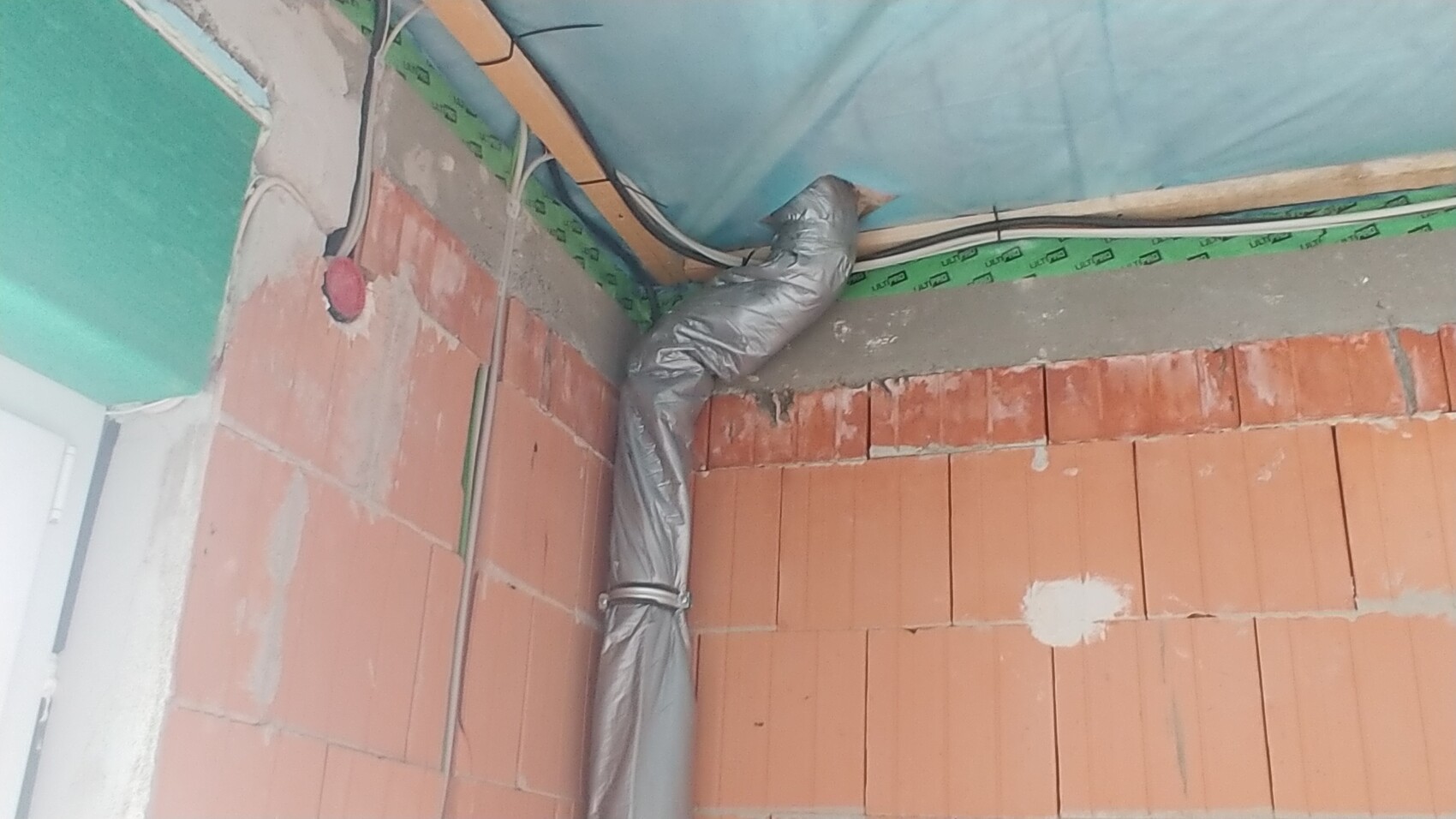

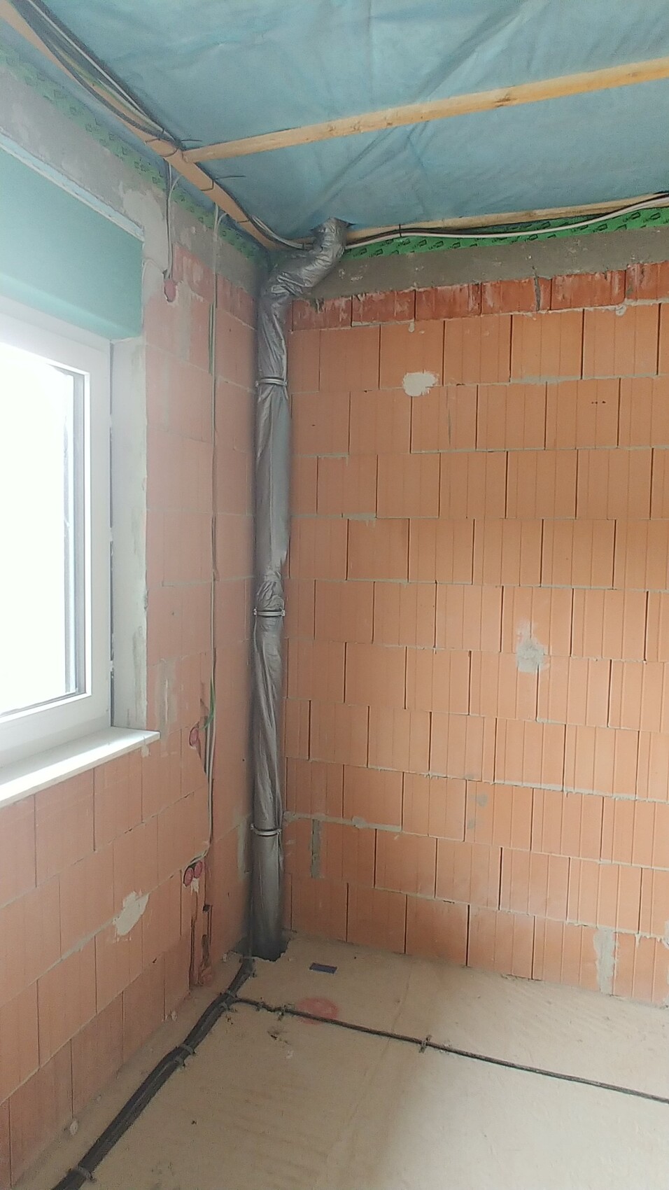

This is what the pipe looks like. So even in the best case, it won’t be a small boxed-in area.
