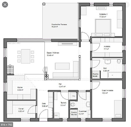

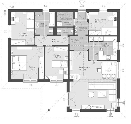

Something like this – mirrored, with a utility room instead of a pantry, and staircase instead of a mechanical room or vice versa. Instead of a walk-in closet, a study.
Or even with a closed kitchen:
Instead of an office, a stairwell, which creates a nice private area. The utility room here is a bit small, but maybe you could move the heating system upstairs under the attic and then only need space for a washer and dryer downstairs...

Oimelwutz27 Aug 2020 11:22Elokine schrieb:
Something like this – mirrored, with the utility room instead of the pantry, and either stairs or technical room swapped. Instead of a dressing room, a study.
Instead of an office, a stairwell, which creates a nice private area. The utility room is a bit small here, but maybe you could move the heating system upstairs under the attic and then only need space for a washer/dryer downstairs...These look interesting. Do you happen to have the floor plans in a higher quality? I can more or less make everything out, but I’m still having some difficulty.
