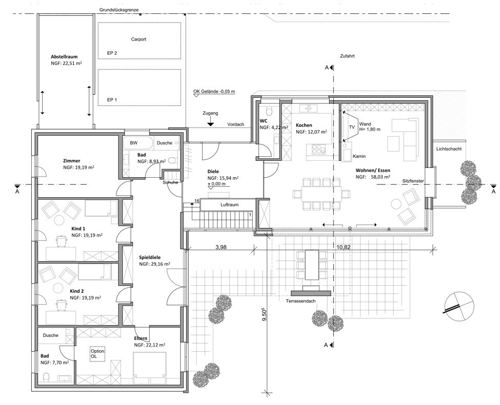

We wanted all living spaces on one level. The building essentially consists of two cubes, a "private" section at the north side of the plot and a more "public" section to the southwest. Both parts are connected by the entrance hall.
We wished for generous living and sleeping areas (where you spend most of your time) with large floor-to-ceiling windows. A permanent guest room for overnight visitors and/or an au pair was also important to us.
The children’s bedrooms all face north and will each have a door plus a window opening onto the garden.
We are not big fans of wellness areas, so the bathrooms are planned to be rather small and functional. It was also important to have a full bathroom near the guest room (in the basement). The guest toilet in the hallway might possibly be removed and the space reassigned to the kitchen.
It was important for us to have a large dining area that can comfortably accommodate up to 10 people without any rearranging.

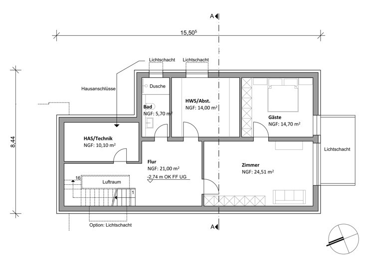

In the basement, there is a large corridor where a desk might fit under the stairs for a sewing machine or similar. There is also a large multipurpose room for children, parties, storage, or a bar.
Both the ground floor and basement should have generous ceiling heights (we are currently planning at least 2.70 m (9 ft) on the ground floor including a suspended ceiling).

- Is the technical room large enough for geothermal heating, the control cabinet (KNX), and network cabinet?
- We are still uncertain about the kitchen layout.
- The doors from the entrance hall might be implemented as glass sliding doors, as these will likely remain open most of the time.

GeradeSchräg26 Apr 2021 12:30Honestly, I really like the design; it’s exactly how I would move in =D
What I would change, which has also been mentioned, is the 1.8m (6 feet) high "TV wall." I would make it full height up to the ceiling. This would help reduce noise coming from the kitchen when someone is watching TV there.
I would keep the guest toilet. There’s enough space for it, and the kids deserve their privacy. Plus, the kids’ bathroom can sometimes get a bit messy.
That’s open for debate. Compared to the rest, it feels quite separated and less modern, but it’s functional. In the end, it’s a matter of personal taste.
Overall, I’d say it fits. But it really depends on how you want to set up your KNX/network system. For a high-end KNX system with all the extras, the control cabinets can get quite large. A better source of advice for this would be your heating engineer and electrician. They can give you a more precise idea of the space required for all the technical equipment based on your plans.
I’d recommend designing them so that the doors slide into the wall behind the built-in cupboard in the dining area when opened toward the dining room.

- Definitely remove the guest toilet in the hallway (3 bathrooms should be more than enough)
akanezumi schrieb:
- We’re still a bit unsure about the kitchen layout

Doors from the entrance hall might be implemented as glass sliding doors (since they will probably mostly remain open anyway)

akanezumi26 Apr 2021 14:05GeradeSchräg schrieb:
What I would change, which has also already been mentioned, is the 1.8m (6 feet) high "TV wall." I would make it full height up to the ceiling. This would reduce noise coming from the kitchen somewhat when someone is watching TV there. Yes, that was addressed during one of the design iterations. The wall is now full height up to the ceiling.
I would design it so that it disappears into the wall behind the built-in cabinet in the dining area on the side facing the dining space. Yes, the sliding door to the living/dining area will be designed exactly like that. It will slide into the wall behind the cabinet.
