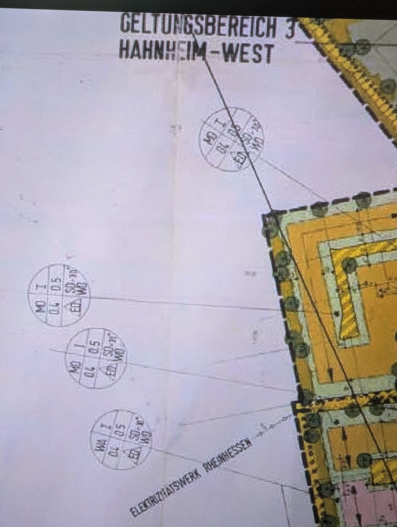

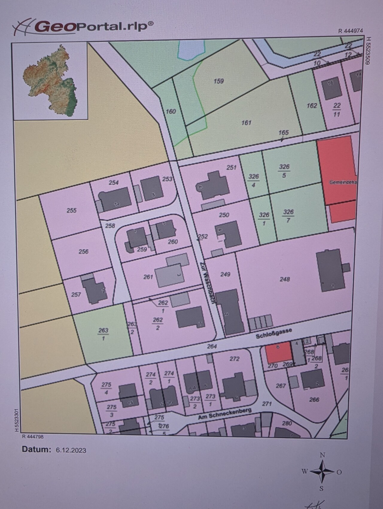

Building regulations / restrictions
Plot size: 620 sqm (6,675 sq ft)
Slope: none
Site coverage ratio (floor area ratio): 0.4
Floor space index: 0.5
Building envelope, building line, and boundary lines:
Edge development:

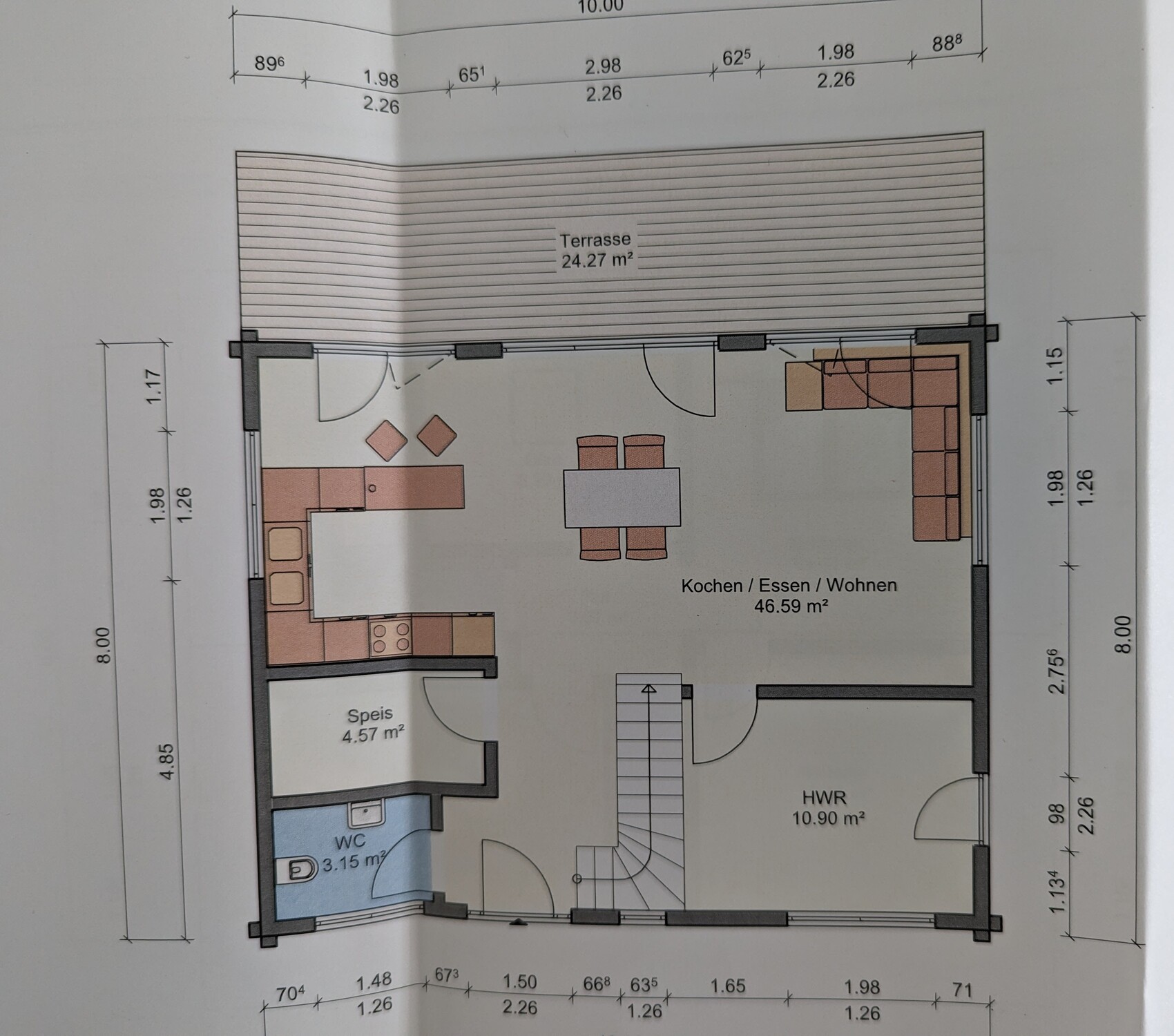

Ground floor: kitchen, dining-living room, utility room, guest toilet, pantry

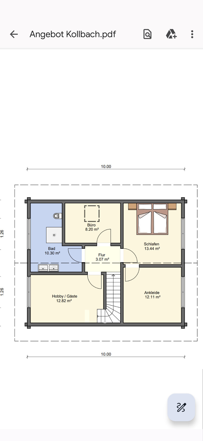

Upper floor: bedroom, dressing room, office, bathroom, hobby room
Office: family use or home office? Home office 5 days a week

What do you like most? Why? Most of our wishes were implemented, open living area, many windows facing the garden
What do you not like? Why? No space for a coat rack, door to the utility room is in the living room, questionable positioning of bathroom fixtures upstairs (due to sloping ceiling, knee wall 1.40 m (4 ft 7 in))

Additional note: Access from the garage to the utility room should be possible because of the dog; all leashes etc. can be stored there.
The wall of the utility room extended to the outside edge of the staircase. We considered moving the wall inward a bit to free up space under the stairs.
We thought about installing a wardrobe system there to use the space as a coat rack or, if the coat rack can be implemented elsewhere, moving the door to the utility room from the living room under the stairs.
There was also the idea to move the stairs and “shift” the guest toilet into the utility room to create more walls in the utility room. The room seems quite large to us, but washing machines, dryers, or other appliances are not placed in the middle of the room. We want to avoid a large open area in the center.
The dryer and washing machine could also move to the upper floor (short distance to the dressing room); here we have quite some freedom.
Our plot is located in a cul-de-sac with a field-edge location, parcel 256

You enter and immediately bump into a corner. The WC and staircase entrance are located in the dirty zone. That is really a deal breaker.
Creating an open-plan living area with large windows to look into the garden is something even a child could design.
A large pantry for two people: what for? The freezer is already large. Instead, the kitchen should be made functional, which would save some trips while cooking.
Currently, there is very little cupboard space.
On the south side, only a kitchen window and utility rooms are planned. The north side has more windows. Yet hobby and guest rooms have been placed on the south side. Photovoltaic panels would be ideal on a dormer-free roof, possibly as an upgrade, but here it is not facing south.

to move the door to the utility room from the living room under the stairs. The stairs are too steep for that, and the door would be partially blocked by the stairs above.
I wouldn’t pay any further attention to this design and would wait for the appointment with the right architect. This thing is rubbish and belongs exactly where it is.
If I were you, I would focus more on questions like ceiling heights, allowable knee wall height, orientation on the plot, and so on.
