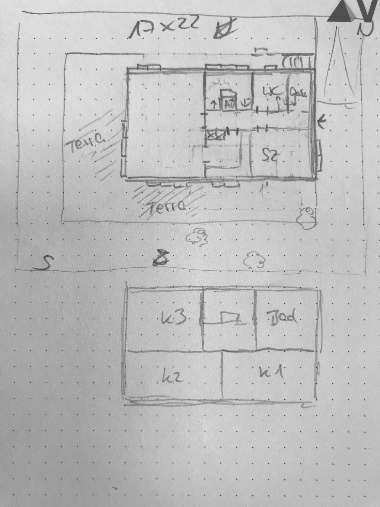

Hello everyone!
After reading here for quite some time (and checking out nearly all floor plan questions for similar lot sizes and building dimensions), we now have some questions about the preliminary design from our builder.
Our situation is similar to the forum post from Wednesday, but our main focus is on the basement J
This is the first draft based on a rough idea of what we envision and what is important to us (the design seems quickly done to me—see the projecting dormer—or is that common nowadays?), but overall all our requests have been considered. We see room for improvement especially in the basement level, the basement stairs/daylight wells, and the size of the living/dining area (probably only fixable with a larger house footprint). The upper floor works well for us.
Independently from the builder, we came up with a similar floor plan that meets our needs; it is nothing “special” but fits our ideas well.
We would appreciate it if some of you could share practical tips or suggestions for changes so that we can respond to the builder and discuss possible deviations.
Feel free to be thorough and please also point out any potentially major planning mistakes.
I have attached the following:

Escroda schrieb:
I don’t see the problem with the basement at all. Everything can stay as planned, except the basement becomes the first floor and the dormer on the top floor is omitted. This also saves money, aside from excavation, disposal, exterior basement stairs, waterproof concrete shell, and slope grading. The rooms can then be used flexibly, for example, a guest room on the ground floor becomes a workshop (What kind of work does the gentleman actually do?). The Maulwurf family really insists on having a basement. Everything else seems less important. We don’t really understand it either.
AnniSke schrieb:
I don’t think I wrote about a home office every day.I still wanted to clarify that a basement office wouldn’t be suitable for that. As they say in Cologne, the poor creature would be trapped down there.haydee schrieb:
- No basement light wells (which would free the square meters for a shed)
- No fall protection for the light wellsExactly. The downside of a basement buried all around up to above ear level would be that the necessary sloping of the light wells would take up way too much garden space.https://www.instagram.com/11antgmxde/
Sorry, I didn’t mean to rate the thread, especially not with just a 2... But somehow I can’t undo it oops:
I would probably not build at all then and rather “give back” the plot (which so far has only been put down as a deposit) and someday look for a nice 5 or 6-room apartment but I think we really need to re-examine the budget. In your opinion, from what budget would 3 children be manageable?
Even with only one car that’s used maybe 1–2 times a month, since we do everything by public transport and bike (which will also work at the new location) ?
Just kidding, thanks for the suggestion!
We really have to try again and figure out exactly what we actually need, etc.
Obviously, everyone thinks our mole family idea of a basement is pretty bad, so we’ll have to think about it carefully again.
As always, you want a lot, but you can’t have it all...

Would an alternative to a basement be to use the excavated soil (assuming the ground is suitable; boreholes for the soil survey were made yesterday) to partly raise the site (it’s currently below street level anyway, so the basement wouldn’t need to be dug as deep and there would be more daylight at the back, basically an artificial small slope)? Or is that a completely stupid idea?
The Mole Family isn’t quite giving up on the basement yet...
If necessary, we might really have to consider a (what we think is) ugly tower block.
Best regards and thanks to all of you for your advice and criticism!
Mrs. Mole

Obviously, everyone seems to dislike our idea of a basement; we’ll have to reconsider carefully. As I said, in principle, a basement on a small plot is a very good solution for a standard family. But you need rooms with natural light and windows for 5 people plus guests and work, and nobody wants to live in the basement. If I were a guest, I would rather stay at a hotel to avoid that.
Your house should primarily meet the basic needs. If there is money left over, then building a basement could be considered. But I’m afraid there isn’t any room in the budget for that. Putting rooms underground without necessity would be downright foolish.
