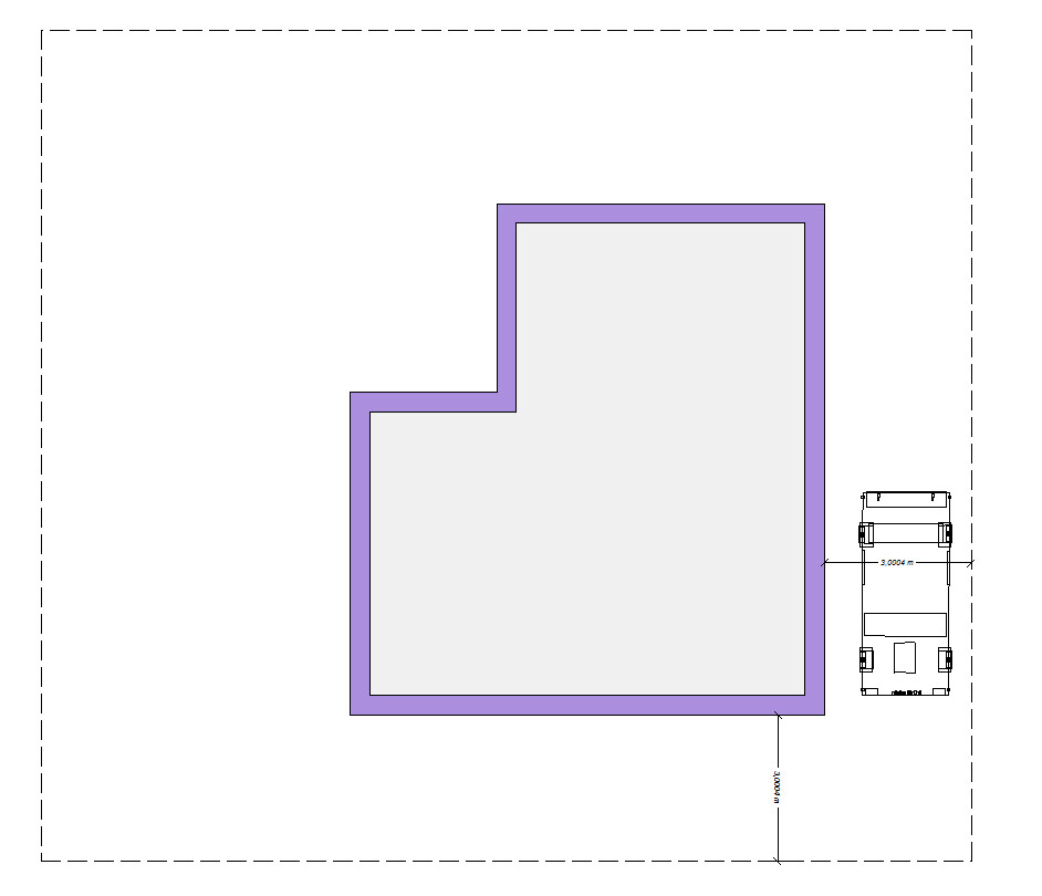

Building envelope, building line and boundary: see site plan; 3 m (approx. 10 ft) on three sides, less on street side due to protected green strip with fruit trees (not our property); open building style
Edge development: no (usually allowed for townhouses, but specifically excluded for carports and garages in the development plan); edge development allowed for uncovered parking spaces

- Site plan assumed by the builder

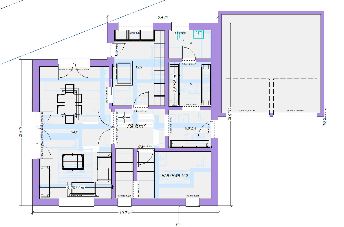

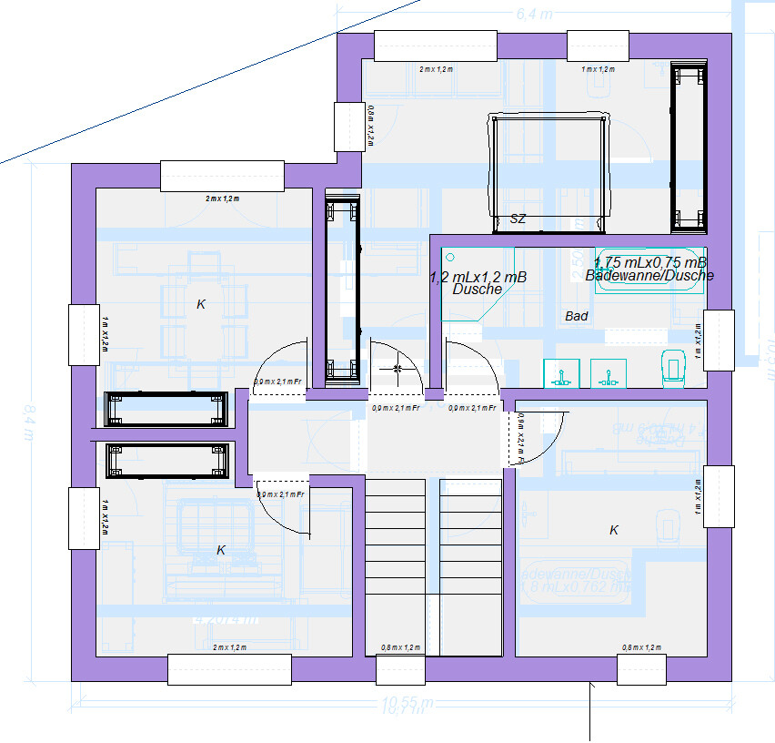

- Builder’s planning (floor plans, section, exterior view)
- Our modified floor plans based on the builder’s draft (larger living/dining area, smaller kitchen, different basement stairs)

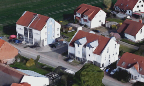

Escroda schrieb:
Here are the neighbors as seen by good old Google:
Those are some sizable houses next door.

I'll throw in the floor plan of the Marlow SH 160 XXL.
It's a bit longer, with a gable roof, no basement, no tower, all rooms included. The width is an issue, if you ask me. At almost 13m (43 feet), the building plot is fully utilized (it should be about 19m (62 feet) wide). This means the terrace would already count as part of the boundary development.
If the parking space issue has been resolved according to the site plan and approved as permissible, I consider this approach worth considering:
