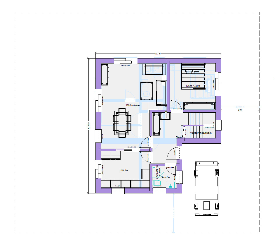

Hello everyone!
After reading here for quite some time (and checking out nearly all floor plan questions for similar lot sizes and building dimensions), we now have some questions about the preliminary design from our builder.
Our situation is similar to the forum post from Wednesday, but our main focus is on the basement J
This is the first draft based on a rough idea of what we envision and what is important to us (the design seems quickly done to me—see the projecting dormer—or is that common nowadays?), but overall all our requests have been considered. We see room for improvement especially in the basement level, the basement stairs/daylight wells, and the size of the living/dining area (probably only fixable with a larger house footprint). The upper floor works well for us.
Independently from the builder, we came up with a similar floor plan that meets our needs; it is nothing “special” but fits our ideas well.
We would appreciate it if some of you could share practical tips or suggestions for changes so that we can respond to the builder and discuss possible deviations.
Feel free to be thorough and please also point out any potentially major planning mistakes.

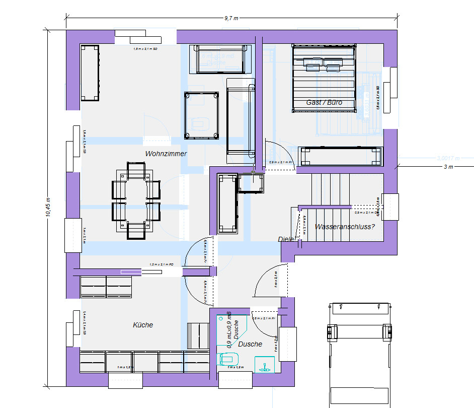

Planner: planner from a building company; the second attached version is our own adjusted “solution” with the house widened by 0.5 m (approx. 1.6 ft) and furniture drawn in the living/dining and bedroom areas which we already own.
What do you especially like?: the solution with a coat area and shower niche on the ground floor, the stairs, level, masonry showers, spacious children’s rooms, fireplace location between living and dining areas, large home office/guest room in basement, where both “uses” can be nicely combined.
Why?: we had not thought of the coat and shower concept in the floor plan ideas, find it practical and reasonably age-appropriate (though the dimensions could be slightly wider), and had no clue where best to put a fireplace.
What don’t you like? Why?: living/dining area too small, at 22 m² (237 sq ft) we cannot fit our furniture, kitchen is too large, we don’t need a separate seating area in the kitchen (we currently eat all meals in the dining area), the exterior basement stairs with the bend take up too much space, and we don’t want a carport as it would have to be inside the building zone (uncovered parking is allowed as edge development), the concrete daylight wells in the basement.
Price estimate from architect/planner: not yet available, initial rough offer before planning (130 m² (1400 sq ft) with basement) was 315,000 including standard ancillary construction costs, but with a “standard basement”; we might need a waterproof concrete shell (“white tub”), estimated extra cost about 20,000 according to the builder
Personal price limit for the house: 340,000 (furniture is already owned from current large apartment (126 m² (1356 sq ft) living space), kitchen belongs to us and only needs minor changes, cost covered separately)
Preferred heating technology: we considered a ground source heat pump, but the builder has had problems twice in the building area with insufficient supply temperature and therefore recommends an air-to-water heat pump on the south side of the house. Has anyone had experience with this?
If you have to give up something, what details/features?
Can give up: dormer, large kitchen, fully heated basement
Cannot give up: basement (due to small lot and 3 children planned), bedroom on ground floor, bathroom with shower on ground floor
Why is the layout the way it is now?
Draft from planner after a brief initial discussion about our preferences (we did not provide a detailed list of requirements)
Which wishes were implemented by the architect? bedroom on ground floor, bathroom with shower, staircase design, bathroom with shower and tub on upper floor, basement with office
What do you think works well or poorly? we like the overall distribution of floors, but are not yet convinced by the basement layout.
Any ideas to improve the basement (e.g., no bent stairs, maybe no basement hallway at stairs, maybe no daylight wells)? Any improvements for other floors (e.g., larger living/dining area)? Is there any place to add a laundry chute (nice to have but not essential)?
We look forward to your ideas and feedback J

AnniSke schrieb:
No question, I also like light and windows when working.I was specifically talking about changing the view but forgot about your age. Paying attention to prevent "eye strain" might not yet be a conscious issue well under 40 (my vivid memories of such young years are fading). Possibly, due to my profession, I am more focused on ergonomics and workplace health. But it wasn’t so much about it just being nicer.kaho674 schrieb:
The 3m (10 feet) on the right are off-limits.AnniSke schrieb:
As long as it’s covered and only used as a parking space, that is allowed...I’m confused (?). I think an additional attic space was forgotten to be marked here, and I don’t see any valid reason against it. @Escroda: wouldn’t it be "unfair" if a parking space is allowed where a house-attached terrace is not permitted?AnniSke schrieb:
Probably on the first floor in the bay window or next to the stairs, right?I haven’t spotted a utility room yet, and definitely no technical room—what would the latter be for there anyway?Altai schrieb:
The house has external dimensions of 7.0 x 10.5m (23 x 34 feet), meaning about 74m² (800 sq ft) of space is “used up” here. It has a ground floor, an upper floor with knee walls about 1.30m (4 feet 3 inches), and a 45° gable roof, so there is also an attic available for storage.Have you actually introduced this in the forum before?Altai schrieb:

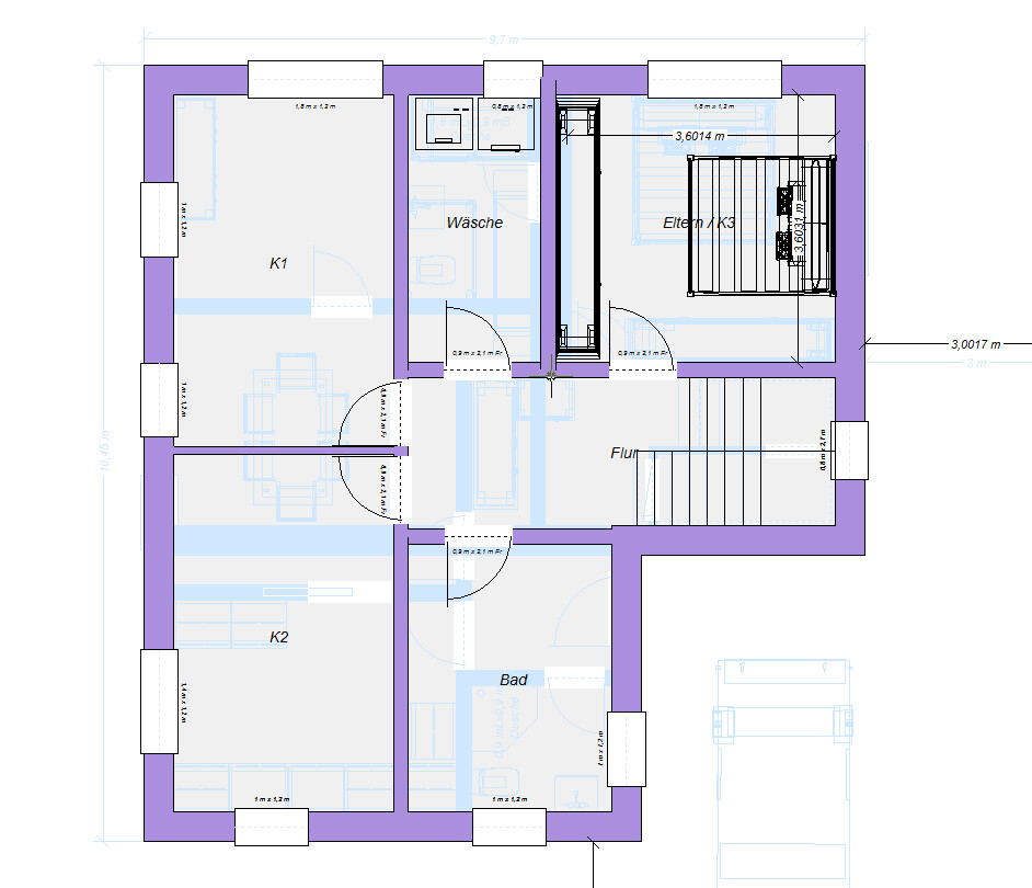

Just a quick attempt:
(Stairs as usual without landing – normally a half-turn)
I'm not entirely sure if this still counts as two stories. Knee wall planned at 1.80m (5 ft 11 in). But I think so, right? Does it qualify as a gable-end house? Funny.
Oops, the door to the workshop got smashed – please keep that in mind.
