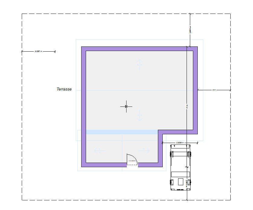

@Escroda Apart from that, would something like this be possible in terms of eaves orientation (regardless of size, etc.)?
Two-story house with a side extension, gray facade, black roof; red car in front.
Floor plan of a building with a terrace, dark purple exterior wall and entrance area.
If it were only 2 stories, what would be the maximum allowable width of the front gable?

kaho674 schrieb:
No, as I read it, you’re not even allowed to have a parking space within the 3m (10 feet) setback on the right side.
It’s unusual, but as it’s worded, parking spaces are permitted on the street side. Since the area beside the house is not street-facing, they wouldn’t be allowed there. I don’t see the point of this regulation, so it might be worth checking with the city planners for clarification.
kaho674 schrieb:
Would something like this be possible regarding eave orientation?
As long as there are no further design requirements, yes.
