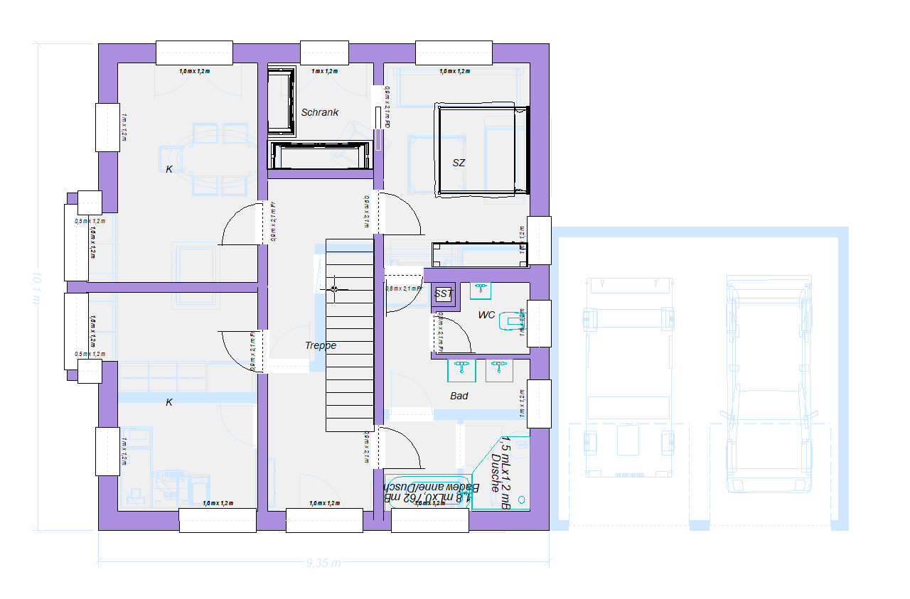

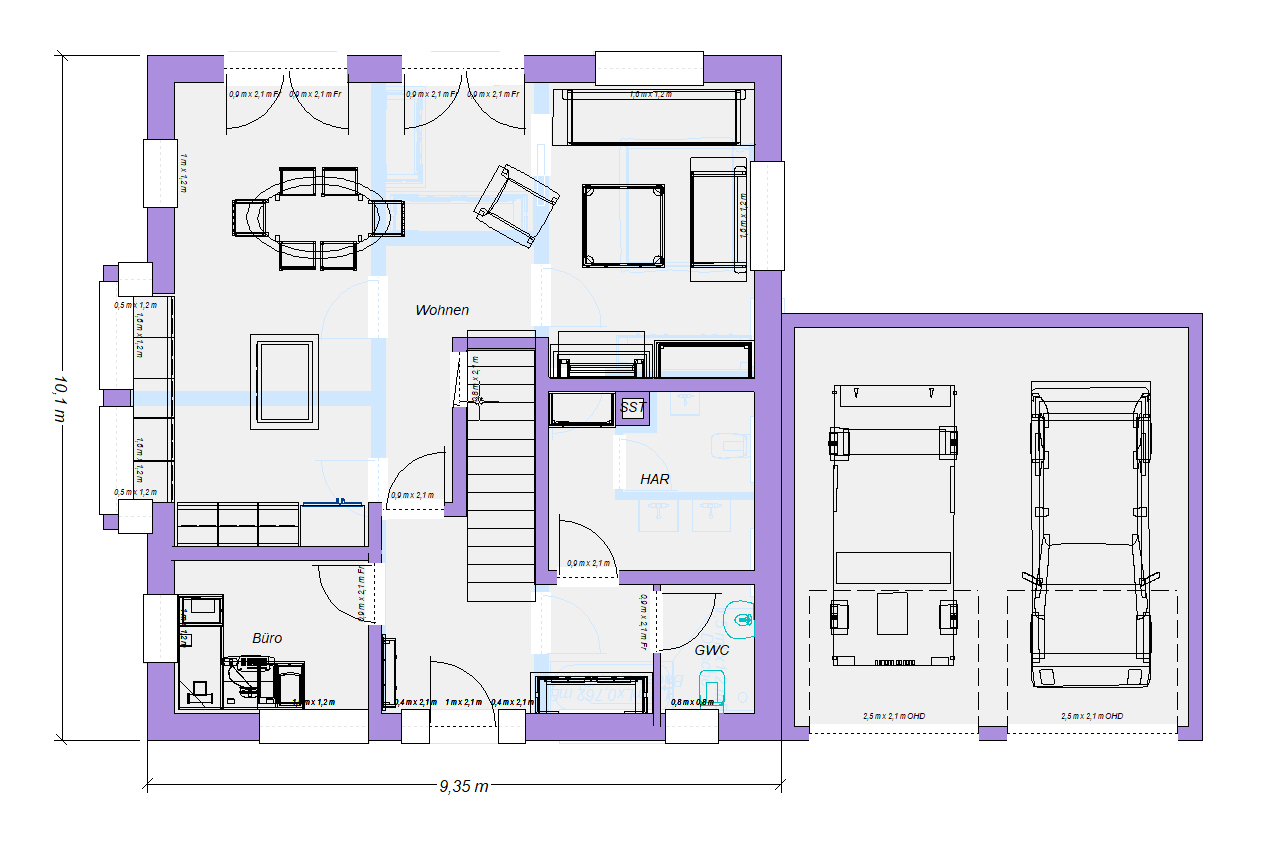

we need help or suggestions to optimize the floor plan.
What could be improved in this floor plan?
We definitely want a straight staircase on the ground floor and a pantry under the stairs for the kitchen. Since everything is centered around the staircase, we have currently created the following design.

hanghaus202321 May 2026 09:51Here is another suggestion. The upper floor layout could also follow your proposal in #41. I just wanted to offer an alternative for a quick route to the bathroom.
Otherwise: If you want a fireplace, make sure to draw it to scale to avoid any disappointments later on!
The fact is, the straight staircase limits you significantly and is not suitable for a house of this size.
