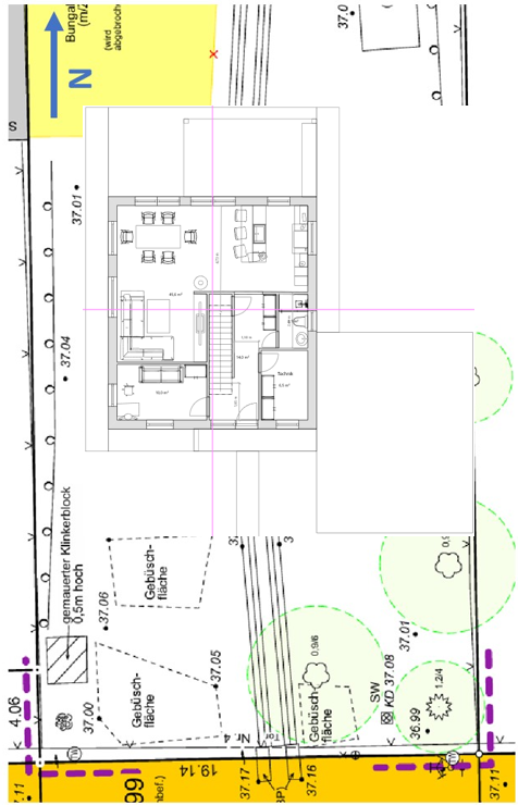

The terrace is located on the north side of this property.

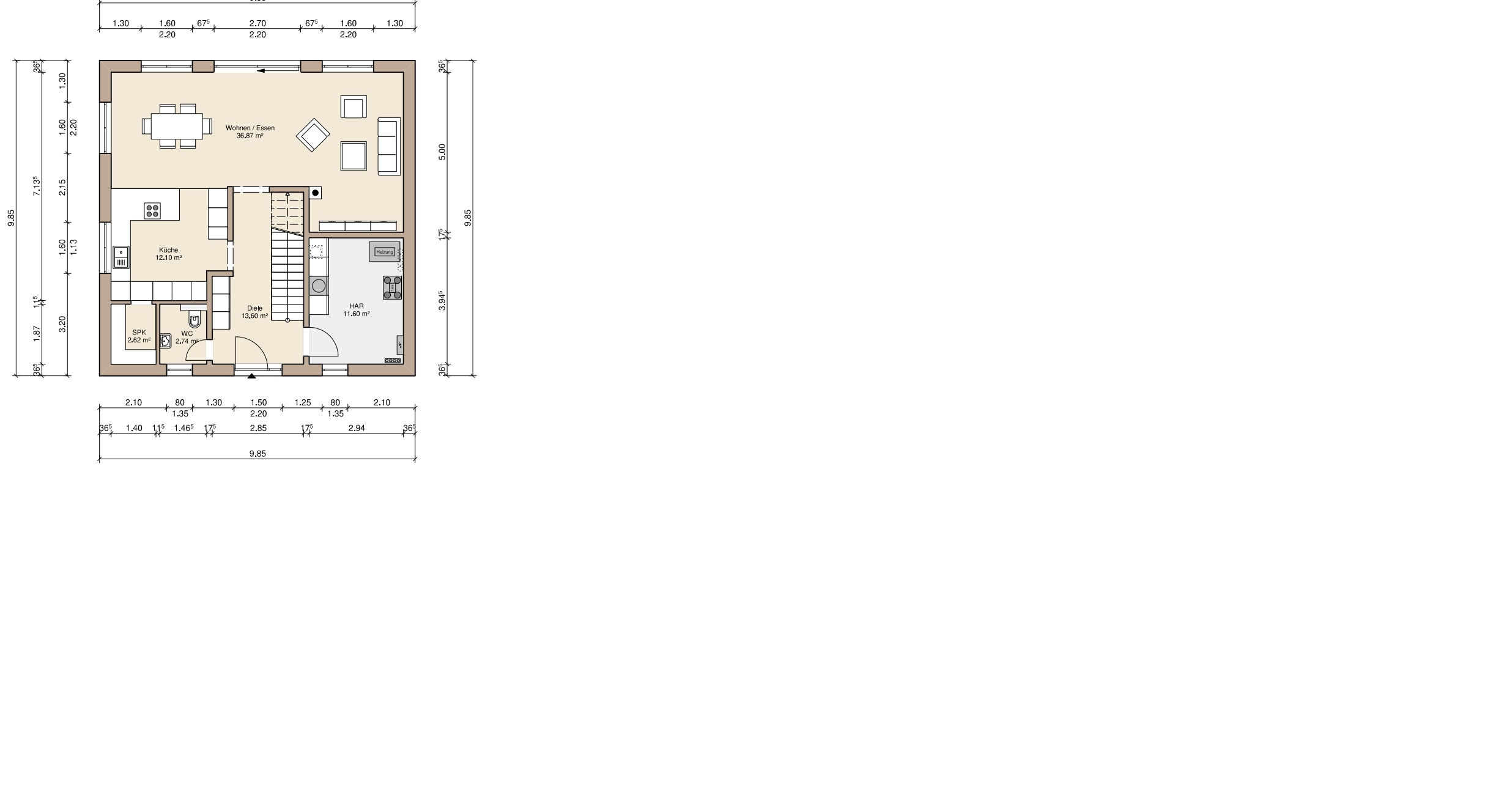

Here’s another attempt to improve your floor plan.

hanghaus2023 schrieb:
Here is another attempt to improve your floor plan.
Thank you very much for the floor plan. We like it very much so far.

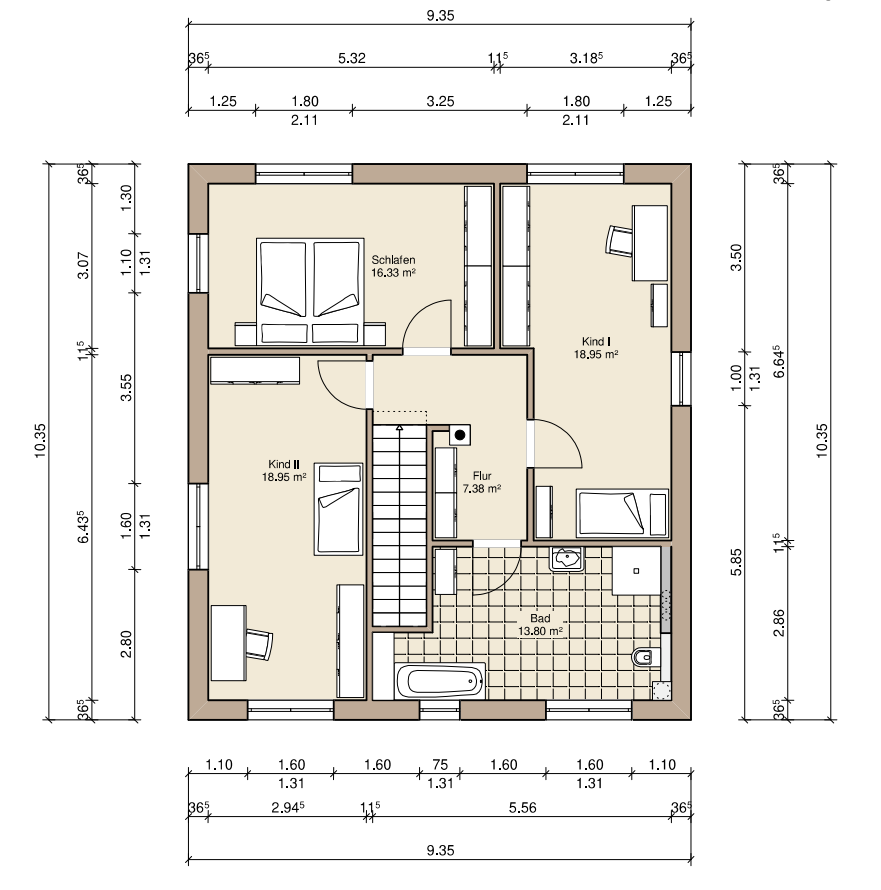

hanghaus2023
20 May 2026 16:19
The cloakroom is a bit too small for me, but I can’t find a solution. You can still allow for 1 meter (3 feet 3 inches) in the storage room under the stairs. That might be enough.

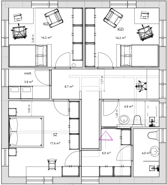

Here is the upper floor plan.
Unfortunately, my software does not show the staircase. The stairs end at the marked 1.27 meters (4 feet 2 inches).
Alternatively, a large bathroom of about 14 m² (150 square feet) is also possible.

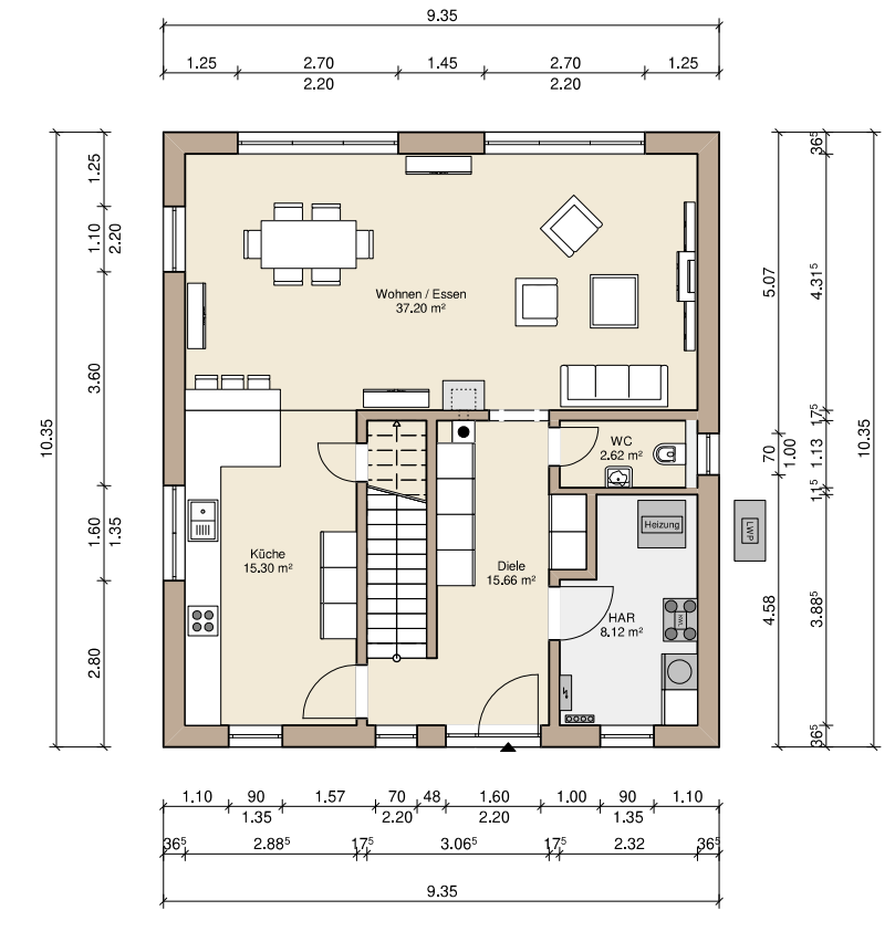

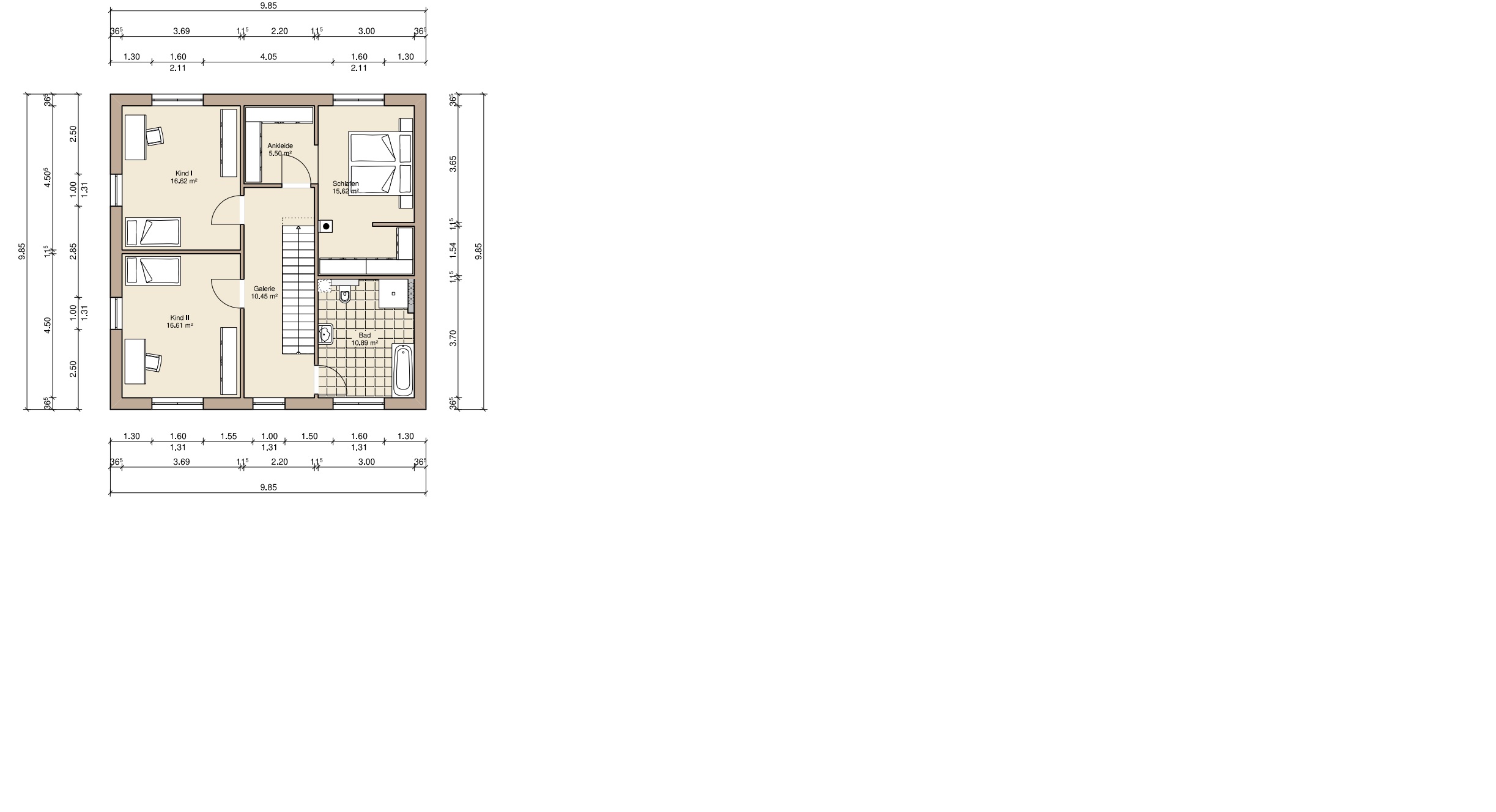

Thank you for the additional ideas and inspiration. We also have another design. What do you think of it, and what could still be improved?
