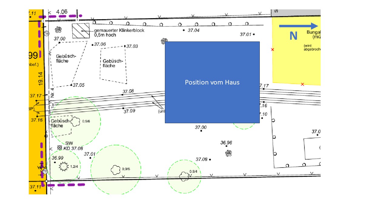

Steve123
16 May 2026 10:56

Here is the site plan:
The plot is 20 m (66 ft) wide and 70 m (230 ft) long. In the neighborhood, there are urban villas and bungalows.
