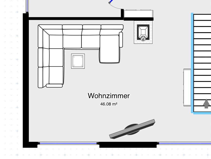

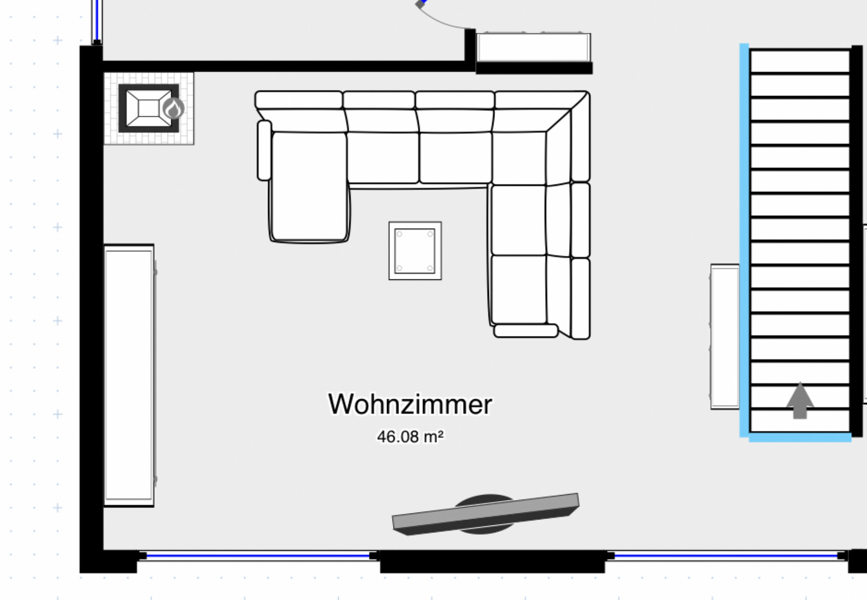

I traced the architect’s plan roughly and made some changes to the floor plans. The following adjustments were made:
- I replaced the large shower with a corner shower and reduced the shower area, converting the remaining corner into a built-in closet. This allowed me to move the kitchen slightly forward. I adjusted the storage room accordingly. The space gained was used to move the dining table closer to the kitchen. The small corner next to the dining table and kitchen (marked with a blue line) was intended as a small cloakroom to store items like slippers or vests for quick trips to the terrace (since the main entrance is in the basement).
- I reduced the office width from 3 meters (9 ft 10 in) to 2.9 meters (9 ft 6 in) to increase the living room width to about 4.8 meters (15 ft 9 in). I might reduce the office size further? (The original office layout is no longer visible in the pictures.)
What are your thoughts?

Was the fireplace always planned there? No.
I think it’s completely unnecessary in the corner. That’s something they used to do with tile stoves... anyway. I prefer version 2 for everyday living. I would place the sofa along the top wall and the TV on the bottom wall. If you still need a cupboard, there’s space left along the left wall. What do you have that needs so much storage in the living room? I moved the fireplace out of the middle of the room. Somehow, we always found it disruptive when arranging the furniture there. Also, it’s a bit more practical for us to position the chimney flue on the exterior wall.
We don’t have much stuff in the living room. But as usual, a lot still needs to be stored, so the large built-in cupboard in the hallway seemed quite useful to us.
Placing the TV on the bottom wall will be difficult. We don’t want to change the windows anymore because A) the view from both windows is really great, and B) the building’s appearance would suffer a lot from such a change.
Kati.com schrieb:
I also prefer version 2. For me, the dining table belongs in the kitchen area, not the living room.
I think the sofa is well placed. I like when the backrest serves as a sort of room divider.
In version 1, the dining table is way too far from the kitchen for my taste. Okay, it’s clearly leaning towards version 2. I kind of expected that.
I will probably shave off a few centimeters from the office to get a little over 5 m (16.5 ft) in the living room.
Thanks for the feedback.
bowbow91 schrieb:
Mounting the TV on the wall at the bottom of the plan will be difficult. We actually don't want to change the windows anymore, ? You do have a wall there. I would place the TV exactly on that wall.
? You have a wall there. I would place the TV exactly on that wall.But then the TV would be quite off to the side, wouldn’t it? Depending on the fireplace’s position, you might have to angle the TV quite a bit.

bowbow91 schrieb:
But then the TV is positioned quite off to the side, don’t you think? Depending on the location of the fireplace, you have to angle the TV quite a bit.True. But do you sit on the sofa like in cinema seats?N
nordanney14 Apr 2021 21:55bowbow91 schrieb:
But the TV would be quite off to the side then, don’t you think? Depending on the position of the fireplace, you’d have to angle the TV quite a bit.There are nice swivel wall mounts available for that.Similar topics
