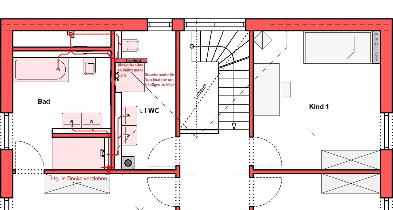

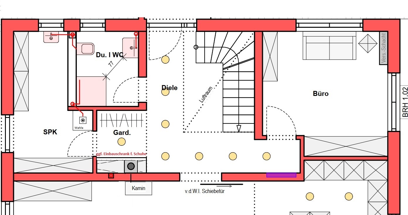

we are currently working on optimizing our floor plan and hope to get some good advice here.
A special focus is on the fireplace, which still does not meet our expectations. We would like to move the fireplace further east so that it is better positioned between the living room and dining room.
This would create a nicer room atmosphere and highlight the fireplace as a central feature between the two rooms.
The problem is that the chimney stack on the upper floor would then block the closet space in the master bedroom and also obstruct the door.
We are facing the challenge of finding a solution that considers both the fireplace on the ground floor and the room layout on the upper floor.
Does anyone have ideas on how we could solve this problem? Perhaps by relocating the doors or redesigning the hallway?
Maybe you have had similar experiences or creative approaches that could help us.
I look forward to your suggestions and feedback! I am attaching the floor plan so you can get a better idea.

Our general contractor refused to integrate a chimney within the wall at that time, saying it would cause cracks. We would have preferred to have it in the wall as well, but since this wall (ground floor) is load-bearing, the architect also told us that it was not possible.

Today, I mentally redesigned the shower bathroom and hope the architect will confirm on Monday that this plan is feasible. This way, the chimney will be concealed within the shower bathroom and inside a built-in closet.
I’m looking forward to it..

Bertram10025 Aug 2024 06:59HomeSweetHome1 schrieb:
Where exactly do you think the so-called amateur planning is? The entrance area with the cloakroom is terrible. You usually only accidentally trip over the first step when leaving in small terraced houses while trying to move children away from the door. I find it hard to understand that you want it like this in such a large house.
