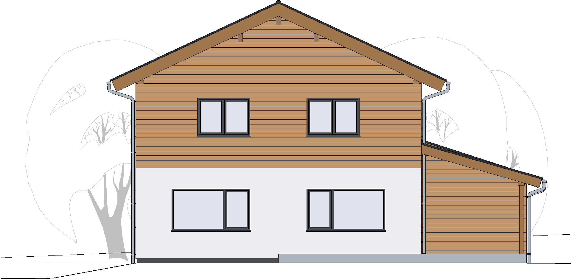

we (30 & 33) have been working on our house-building project for about half a year now and have been in talks for several weeks with a great local carpentry company that builds timber frame prefabricated houses. We had fairly clear ideas, and from these, the company created the attached floor plan. To make sure we haven’t overlooked anything, I’m putting it in your capable hands to point out any weaknesses.
A big thank you in advance to everyone who takes the time—we’re looking forward to your suggestions and critiques!

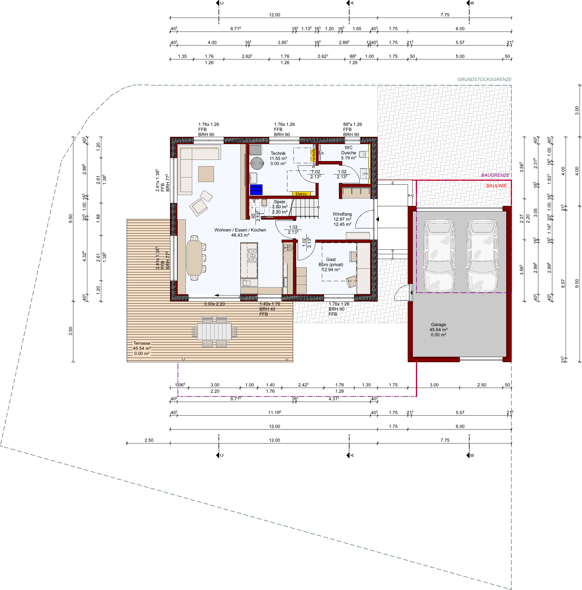

Ground floor plan:

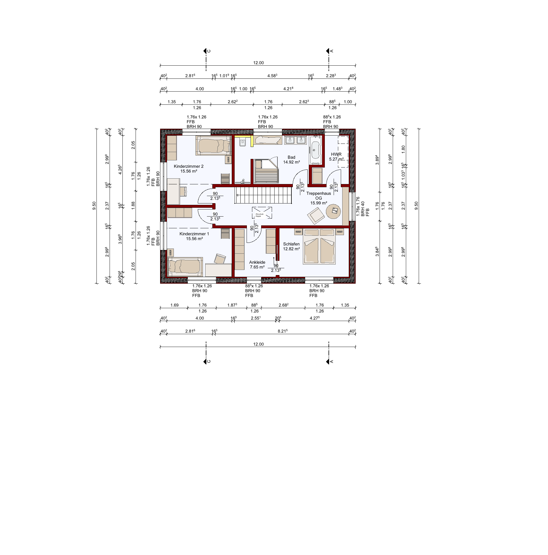

Upper floor plan:

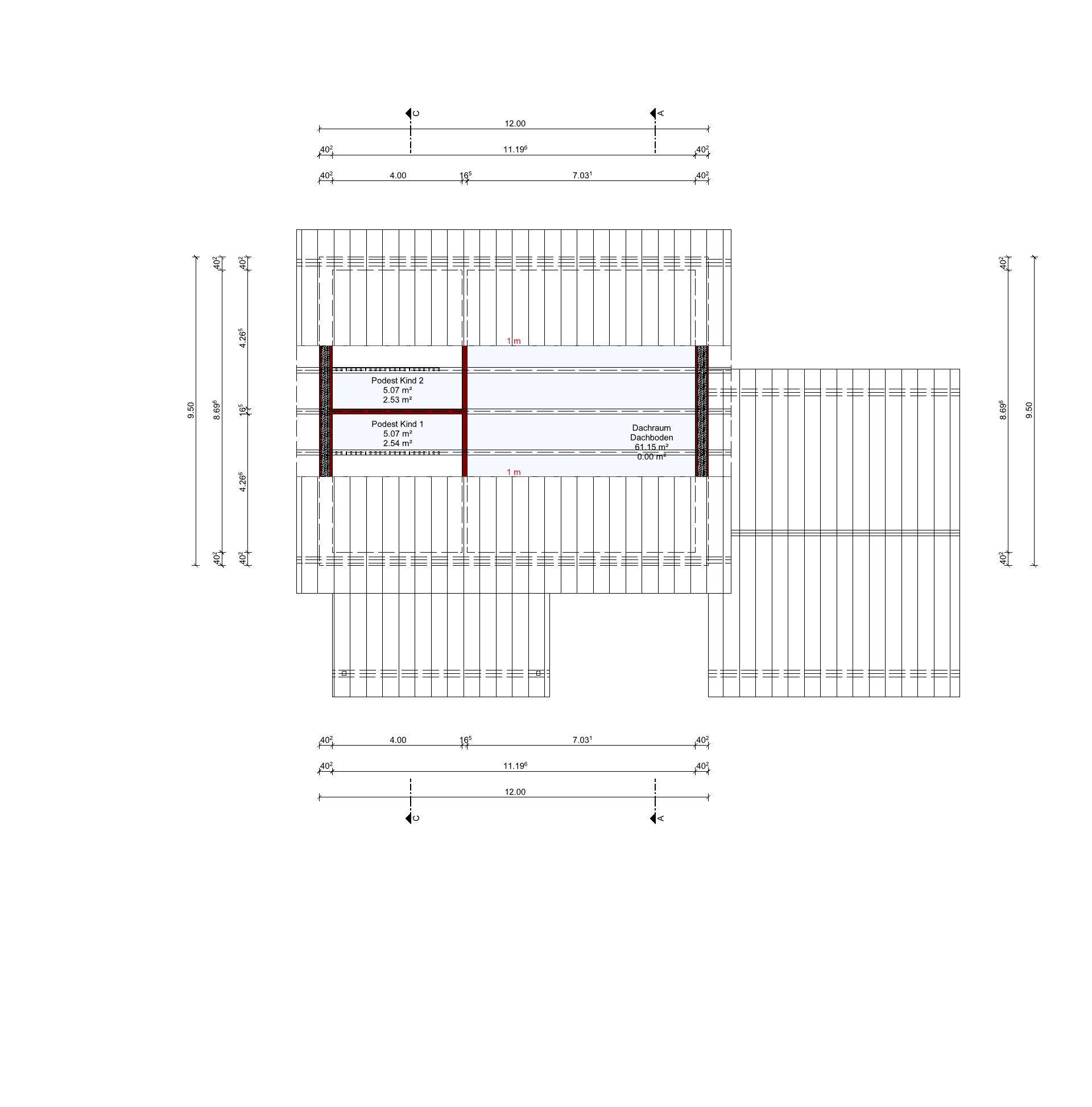

Attic floor plan:

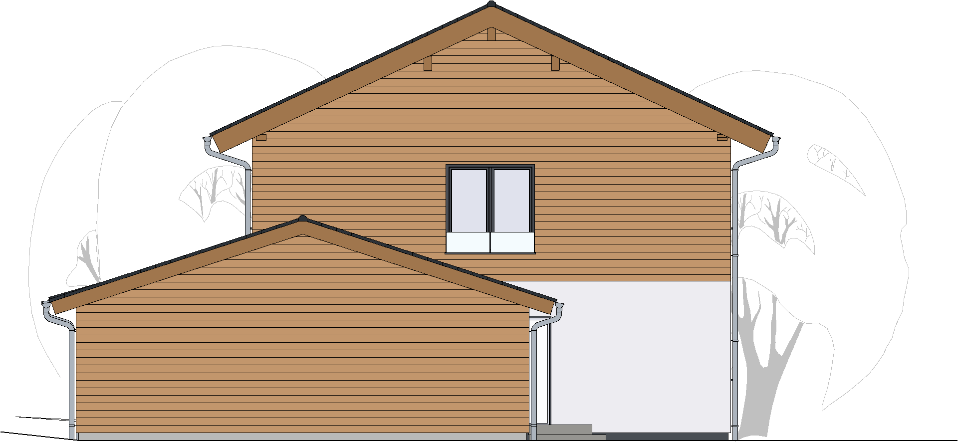

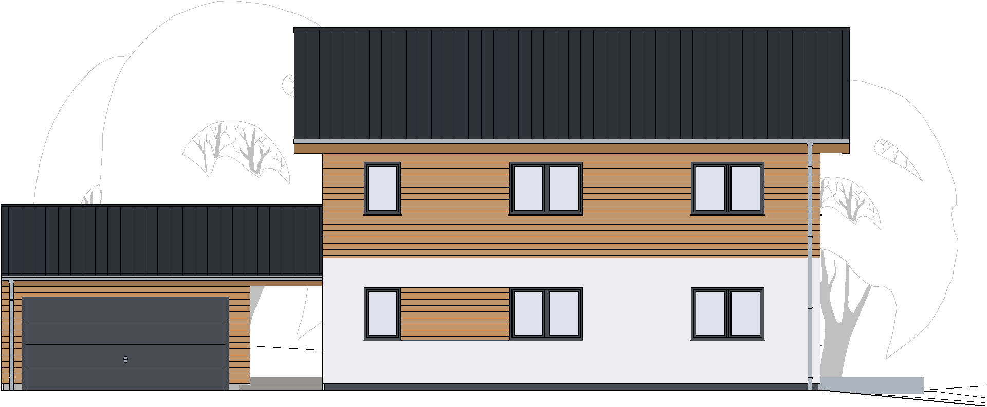

Northwest view:
Northeast view:
Southeast view:
Southwest view:

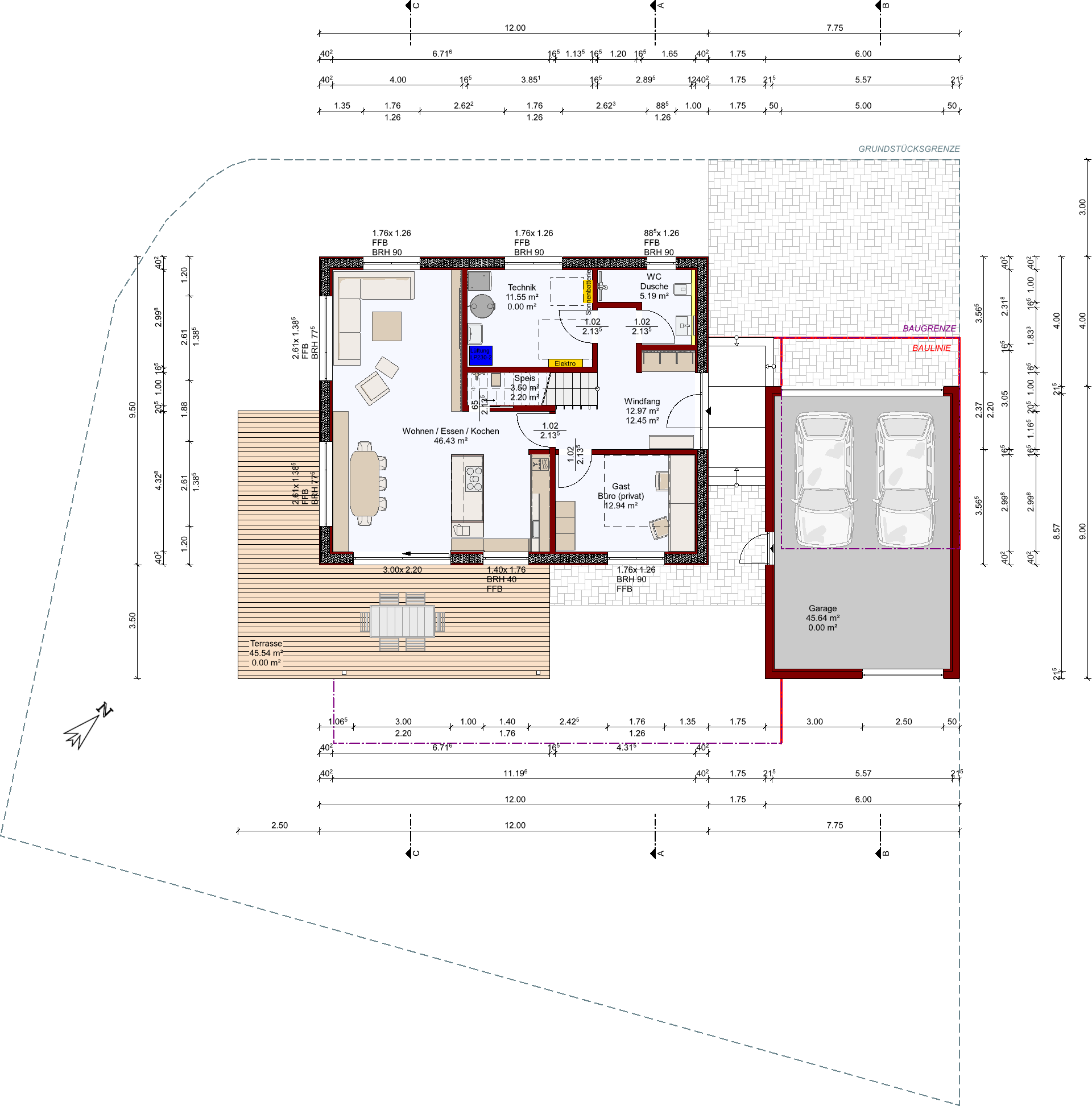

Ground floor plan:
Upper floor plan:
Attic floor plan:
Northwest view:
Northeast view:
Southeast view:
Southwest view:
cbauthaus20 Feb 2026 15:57Thank you for your initial feedback!
I can’t find a way to edit my post right now, so here is the ground floor plan with a north arrow:
The highest point is in the southeast corner, and it slopes down from there in both directions to street level.
Yes, that’s exactly the bench in the kitchen I meant by seating window.
We hadn’t realized or been aware that it’s more difficult to furnish rooms under 3 meters (about 9.8 feet) wide, we will keep this in mind.
The same applies to the garage; we hadn’t noticed it was quite narrow either, thanks for pointing that out!
The utility room is intentionally planned to be this large, as it should also serve as storage for items like rubber boots, crates of water, etc. We will take another look at the size of the open-plan area and kitchen, and whether we can take some space from the office, thanks!
We haven’t specified anything yet; I suspect the drawing shows a crate for drinks and a wall-mounted vacuum cleaner.
The view is okay but not particularly special. The seating window was mostly added because a larger window was needed there anyway to bring enough light into the hallway, and we hope the children might use that corner as an additional play area.
Good point, we hadn’t yet considered the direction of the beams, thanks!
Based on the fairly unanimous feedback, I can already see we need to rethink the kitchen (and the seating window) a bit.
We will also take a closer look at the galleries regarding stairs/ladders, lighting, etc.
hanghaus2023 schrieb:
Which direction is the slope going?
Could you add a north arrow to the plan?
nordanney schrieb:
Just a quick question: What exactly is a seating window and where can I find it in the kitchen? Is it the window with the low sill and the bench in front of it?
I have a seating window bench myself, which nobody really uses anymore.
In my opinion, a major weakness is the width of the areas at the bottom of the plan: less than 3 meters (about 9.8 feet) means only 2.80 meters (9.2 feet) are available for the kitchen. Standard cabinets won’t fit either, same for the office and bedroom/dressing room. A cross wall should offer about 310 cm (10.2 feet) of internal space for these rooms to fit standard furniture properly.
It’s too narrow by today’s standards.
MachsSelbst schrieb:
The kitchen would still benefit from gaining some space from the office. 8 or 9 m² (about 86 or 97 square feet) is enough for an office.
The utility room is too large as well. The open-plan area including the kitchen is actually quite small for this house size at 45 m² (about 484 square feet). That’s where one tends to spend most of their time...
familie_s schrieb:
Pantry: What kind of connections are planned there?
familie_s schrieb:
How is the view from the seating window? Will anyone really sit there? But I wouldn’t want to give up the window because of the light.
familie_s schrieb:
Retractable staircase: possibly rotate it 90° and place it over the seating area or in the dressing room. Depending on the ceiling beam direction, that might simplify installation.
hanghaus202320 Feb 2026 17:39One additional note about mezzanines. We installed them in all three children’s bedrooms, but significantly larger than yours. They were used as a Lego play area, a drum room, and occasionally for the children’s guests. Good ladders or stairs are necessary, as well as fall protection.
Our children never slept up there; they preferred to sleep downstairs in their rooms with windows to have a view outside while falling asleep.
Please design the access so that a vacuum cleaner can also be brought up there. Unfortunately, cleaning is still necessary from time to time. If the beds are actually planned to be up there, please consider that changing the bedding requires adequate headroom. A sleeping nook looks nice but is often less practical in daily use.
Keep light switches in mind so that the lights upstairs can be turned off from downstairs and vice versa.
