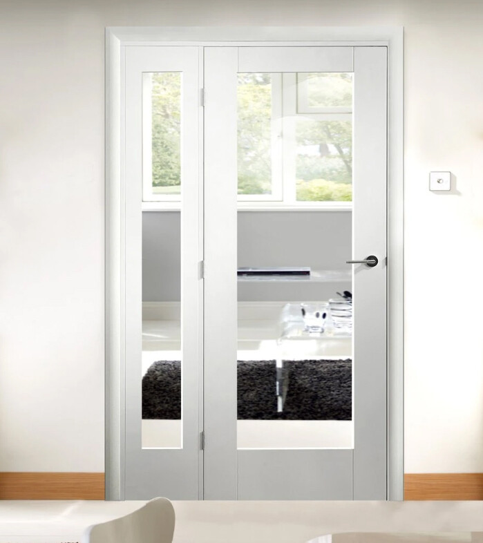

I would leave the door as it is. Our kitchen door also opens into the hallway rather than into the kitchen. It stays open most of the time, but when my partner is cooking, I’m often glad I can close it. I don’t see this as an unacceptable break in style. To allow more light into the hallway, you could add a fixed glass panel next to the door (let’s see what the door manufacturer offers). It would probably look something like this. As for the door hinge position—or whether there even needs to be one—you’ll have to discuss that with the door builder.
