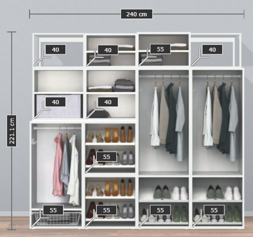

Tolentino schrieb:
With PLATSA, you can divide the space very nicely.
At the bottom, a shoe cabinet, above that shelves/drawers, then a “top section wardrobe,” and at the very top a shelf for hats or items you don’t use very often. Everything is very flexible in terms of layout. Also adjustable left or right, deeper, shallower, etc. For example like this:
On the left from 120cm (47 inches), 15cm (6 inches) less depth and without doors as additional shelving...
[IMG alt="Platsa_240.png"]https://www.hausbau-forum.de/data/attachments/45/45920-5cd78c22d465c5cadab37f90dba83231.jpg[/IMG]

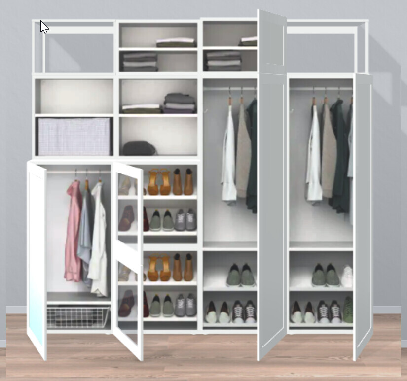

With doors:
[IMG alt="Platsa_240_türen.png"]https://www.hausbau-forum.de/data/attachments/45/45921-fb20c973fe538446eaad7dd0c9cda232.jpg[/IMG]
Exact combination according to the configurator costs 610 EUR.
Alessandro5 May 2020 14:24However you plan the closet, a surface for placing keys and similar items is a must-have for me. A chair or a bench to sit on while putting on shoes is also a good idea.
