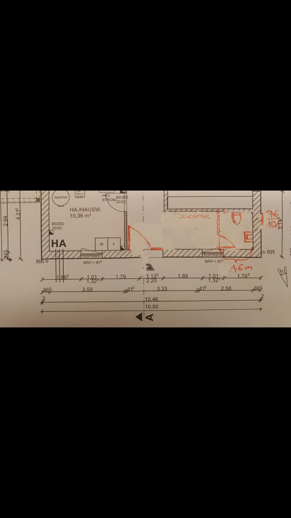

I wasn’t satisfied with the entrance area. I’ve decided to include a window in the cloakroom after all. I could also use the window as a decorative feature.
Would you do anything differently there?
I will have 2.5m (8 feet) of space for wardrobe cabinets. So, I could create something nice with Ikea Platsa or Metod.
