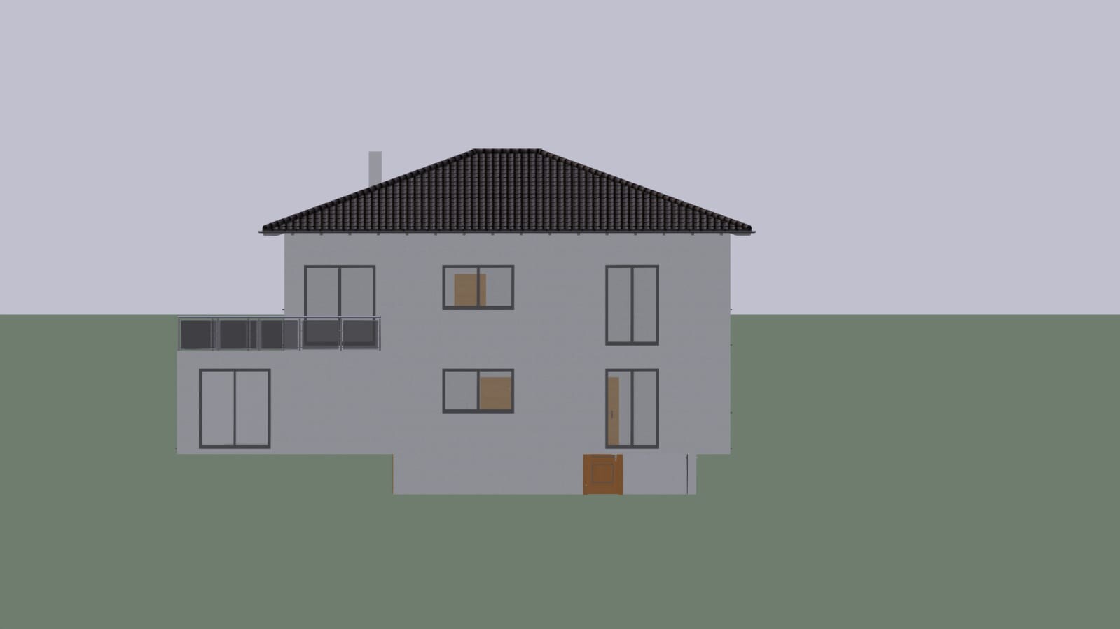

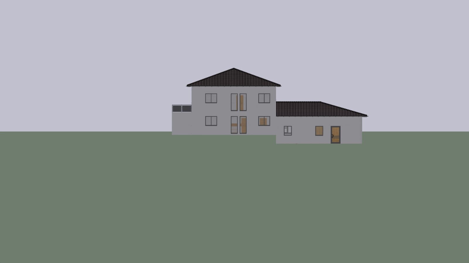

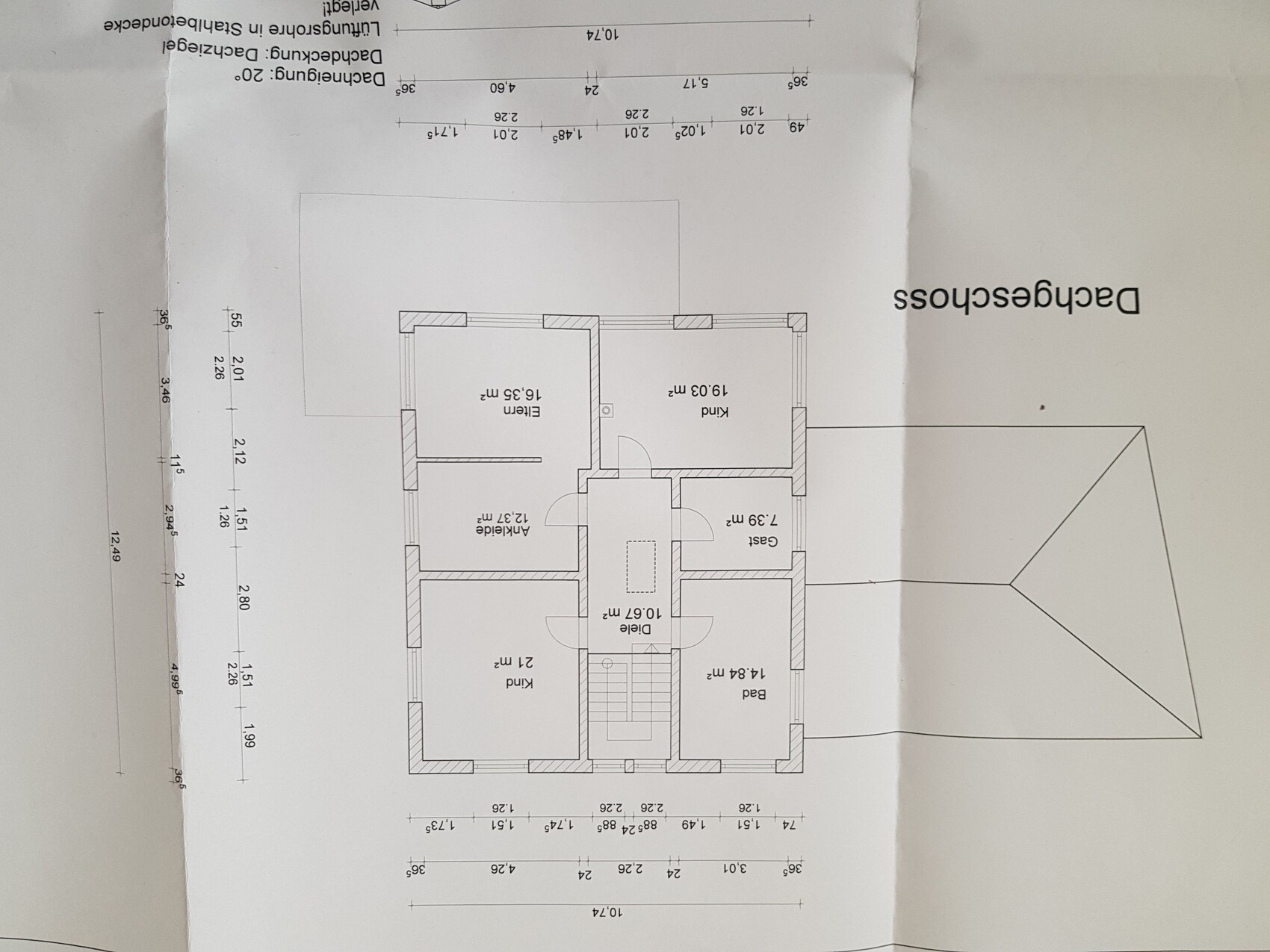

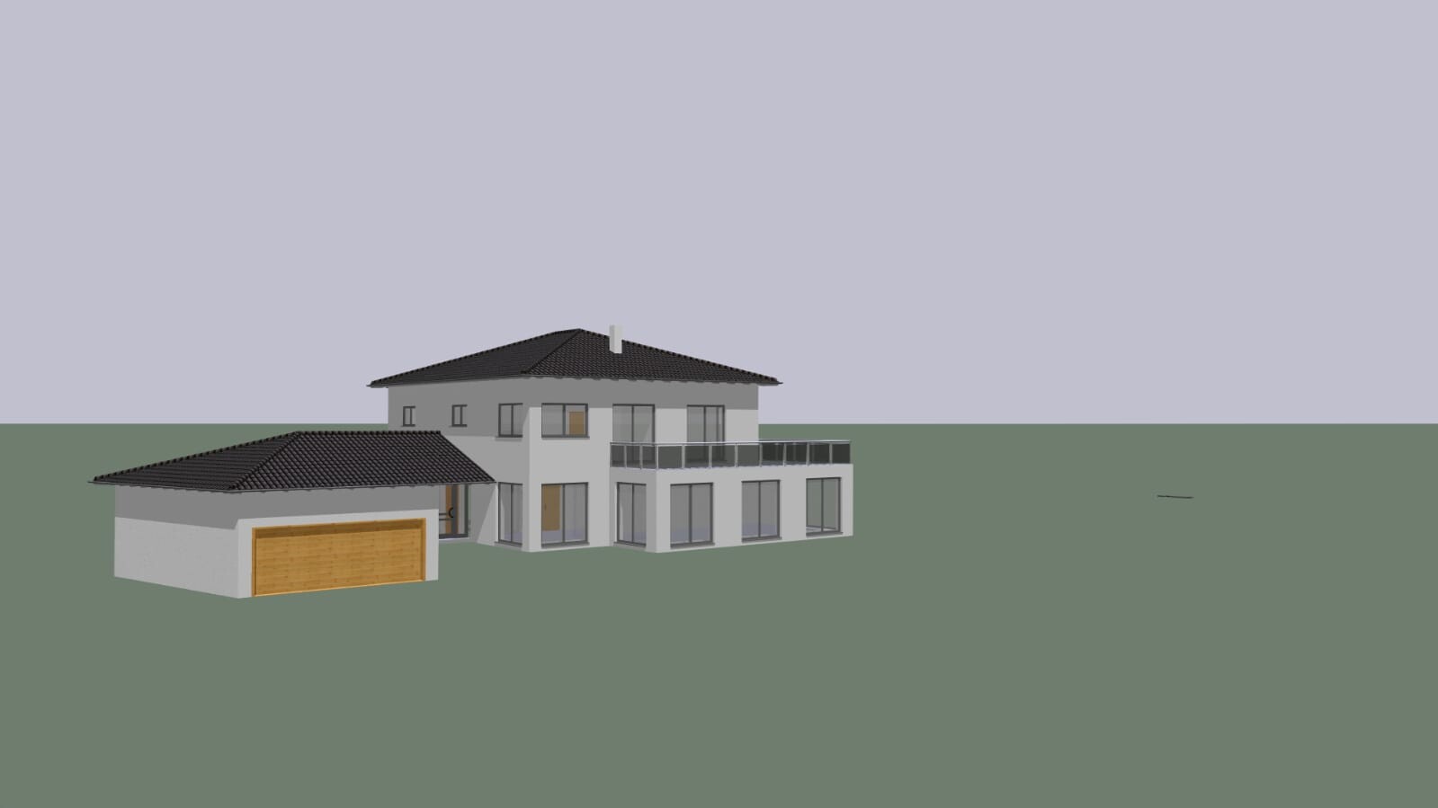

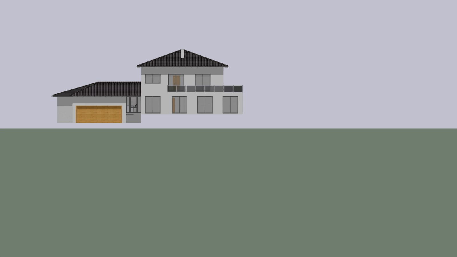

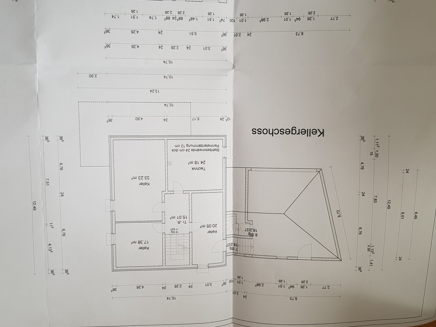

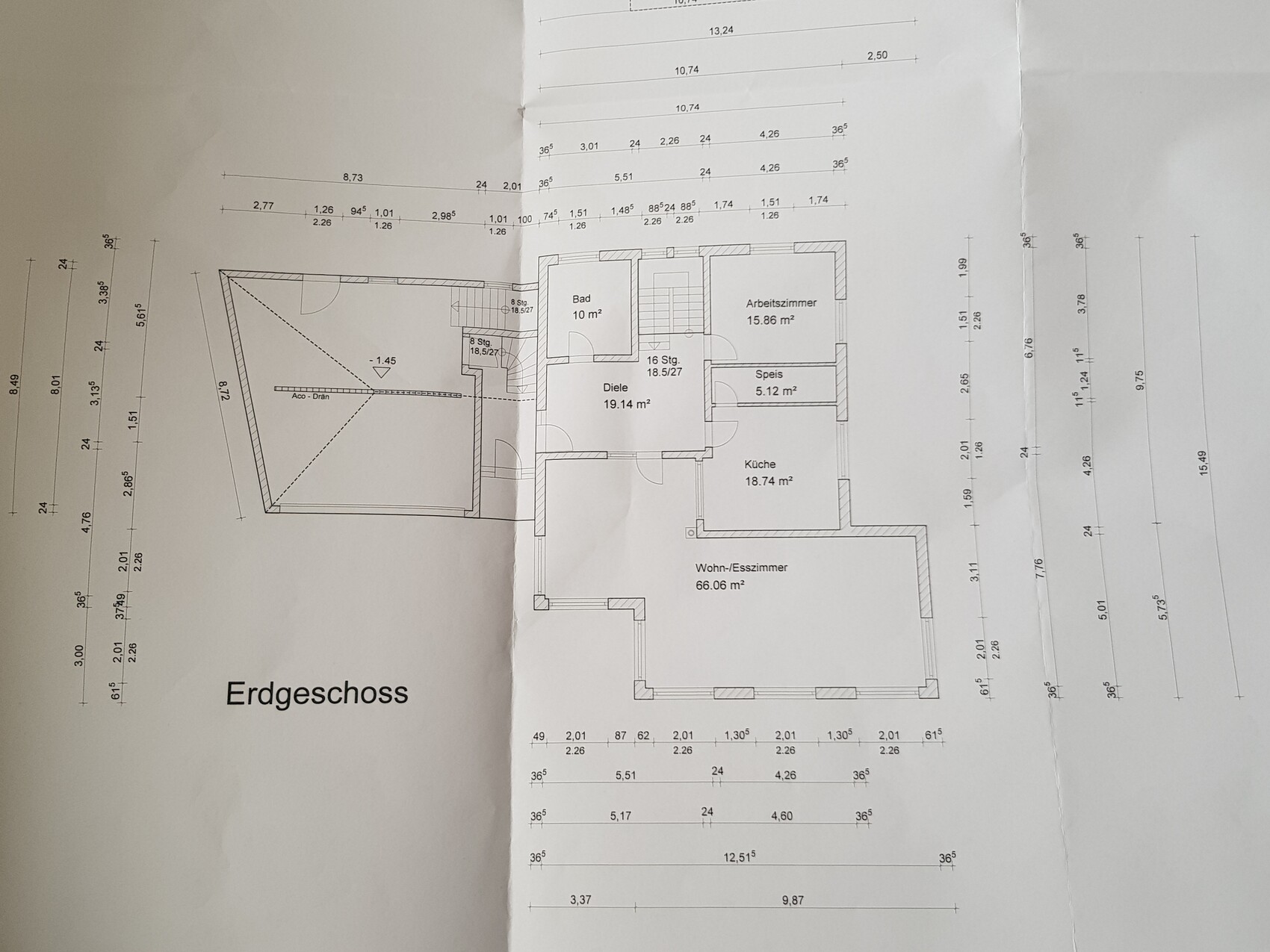

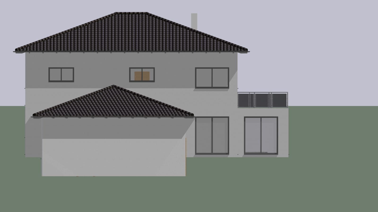

We are currently in the planning phase for our house. We have read a lot and gathered many ideas. However, I constantly feel unsure if I might be overlooking something. So, I urgently need help. I have attached the floor plans.

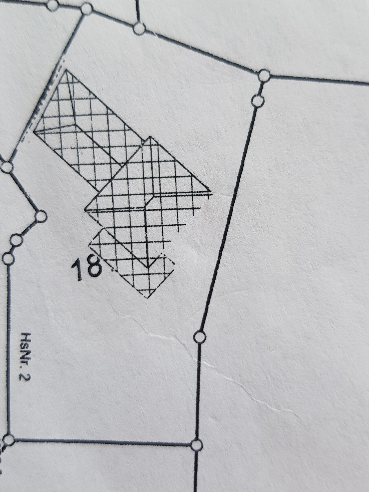

Development Plan/Restrictions
Plot size: 1120m² (12055 sq ft)
Slope: slight
Site coverage ratio:
Floor area ratio:
Building window, building line, and boundary:
Edge development:
Number of parking spaces: double garage and 2 outdoor parking spaces.
Number of floors: 2 full stories plus basement
Roof type: hipped roof
Architectural style: urban villa
Orientation: front faces west/southwest; terrace faces west/southwest
Maximum heights/limits
Additional specifications
Style, roof type, building type: urban villa, hipped roof, solid construction
Basement, number of floors: basement, 2 full floors
Number of residents, ages: initially 2 (mid-30s). In the future probably 4 (ages starting at 0)
Space requirements on ground floor: kitchen/dining room, living and dining room, bathroom, office, bathroom, cloakroom
Space requirements on upper floor: bathroom, two children’s bedrooms, master bedroom with dressing room
Office: family use or home office? Home office
Occasional overnight guests per year: mostly 2 people
Open or closed layout: closed layout
Traditional or modern design: both
Open kitchen, kitchen island: not open plan, with kitchen island
Number of dining seats: 4
Fireplace: yes, in the living room
Music/stereo wall: not planned
Balcony, roof terrace: yes
Vegetable garden, greenhouse: yes, after construction completion
Other wishes/special features/daily routine, including reasons for preferences
Who designed the plans:
- Ourselves in collaboration with an architect
What do you especially like? Why? The roof terrace and the related bay window. The arrangement of the windows, the large living area.
What do you not like? Why? I miss the cloakroom, I am unsure whether I should swap dining room and living room, do I have enough space for a wood stove
Estimated price according to architect/planner: 600,000€
Preferred heating system: geothermal heat via deep borehole
- Can you do without: too much smart home technology
- Cannot give up: roof terrace
Why was the design developed this way?
Looking at various show homes, friends’ houses, and considering what we both liked and, above all, disliked about our parents’ homes.
Simply to receive an objective opinion on our project

Alessandro4 May 2020 10:21What budget do you have?
Alessandro4 May 2020 11:33The garage is positioned lower than the house, which is why there are stairs. However, I don’t quite understand the reason for this. In my opinion, the budget, including the basement, is too low.
You don’t have a cloakroom, but you will definitely need one, and not a small one at that.
