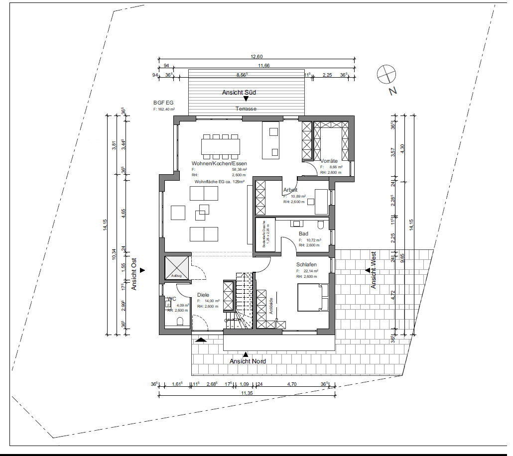

What do you like least? Why? We are still considering creating a niche for a side-by-side refrigerator in the office to have it flush with the wall. Possibly the same for the bathroom cabinets, since the bedroom is quite large.

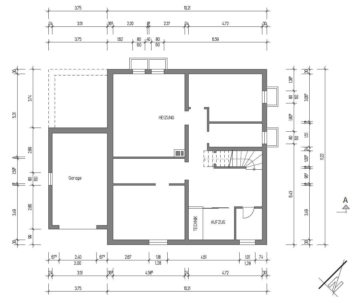

-Maybe I could move the office down to the basement. My wife gave up her walk-in closet for the office (now that’s love )

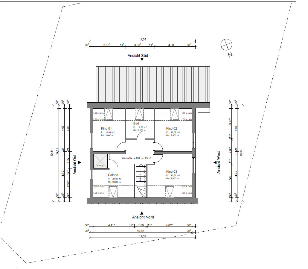

- Where can further optimizations be made?
- What window dimensions or sill heights do you recommend?
- What do you find poor or would do differently?
The office on the ground floor causes a lot of issues. As a result, the master bathroom is rather poor, and the kitchen feels very narrow. You have daylight in the basement. If it’s also dry, I wouldn’t hesitate. Love aside – maybe the wife would also like to have enough space to swim a bit in the bathtub, and the kitchen could definitely use more depth for a better sense of comfort.
For quickly using a laptop, you can still set up a small table in the bedroom. Even the bedside table would be sufficient for that.
The gallery on the upper floor is not really my preference. From my experience, such a corner only becomes a better dust collector and no one uses the space. I would place the bathroom there and significantly enlarge the children’s rooms.
