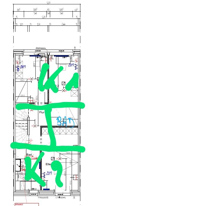

We have purchased a mid-terrace house from a developer and now need to finalize the floor plan for the room layout.
Right from the start: The layout of the house does not at all match our preferences, nor does the character of it being a mid-terrace house – but with current prices, this was the best we could afford... 😱 🙄 So please, no need to rub salt in the wound, we know there are houses with much better layouts.
Regarding the room planning, we believe there isn’t much that can be changed due to the elongated shape and the fixed window positions. Unfortunately, we don’t see many or any alternatives for the layout of the first floor, although the very narrow “corridor room” is a real problem for us. But maybe someone has an idea?
We have only considered partitioning part of the narrow room to create a storage closet, but that would be quite complex. Plus, vacuum cleaners and similar items could maybe just be stored in a closet inside one of the rooms?
As for the intended use of the rooms: initially, the rooms will be used as planned — two children’s bedrooms and the large room as the master bedroom. In a few years, we plan to move upstairs into the studio; the children will get the two bigger rooms, and the small room will become a study and guest room (where the vacuum cleaner, etc., could then be stored conveniently).
We appreciate any constructive suggestions and hope we haven’t forgotten anything (this is our first post in the forum).

What do you dislike? Why? especially one children’s bedroom is very narrow and corridor-like

RomeoZwo schrieb:
The only alternative I see to avoid the utility rooms is to move the parent area including the bedroom to the attic floor and use the upper floor as shown in the sketch...
[ATTACH alt="grundrissoptimierung-1-og-falls-moeglich-508620-1~2.jpg"]63322[/ATTACH]
...This is probably the standard for even narrower single-family houses. I know it that way too; we had it like that as well. But then the bathroom on the upper floor had a double casement window and there was no floor above it.
RomeoZwo schrieb:
The only alternative I see to avoid narrow, corridor-like rooms is to place the parents’ area including the bedroom in the attic and arrange the upper floor as shown in the sketch...
... This is probably the standard for even narrower row houses.But then the bathroom has no window... I’d rather have a narrow, corridor-like room.
