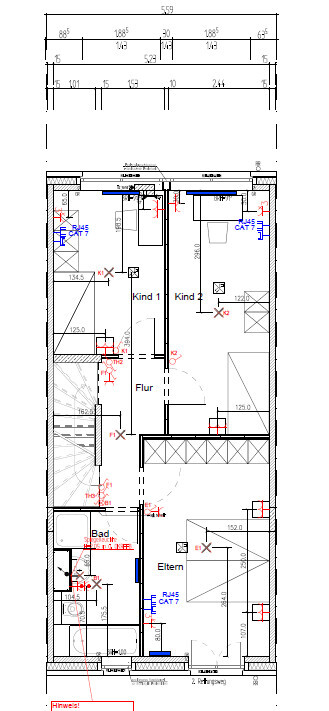

We have purchased a mid-terrace house from a developer and now need to finalize the floor plan for the room layout.
Right from the start: The layout of the house does not at all match our preferences, nor does the character of it being a mid-terrace house – but with current prices, this was the best we could afford... 😱 🙄 So please, no need to rub salt in the wound, we know there are houses with much better layouts.
Regarding the room planning, we believe there isn’t much that can be changed due to the elongated shape and the fixed window positions. Unfortunately, we don’t see many or any alternatives for the layout of the first floor, although the very narrow “corridor room” is a real problem for us. But maybe someone has an idea?
We have only considered partitioning part of the narrow room to create a storage closet, but that would be quite complex. Plus, vacuum cleaners and similar items could maybe just be stored in a closet inside one of the rooms?
As for the intended use of the rooms: initially, the rooms will be used as planned — two children’s bedrooms and the large room as the master bedroom. In a few years, we plan to move upstairs into the studio; the children will get the two bigger rooms, and the small room will become a study and guest room (where the vacuum cleaner, etc., could then be stored conveniently).
We appreciate any constructive suggestions and hope we haven’t forgotten anything (this is our first post in the forum).

Do you need the two children's rooms on this floor?
We are also building a mid-terrace house. For us, at the bottom of the plan, across from the stairs, there is the master bedroom; to the right of the stairs is the bathroom; above that, a child's room (across), and between the bathroom and child's room, a small storage closet. Then there are two large rooms in the attic. Other families here use those as children's bedrooms.

JuliaAlex4 Jul 2021 14:04@minimini : Yes, that is our plan because as long as both kids are still young, we will probably have a shared bedroom for both of them and a shared playroom. The attic is initially intended to be a large studio, which will serve as both the parents' living room and the home office area. When the children are older and we move upstairs, we will likely add walls to create two separate rooms in the attic.

Questions: how long is the long room?
Will the attic be fully finished from the start? Could it offer not only bedrooms but also a home office? Will there be a bathroom too?
Maybe consider whether the two children’s rooms could be combined (are they the same gender?) If they are close in age, the kids can probably share one large room initially?!
Alternatively, you could install a drywall partition, so you can later create two rooms from one and gain a storage room.
Or do whatever you think is best.
