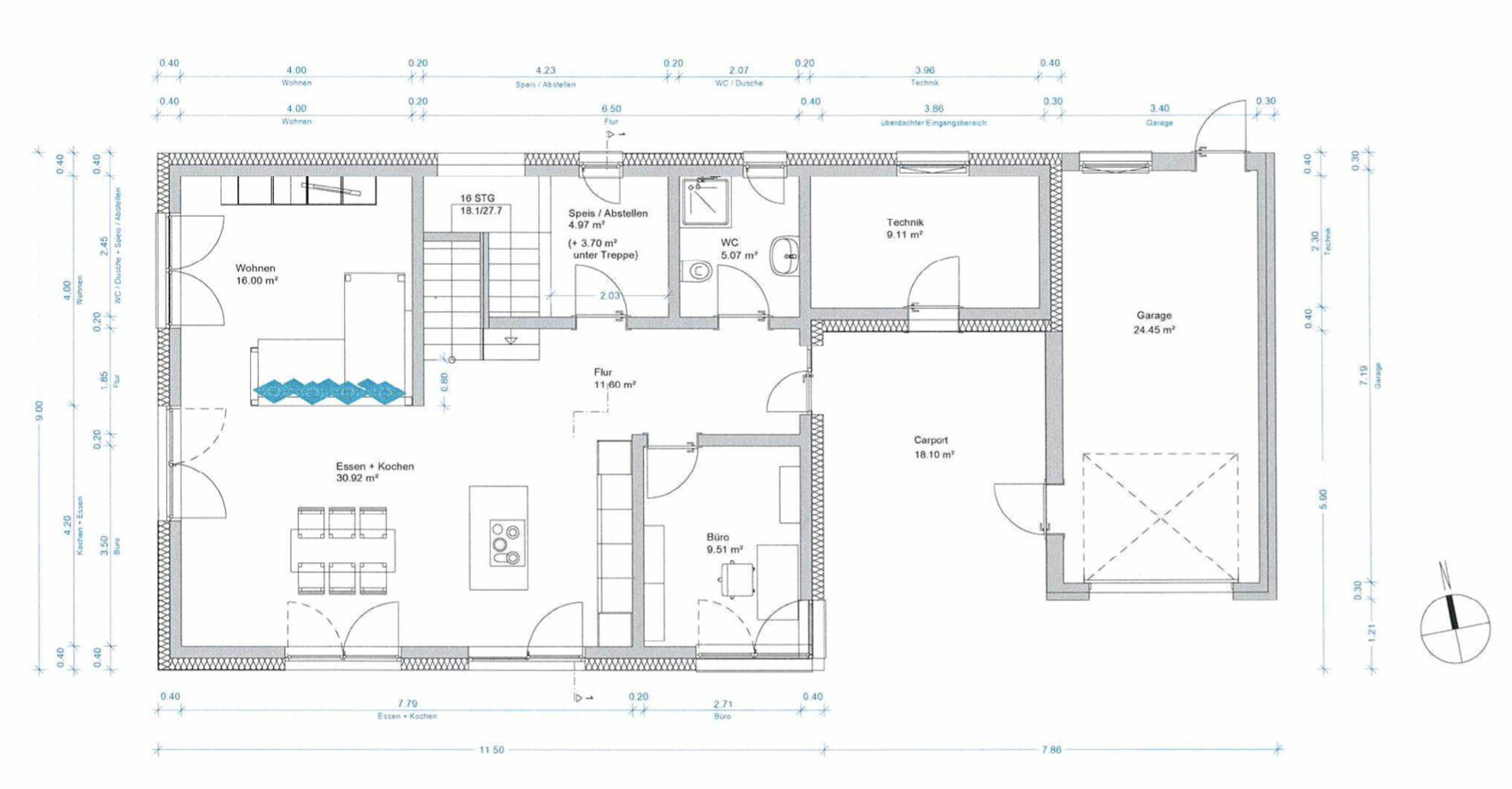

Ground Floor
Detailed 2D floor plan of a house with living room, kitchen, dining area, and garage

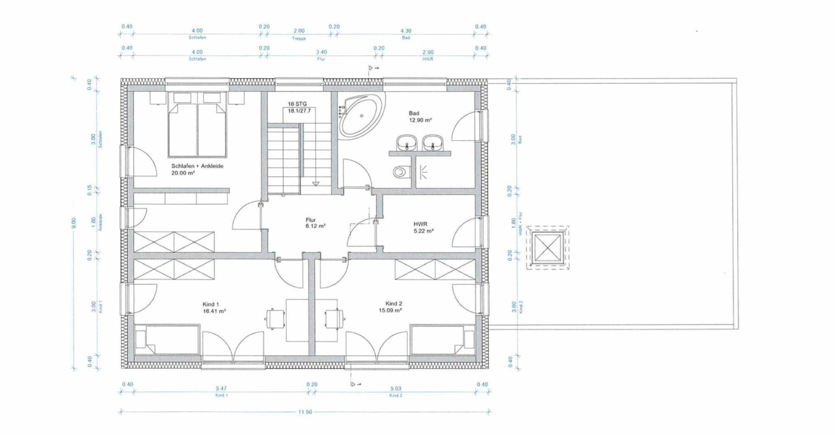

Upper Floor
Upper floor plan: bedrooms, bathroom, hallway, utility room, and two children’s rooms

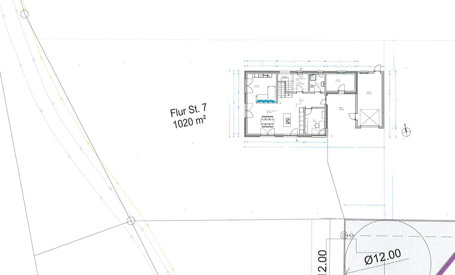

Site plan on the plot. The property is located at the end of a cul-de-sac next to the forest (forest to the west).

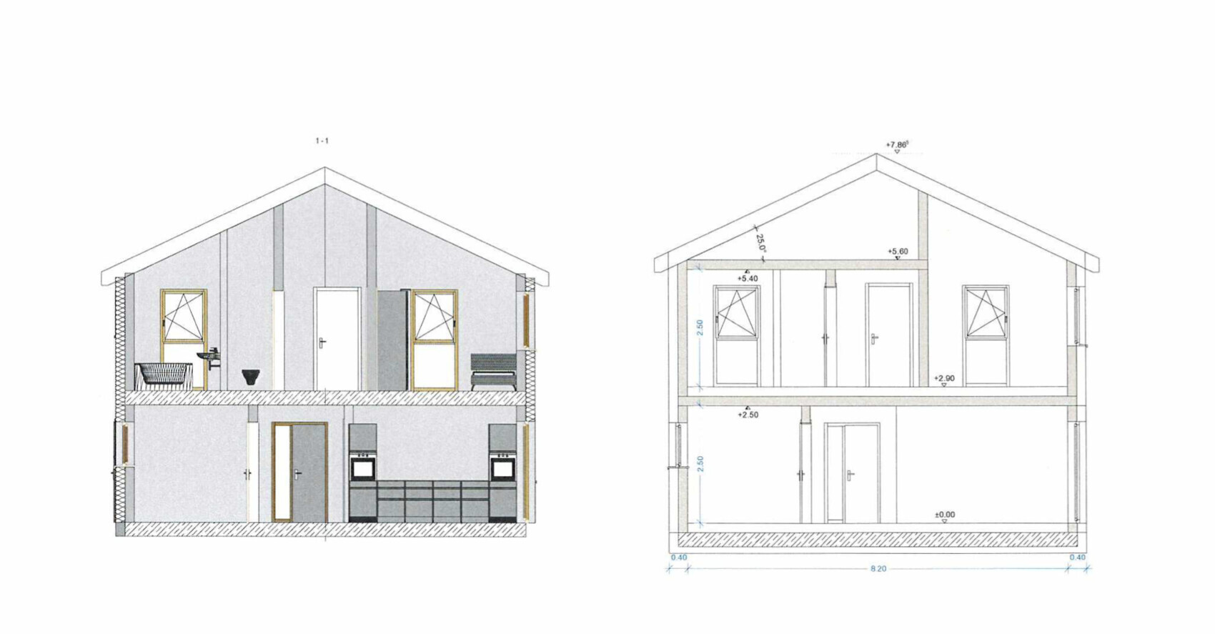

Section
Two-story house section showing interior spaces, doors, windows, and dimensions.

5 Sep 2022 11:55
Likee68 schrieb:
Slope: Gentle slope, 1 meter over 25 meters (3.3 feet over 82 feet)
Where exactly is the slope located?

Personally, I would prefer to access the technical room from inside the house.
What is the blue item? Cushions?
Windows above the bed would personally bother me.

I can’t align the ground floor and upper floor plans regarding the garage and this X (probably a skylight?) yet. Am I the only one with this issue?
If the area on the ground floor at the bottom right is a corner window, leave it out—it only adds cost.
I would plan the garage door to be at the same level as the entrance door; this makes parking in the carport easier and reduces the risk of scratches.

Where is the slope located?
The slope descends from the upper right corner to the lower left corner.
Personally, I would prefer to enter the technical room from inside the house.
I would prefer that too, but then we would need a door leading out from the restroom, and the utility connections run inward there... Moving the technical room again causes issues with the setback requirements from the property boundary.
What is the blue thing? Cushions?
Yes, it’s just a decorative item from the planner.
Why would that bother you? There are two full stories, so the windows would be quite high.

I can’t align the ground floor and first floor plans regarding the garage and that X (probably a skylight?). Am I the only one?
Well, except for the extension, the plans are the same size. The walls just don’t line up exactly. Hopefully, the structural engineer won’t have to adjust them...
SoL schrieb:
If that is corner glazing at the bottom right of the ground floor, leave it out; it just costs money.
Yes, kind of. Actually, for cost reasons, we want two windows next to each other, each with its own frame.
SoL schrieb:
I would plan the door to the garage at the same height as the main entrance door. It makes parking in the carport easier and reduces the risk of scratches.
Good tip!
Thanks for your suggestions so far!
Do you think there is enough space for a coat rack and shoe cabinets to the left behind the apartment entrance door (above the office)?
We will probably leave out the skylight on the carport due to cost (about 2000 euros). Do you think the entrance area under the carport will be too dark without it?

I would reduce the size of the office by 60 cm (or a bit more) and plan for a built-in wardrobe. Otherwise, I like the layout, although personally, I find the axis from the entrance through the hallway to the kitchen a bit too open. You have already considered a larger island. Otherwise, the workspace in the kitchen would be rather limited.
L
Likee68
5 Sep 2022 13:10
Myrna_Loy schrieb:
I would reduce the office by 60cm (or a bit more) and plan to include a built-in wardrobe.
Good idea, I do expect some clutter without a built-in wardrobe. Although then the office might become a bit small at around 8.5–9sqm (91–97 sq ft)...
Myrna_Loy schrieb:
Otherwise, I like the design, even though personally I would find the alignment of entrance hallway and kitchen too open. You’ve already considered a larger island. Otherwise, the workspace in the kitchen might be quite limited.
Thanks!
In the first version, the right wall of the living room was 80cm (31 inches) longer to create a more defined separate area. But we shortened it because otherwise, the distance to the kitchen island would have been too small.
I’m not yet sure if the open area will bother me. Nowadays, most layouts are that open anyway.
