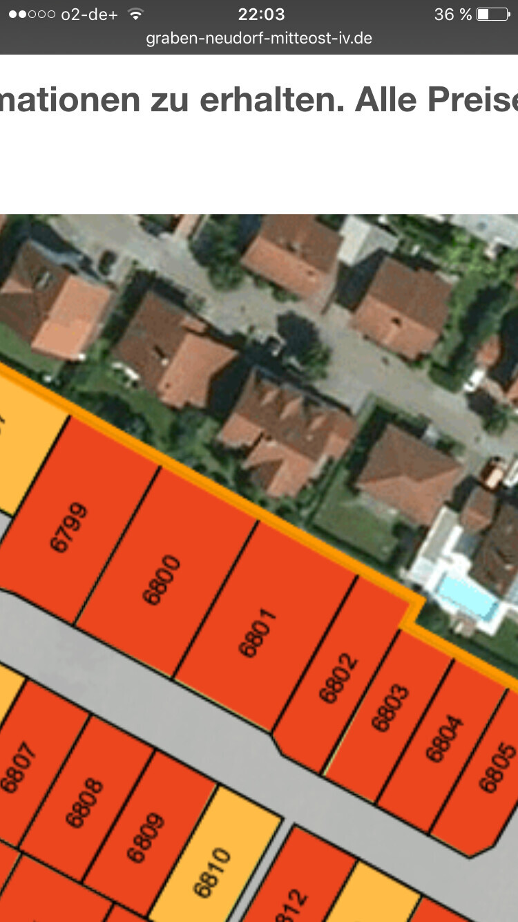

Construction is still planned on both the right and left boundaries; currently, there is nothing built there.
Opposite us is a four-unit building with six balconies. That’s why we definitely wanted a recessed terrace to create a bit of coziness :-)
