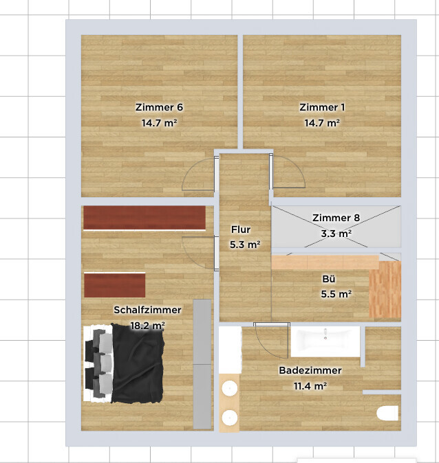

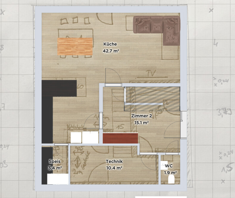

Milka0105 schrieb:
Either I am making a mistakeYou don’t simply enlarge the design; instead, you adjust it according to the specified staircase (or the dimensions that seem to be fixed in concrete already in your case). For example, quickly and roughly (without a pantry, you would have more kitchen cabinets, which you can do but don’t have to):
By staircase, you probably mean a two-flight straight staircase with a winders instead of a landing (?), Exactly. Winders, because a landing staircase requires more space. (I find landing staircases more attractive, but well, space is an issue here.) Regarding the floor plans in post 86:
I do think the idea of integrating the staircase between the rooms is pretty cool. I can’t quite picture the full effect yet.
One possible improvement I see is the placement of windows on the ground floor, especially on the plan’s right side. There are none, which makes quite a strong statement.
To me, the window areas seem very unevenly distributed anyway (for example, upstairs there are many windows on the right side but only one on the left).
I know there was a north arrow at some point – but I have successfully pushed that out of my mind and thus no longer have the cardinal directions in mind.
Papierturm schrieb:
Exactly. Switchback stairs, because a landing stair requires more length. (I find landing stairs more attractive, but well. Space requirements are an issue here.) I perceive landings as interruptions of the walking rhythm and only split or bend stairs so they do not impose dominance or disturbance on the floor plan. Landings often create bays (at their own or the opposite end, when the sum of the stair axis and the landing axis along their extension dominate or even exceed the building depth). Sorry that this is not German as a Foreign Language (DaF) again, but switching takes me considerably more time.
Papierturm schrieb:
I know there was once a north arrow – but I successfully forgot it and therefore no longer keep the cardinal directions in mind. I consider the old practice timeless, to override the assumed default north with a clearly visible north arrow "at the top of the plan."
